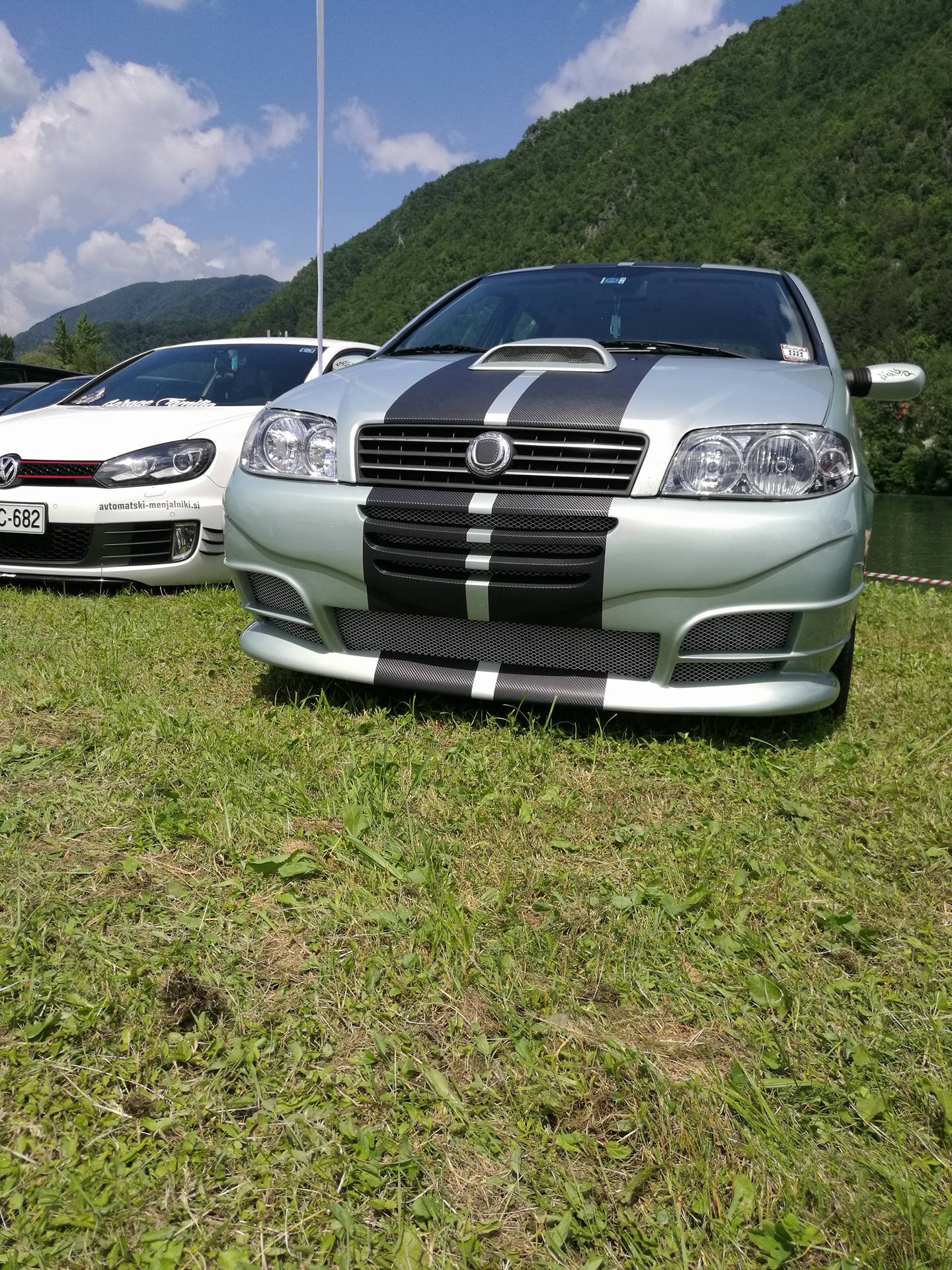

Well its not a stock bumper so yeah. The licence plate is mounted on the white mesh. So the licence plate completly covers the lower portion of the radiator and the bumper covers the top one. So it gets no airflow exept from the fan but i doubt thats enough for long trips. Last year i had it mounted differantly and never overheated even a bit. Coolqnt lvls are all fine. Drained 2 months ago. Im hoping the licence plate is making the problem. But i just wanted to know how dengerous it is to drive at that temperature

Thanks. Nah it gets enough air in if i relocate the licalence plate. But all off topic. Car runs fine without the licence plate so thats not the problem. Just wanted to know if driving at just abit higher temperatures as normal for short periods would be dengerous

ziggy- yeah its overflow problem and i know how to fix (licance plate).i doubt its the other reasons, but i will travel without the licance plate next time to confirm this, if i still get above the normal maxing point than i have a problem. also its summer so heat on max wont work for me, ill move the licance plate, if that wont help, i rather use AC and drive 100km/h and have normal temps than 130km and heater on max haha :D
Bill- i will but its still in the process of that, at the moment i have it there because i can easly remove it in 1minute when on carshows, and no i wont do the alfa version as i find that totally retarded and it ruins the look of a car.
