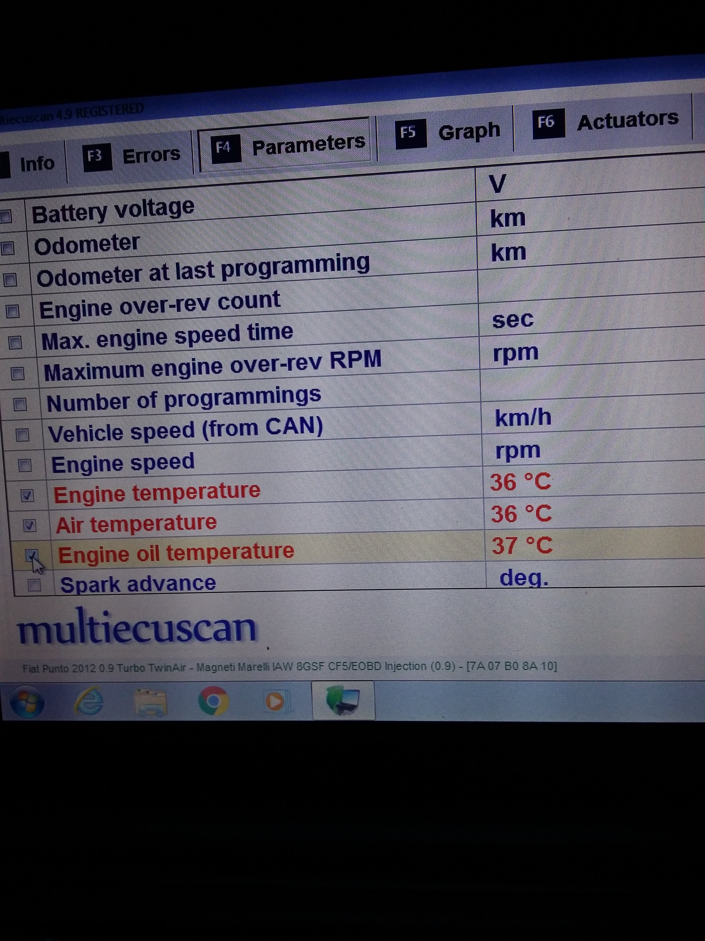

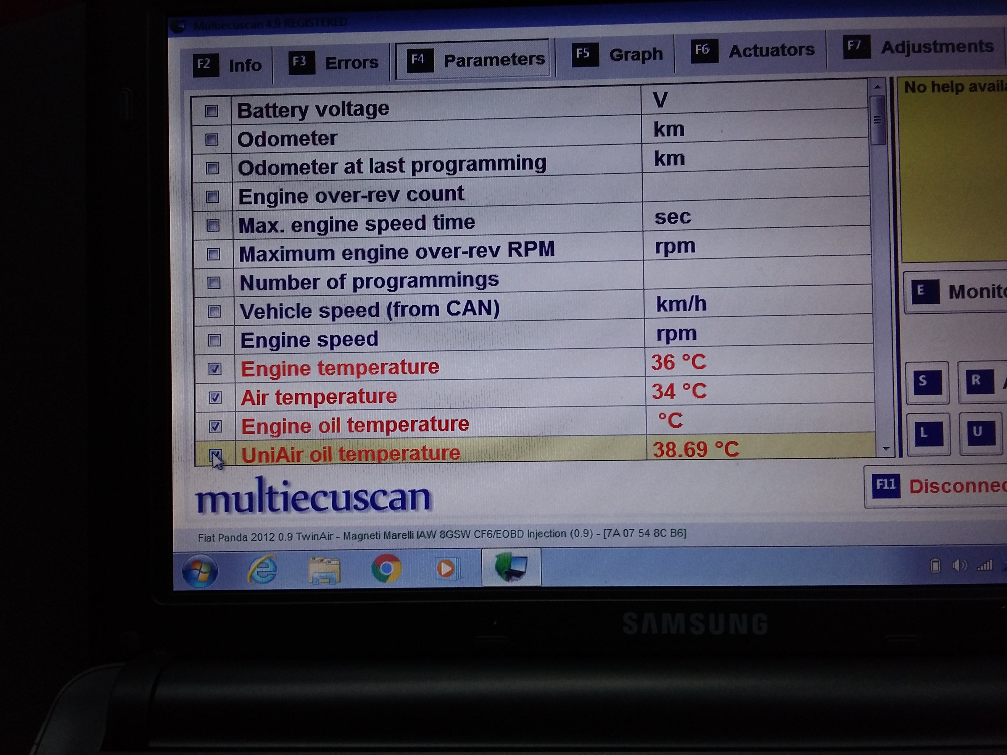

Nobody will be shocked to read that there were NO ERRORS STORED..
Here are a couple of the relevant pics though
As you can see outside air 20 everything under the bonnet @35
Been parked for 3 hours after the commute.. so all 'normal' to me

The symptoms you describe do, however chime with me (no pun intended) but with a VW Golf 4 which would run lumpy after a short run and have a very stinky exhaust (running rich). I resolved the issue by changing out one of the coolant sensors (the Golf appears to have a couple one of which just feeds the ECU). My analysis of what was going on was that the ECU was getting a dodgy temperature signal at low(er) coolant temperatures and was fuelling for a cold start. Maybe something similar is going on? Can you look at fuel trims (live data) with multiecuscan? Perhaps this would give some insight?

Surely if the air temp and the engine temp are so similar the thermostat has gone? I would change that and the temp sensor to start with.
Its all in one warm box.. (engine stopped for 3 hours) :)

Mes allows you to graph many sensor outputs while you drive or just run the engine. It does help build a better picture of what is going on. You can monitor engine temperature so while I have not tried I think you could watch warm up and thermostat and fan operation and effectiveness..
