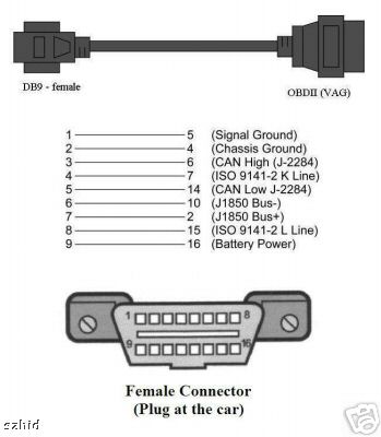

where is the PIN 3 in a stilo dynamic 5dr 2002 plate, I have a EOBD device like this one:
http://cgi.ebay.co.uk/U480-CAN-BUS-...ryZ30921QQssPageNameZWDVWQQrdZ1QQcmdZViewItem
Airbag diagnostics are available at pin 3 on the eobd connector. If you have something connected to pin 3 on your diagnostics gear connector then you may be able to read off any fault codes there
