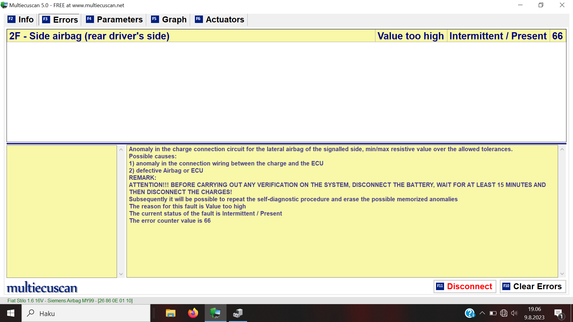

The air bag light has turned on in my Stilo, here's a screenshot of the error code:
Which airbag is this? I couldn't find a conclusive answer. I checked the connecor below the driver's seat, but it was OK.
I need to get this fixed before the end of the month, annual inspection coming..
I have an '03 1.6 hatchback, a guy in the next town over is selling an '05 1.4. for parts, I could get seats from him if need be.
Turned out to be the connector under the rear seat, the orange connector on the drivers side just next to the levers to move the seat.
Just sprayed it with a liter of contact cleaner and wiggled it a bit, then the fault went from "present" to "intermittent", and I was able to clear it👍
