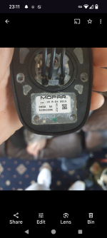

Hi, I had to replace my aerial as I had no dab working. Not too bad to do just don't rush it. It is not worth buying a second hand one, I did this first and it also was broken as it seems to be a generic fault.

This is what the base looks like when off the car. Might help when browsing part details

I recommend getting a tube of silicone grapes and covering ever joint under the aerial base with it to prevent water ingress
My current one has worked for 5 years now without issues
