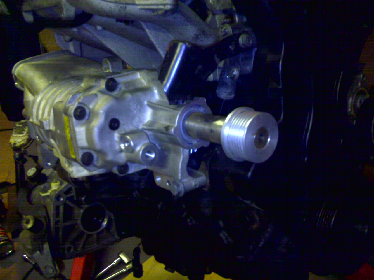

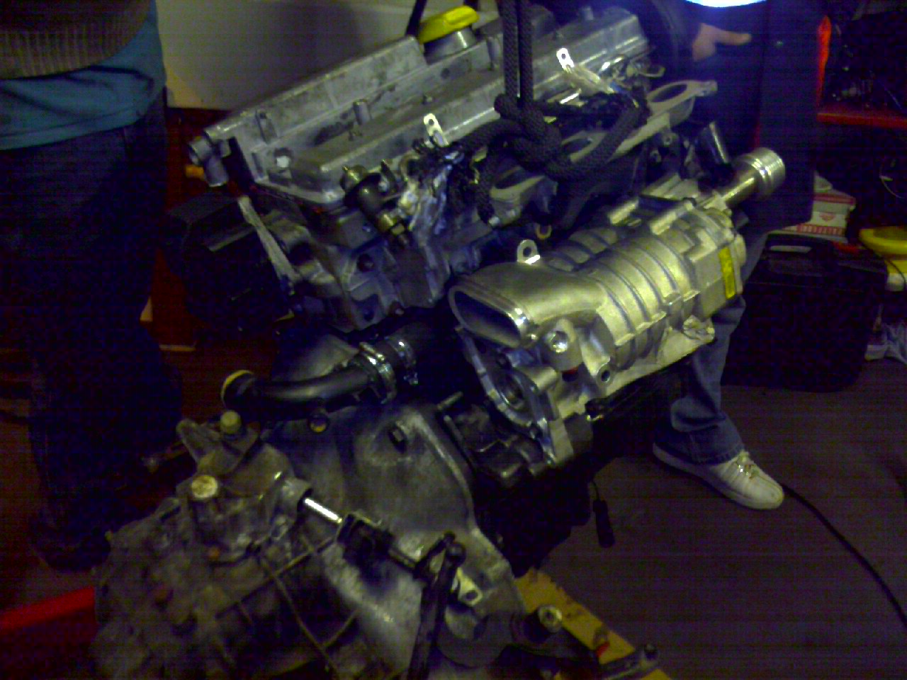

going to be fitting these at weekend, and on sunday fit and wire a motec ECU system to a supercharged Corsa 1.6

got any links or pics for this one? my bro wants to replace his 1.4 16v lump soon and he wants a 2.0 16v but im not too convinced on them and this conversion your on about im assuming uses an original gsi lump?

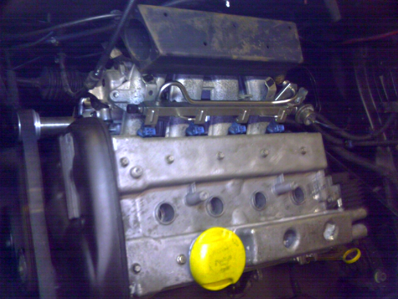

nope its not a gsi lump think he said it was one from a vectra or summin had to have custom mounts made to fit and its using a BMW mini supercharger, my mates just put a calibra engine into his corsa, using GSI driveshafts and 16v 2litre redtop and got the mounts of ebay, so far his projects only cost him £500 including the corsa and calibra and all bits needed lol cheap cheap
got a few pics will get more on sunday for you :)

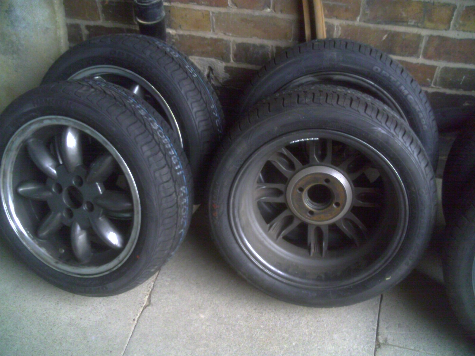

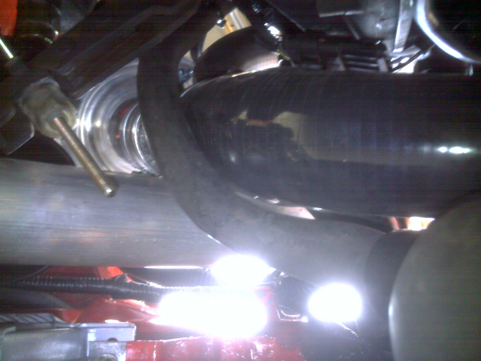

got some of my silicon pipeing today just for washer/overflow pipe ect... so managed to get the arch liner back in and wheels onto the car.
get paid on thursday so will get my silicon hoses ordered from PSH in leicester
as you can see also got my FCD wired in and just waiting now for money to buy the last few bits under the bonnet.

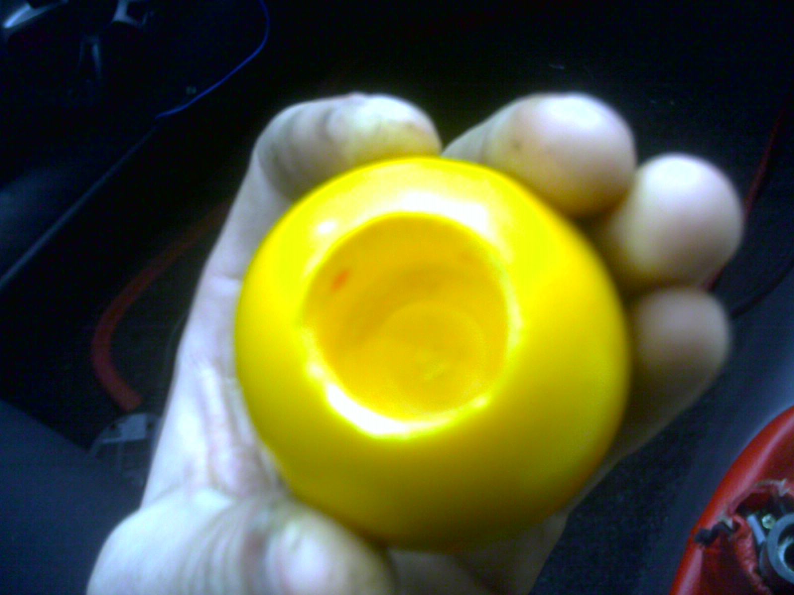

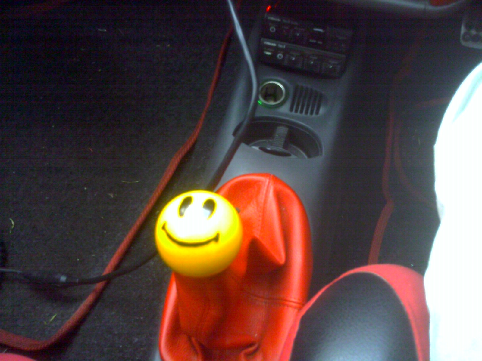

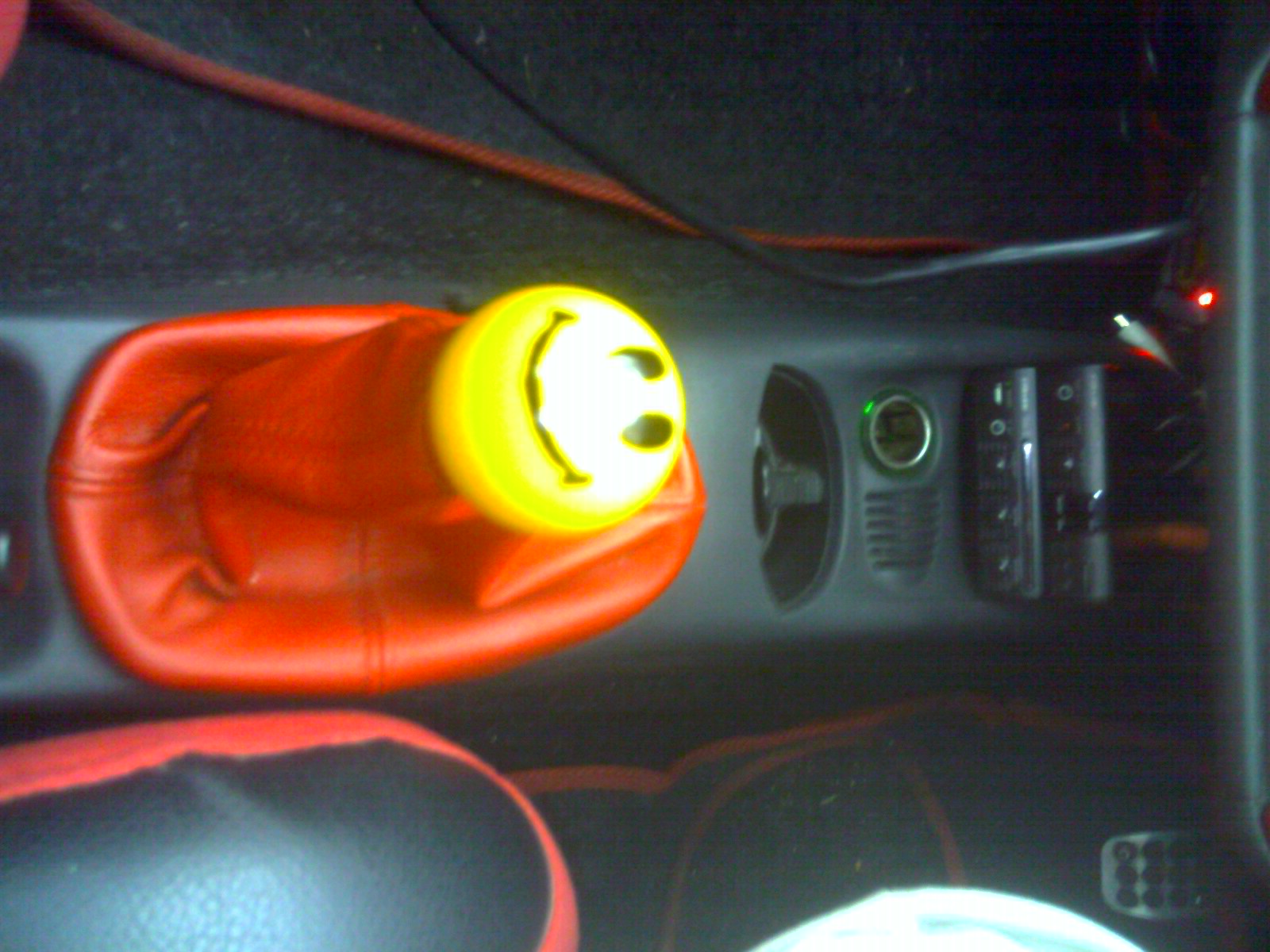

few pics, made my gearknob using a pool ball which i borrowed from a pub :p drilled it out 22mm and painted face on it and then varnished the ball to stop the paint comming off just got to give it few more coats :)

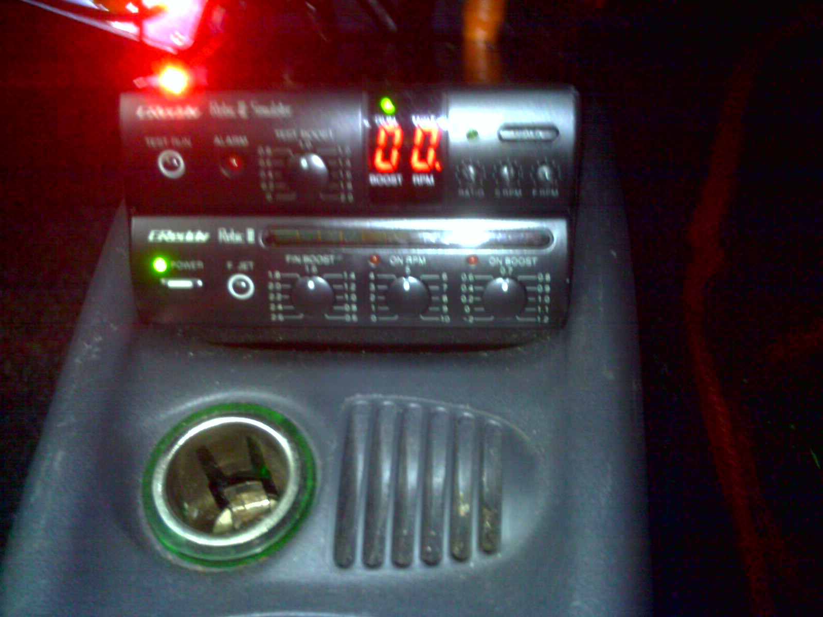

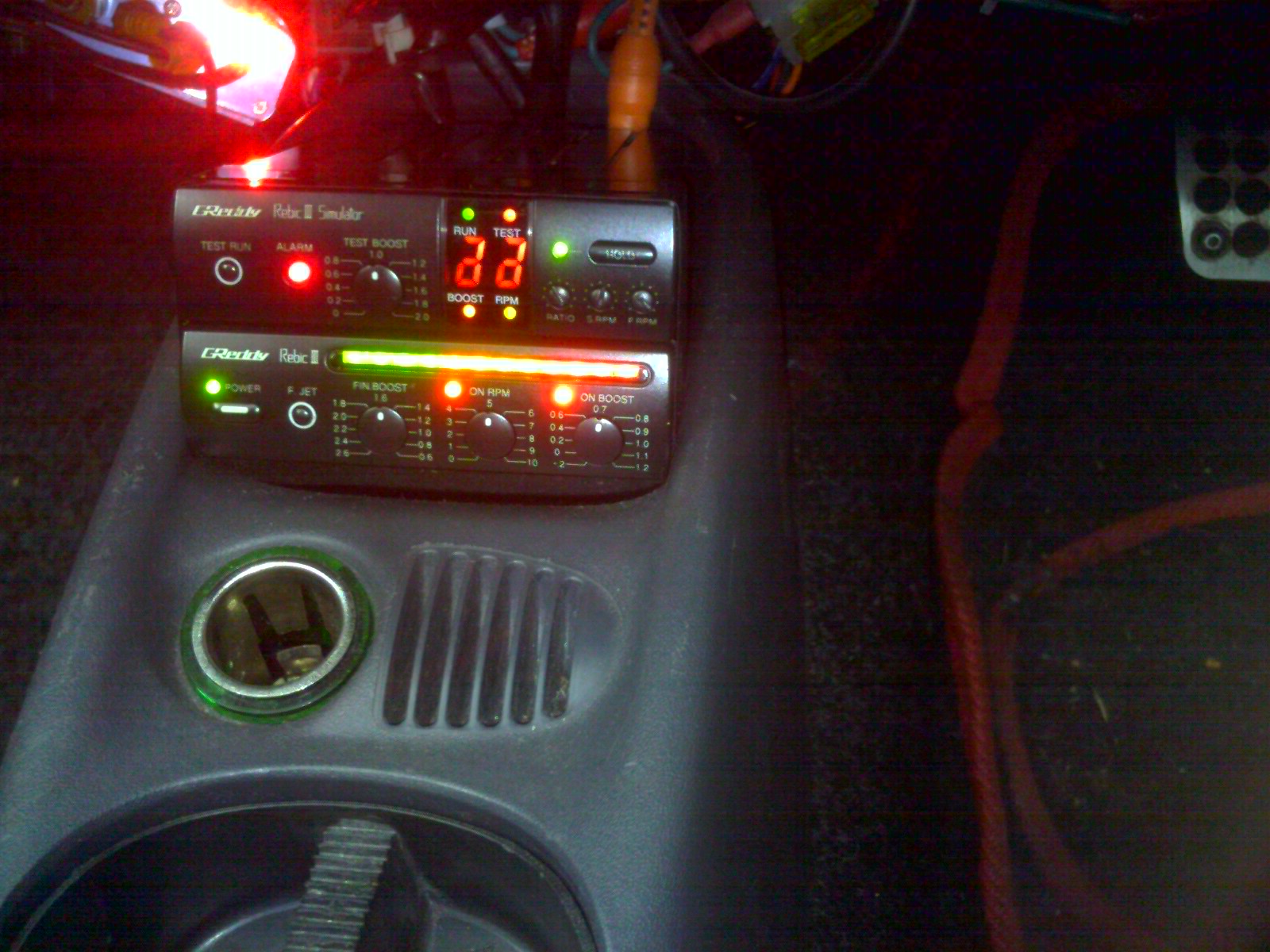

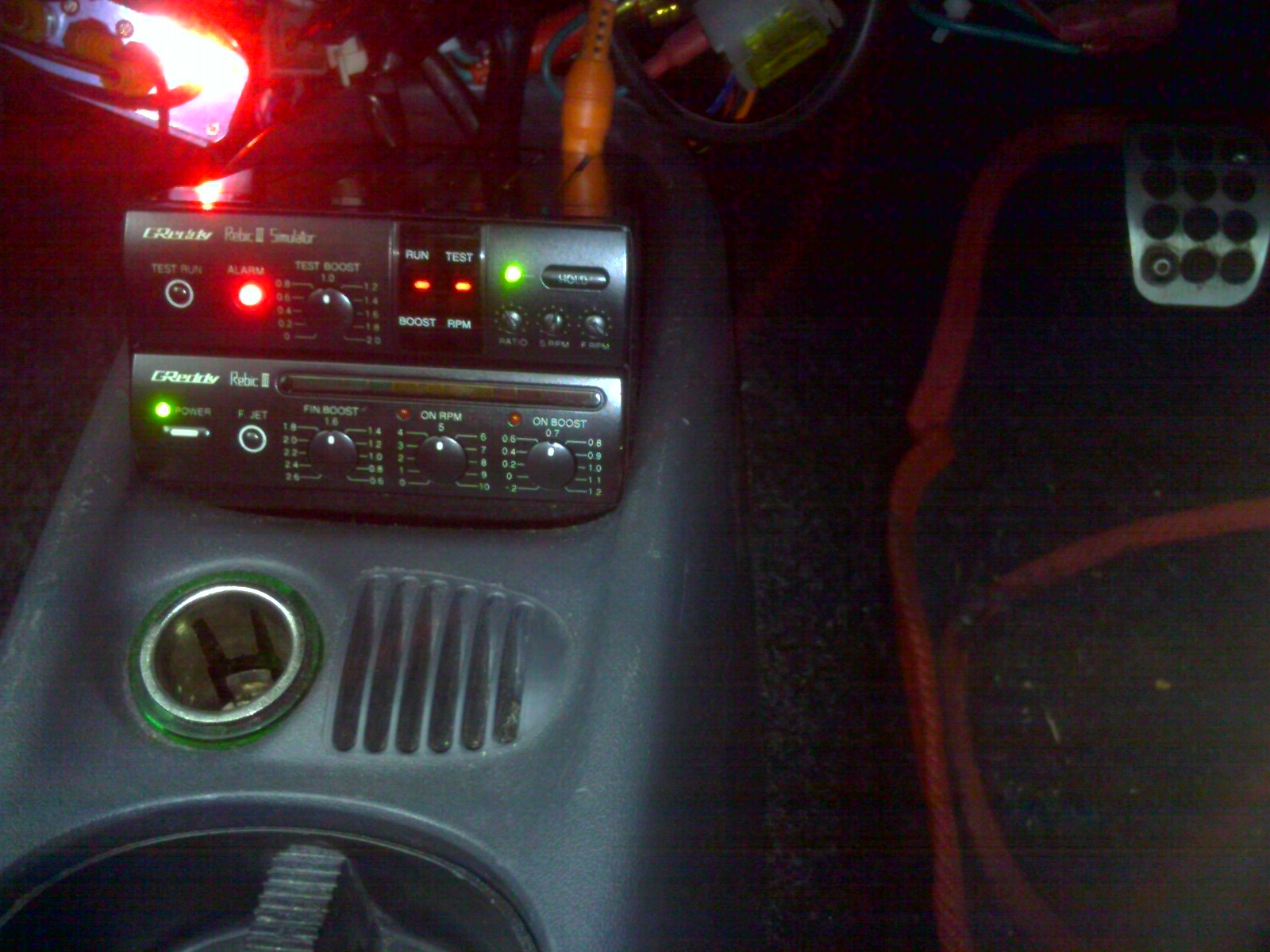

also here is my rebic 3 fuel injector controller mounted in the tray bit under the dash just fits in there perfectly not even fastened down just pushed in and holds :D

liking the gear knob :D
you obviously have a steady hand (y)
i always thought that a snooker ball was the right size, and it should get as cold in winter as a metal one

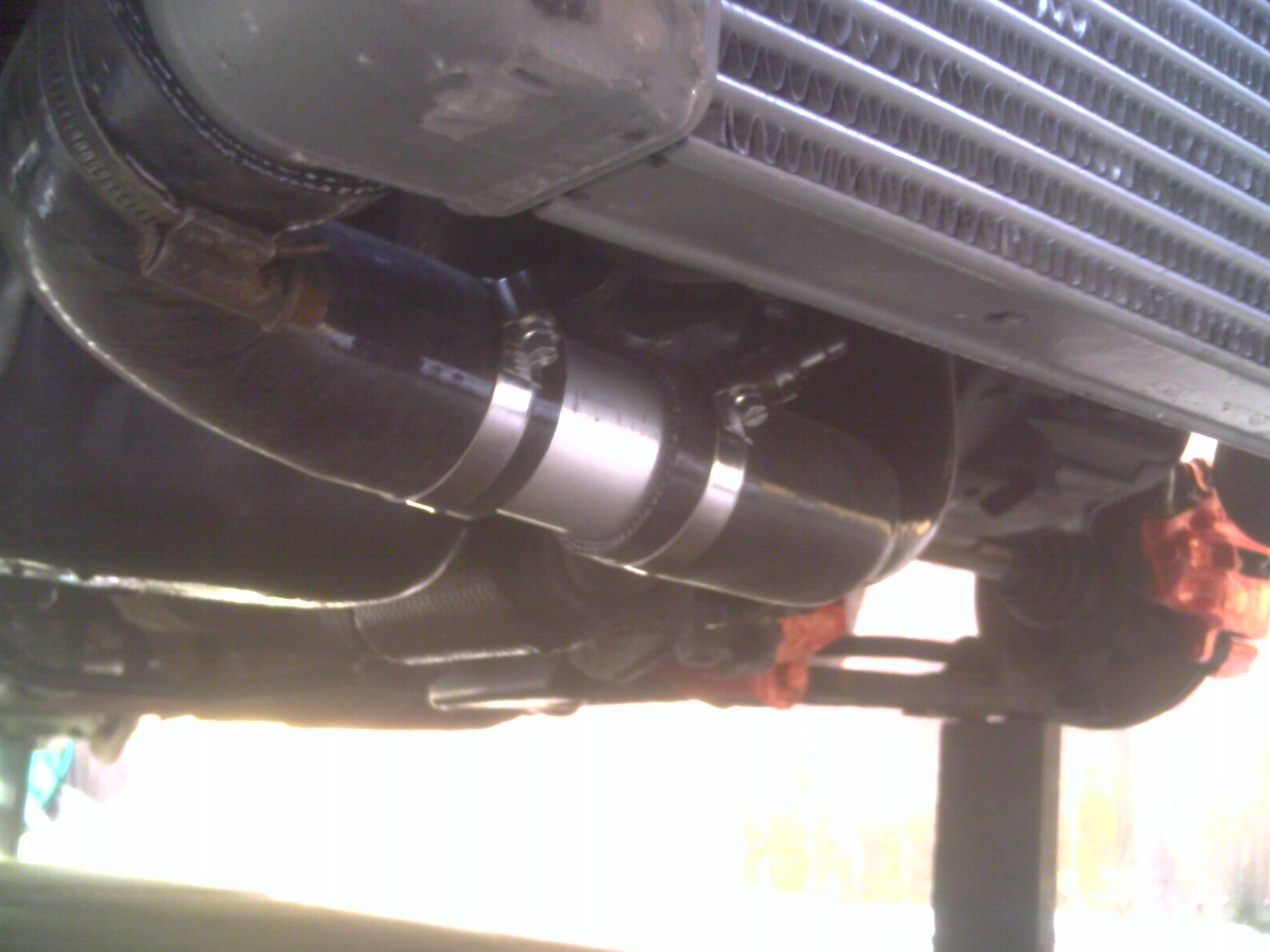

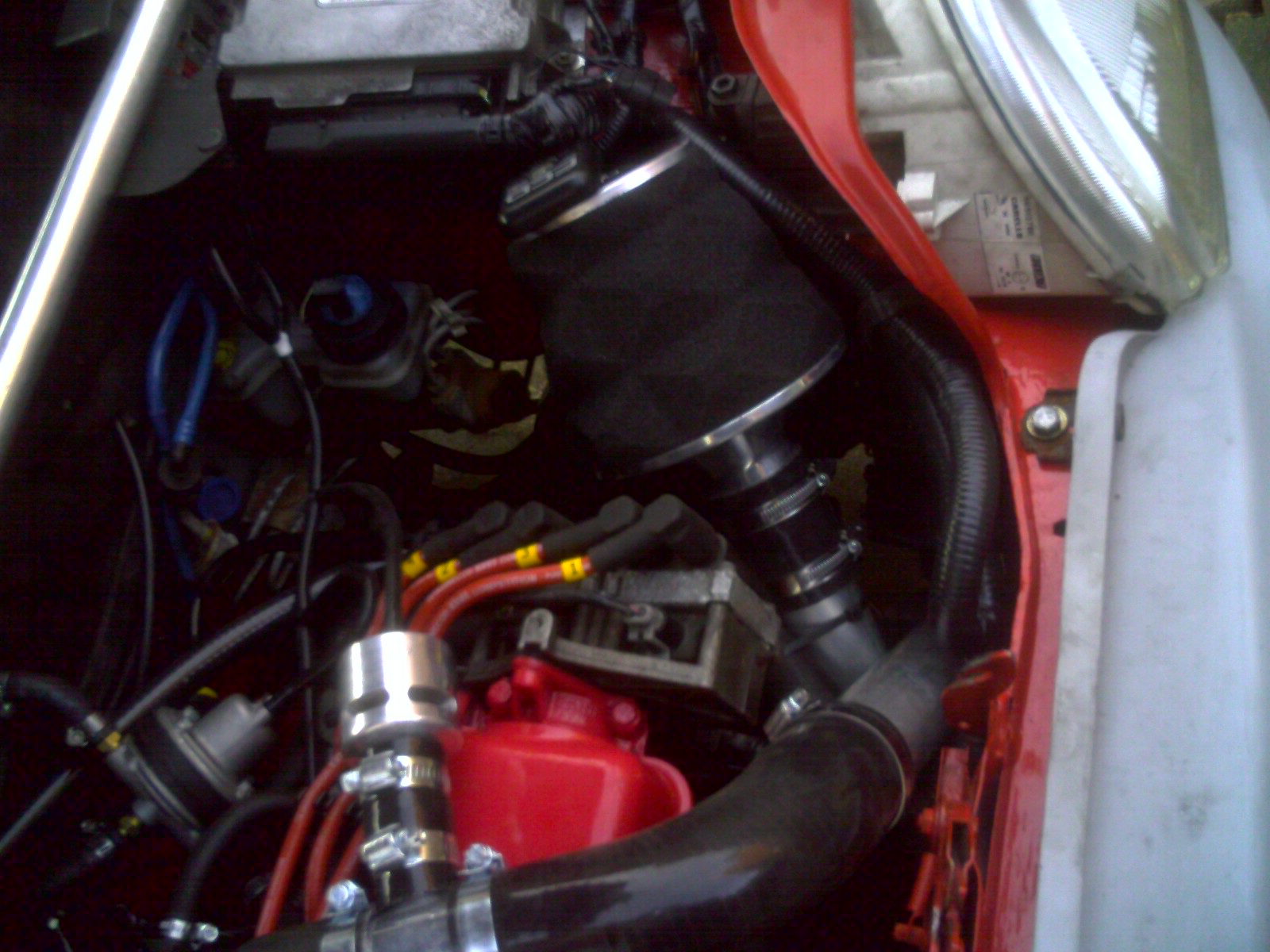

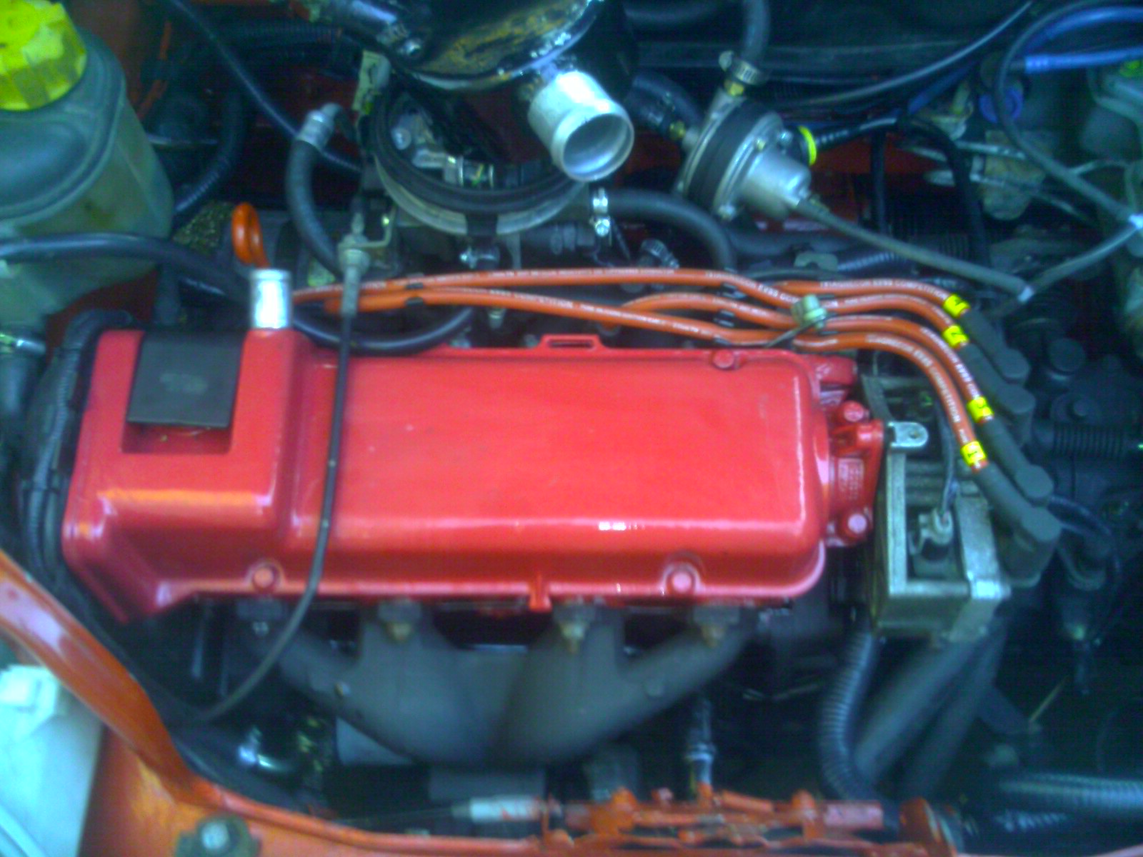

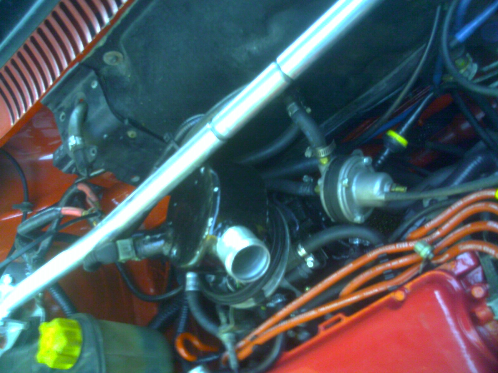

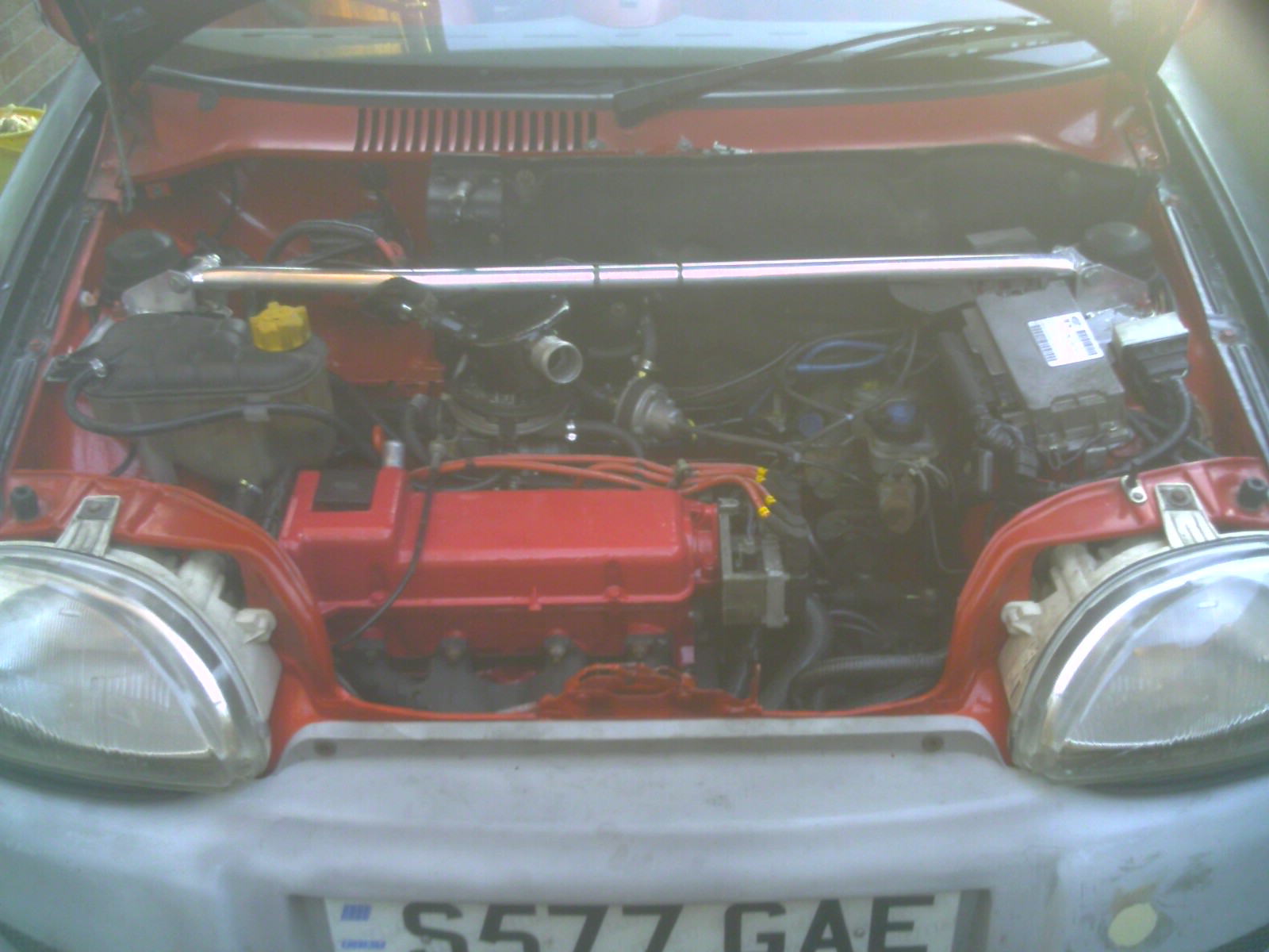

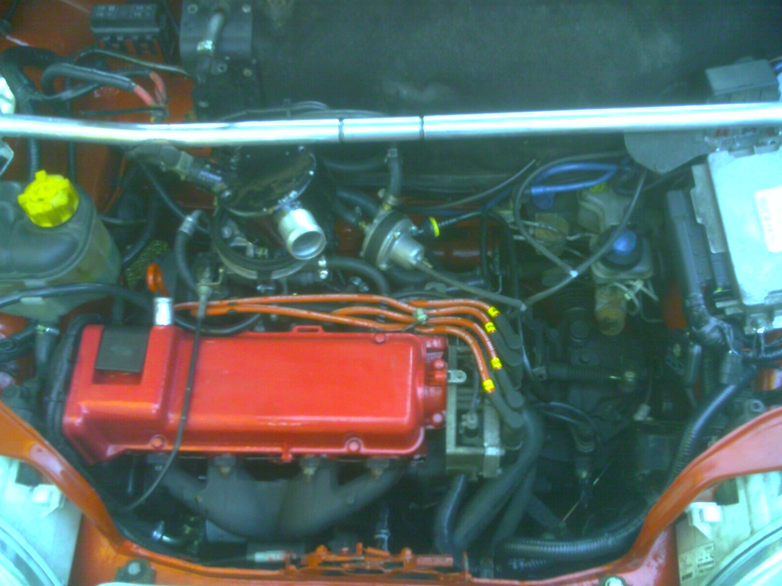

car now all back together new tyres on 175/50/r15 and all boost pipes/hoses are on (y)
just having problems with setting up the Rebic 3 fuel injector controller, car boost's and tish! fine in neutral bu when in 1st gear the car just stutters and doesnt really do much, 1st gear its fine but 2nd and 3rd ect... just **** didnt even get over 20mph as too much air and not enough fuel, cant find instructions for the Rebic 3 anywhere in english only in japanese :((n) thing just keep beeping at me and flashing its lights

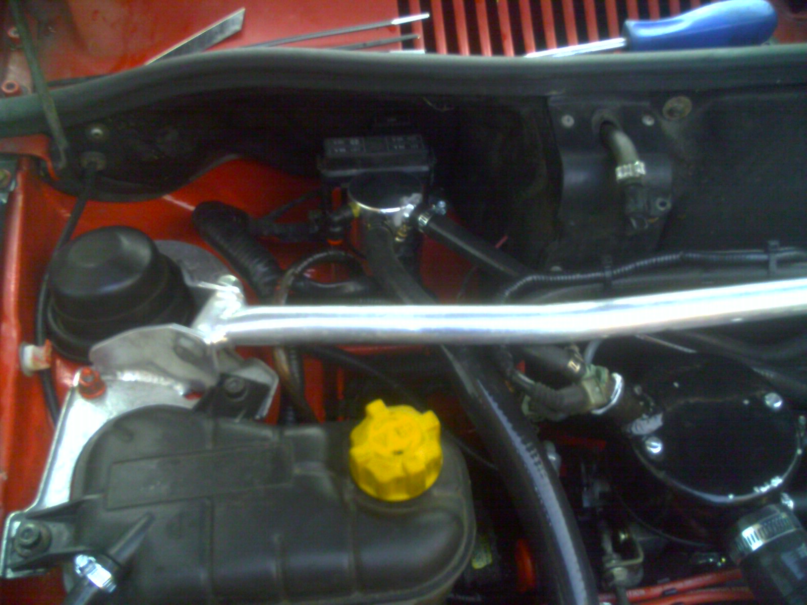

also fitted oil catch tank and have all silicon hoses now put onto the car except water hoses, big thanks for Phil at PSH for making the hoses for me :)(y) had 13 hoses made for £180 :)
also need to mod my bonnet as it cant close as the boost pipes are in the way :((n)

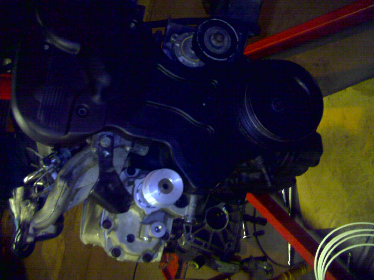

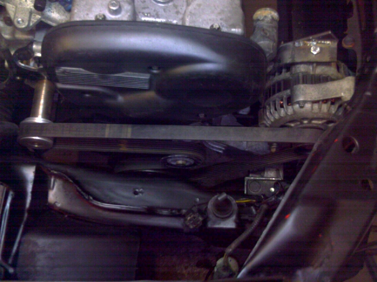

i am loving the engine coversion !!! .
A few questions, was this engine change a bolt to bolt swap but with different engine mount ? WAs clearance a big issue ?.
As for the rear break conversion, do u need to replace the whole trail arm and the hub to have the uno brakes??
and can't wait till you finish, remeber to get some pics up of the car + engine bay :)
read the FAQ's and sticky posts in the cinq/sei section.
most of what you need to know is already on the forum!
i had to change all 3 engine mounts to standard sproting mounts also had to change the metal plate on the body on the engine side mount to the sportings plate then it was basically a straight fit.
wireing loom had to be cut/spliced into so that instrument lights would work on the instrument pannel ect....
rear uno brakes were straight bolt on had to use the unos rear hubs as seicento/cinquecento ones are offset by a few mm
