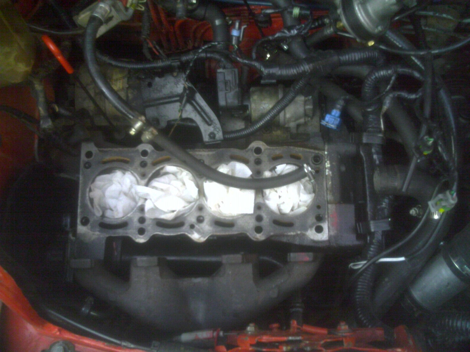

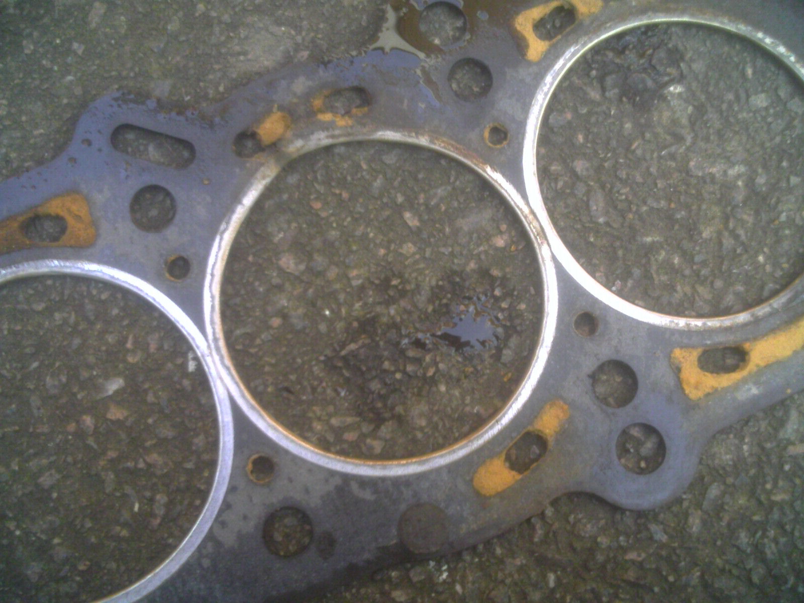

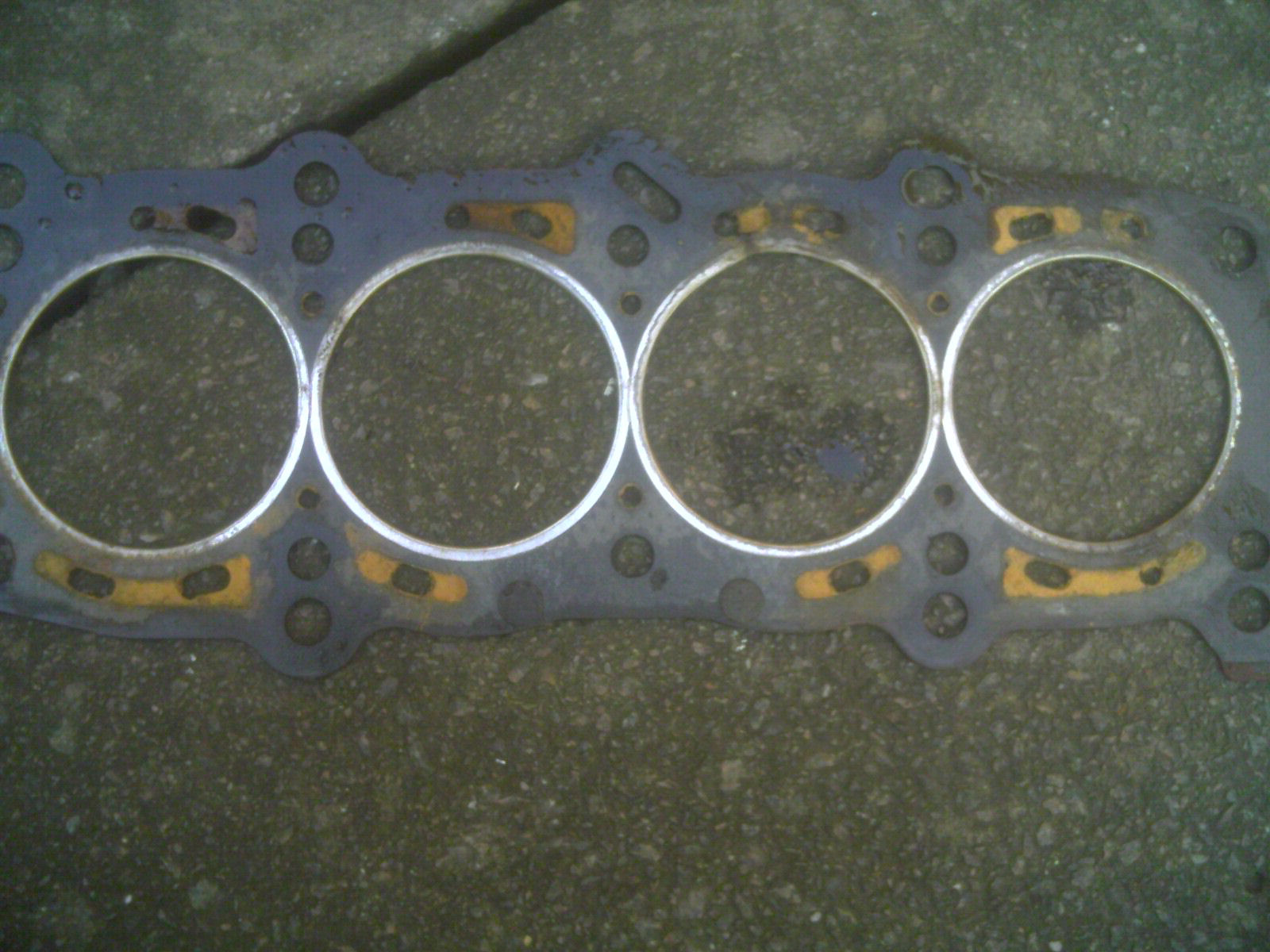

engine blows its gasket :(
thermostat got jammed and basically caused the engine to overheat, next thing cyliner 2 was full of water and couldn't turn the engine
so head off and inspect the engine....
heads getting skimmed tomorrow and hi-boost conversion will now be taking place a month earlier then expected.

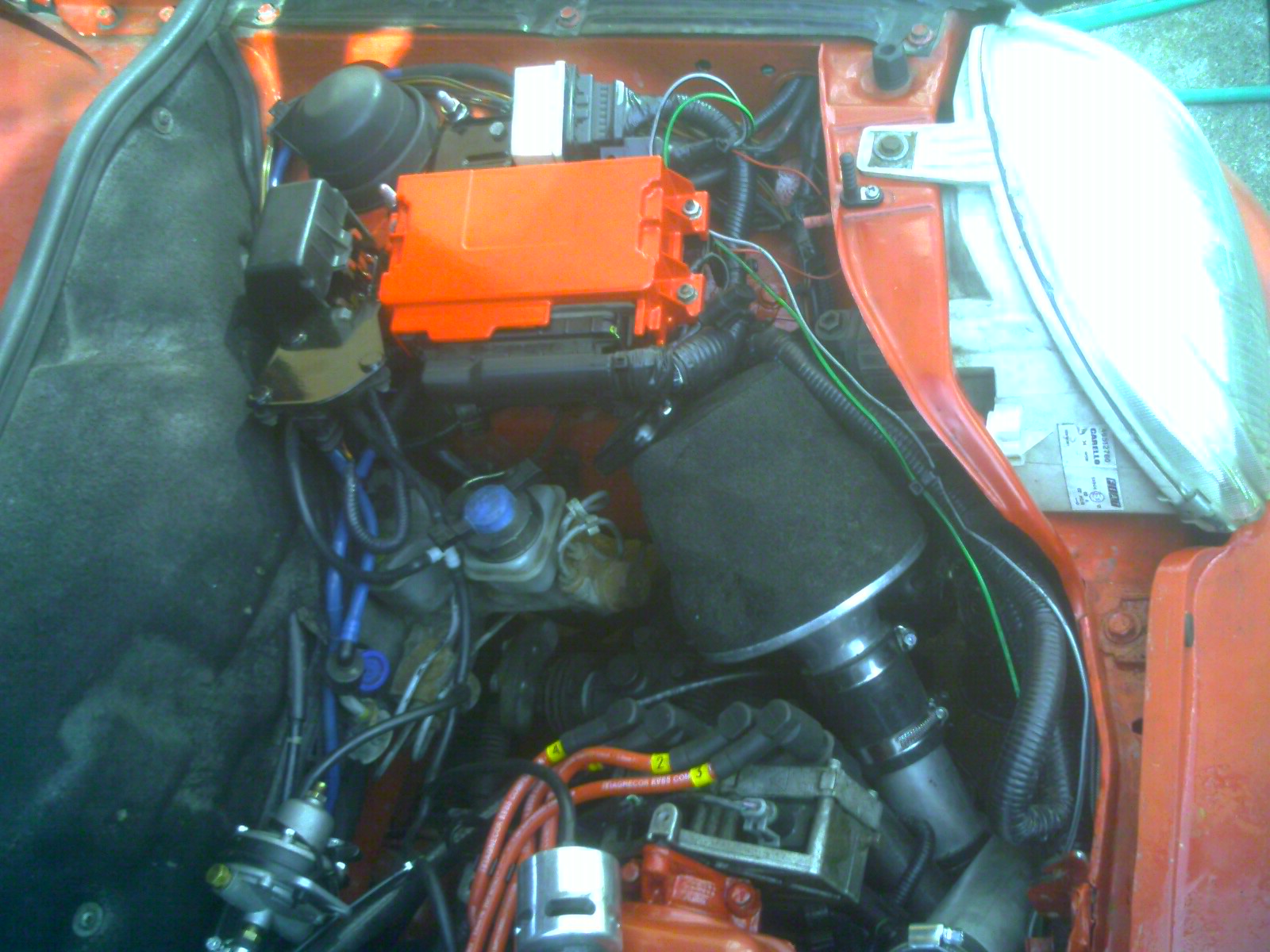

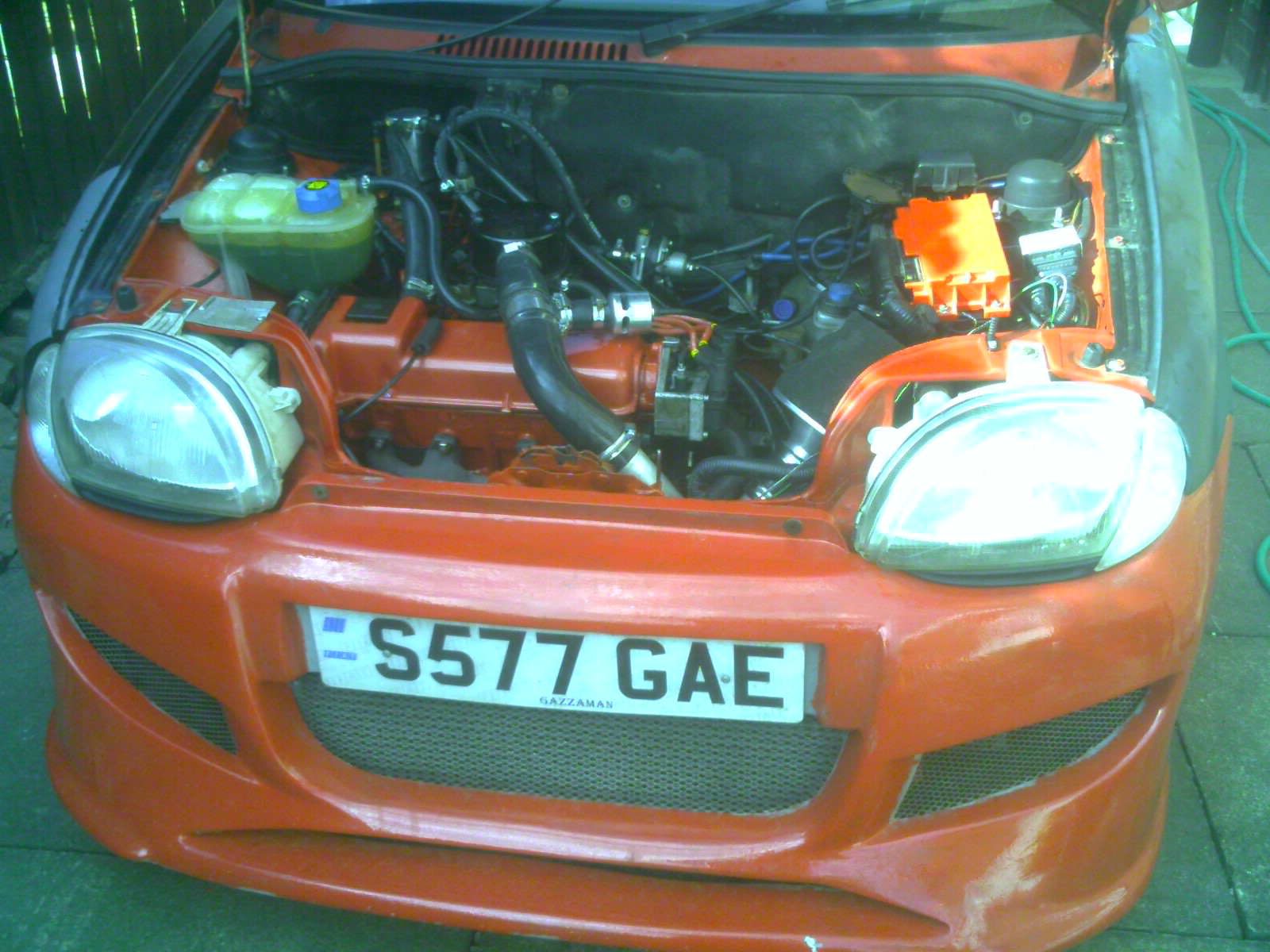

changed mind on lambo doors, well got my copper depcomp plate a few day ago all back up and running again.
MPI coolant tank fitted, thinking of Going MPi with it using a punto 75 head and injection rail ect... and being controlled via Megasquirt v2
