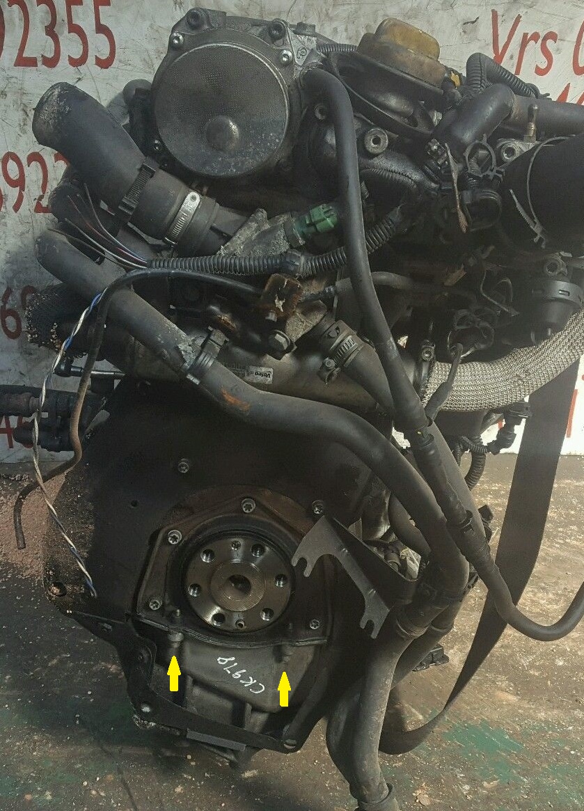

I've a 115 sump to change and I'm reading that there are 2 very inaccessible bolts that need 5inch long skinny ribe keys to go through some slot in the flywheel. (Sorry can't actually look under car as it's sat miles away awaiting me to rescue it).
Marty.
It's the two RIBE bolts that fix the sump to the rear engine oil seal carrier. As you say you'll need a long RIBE bit (I've never seen one long enough), or a ¼" drive extension bar, socket and bit.
