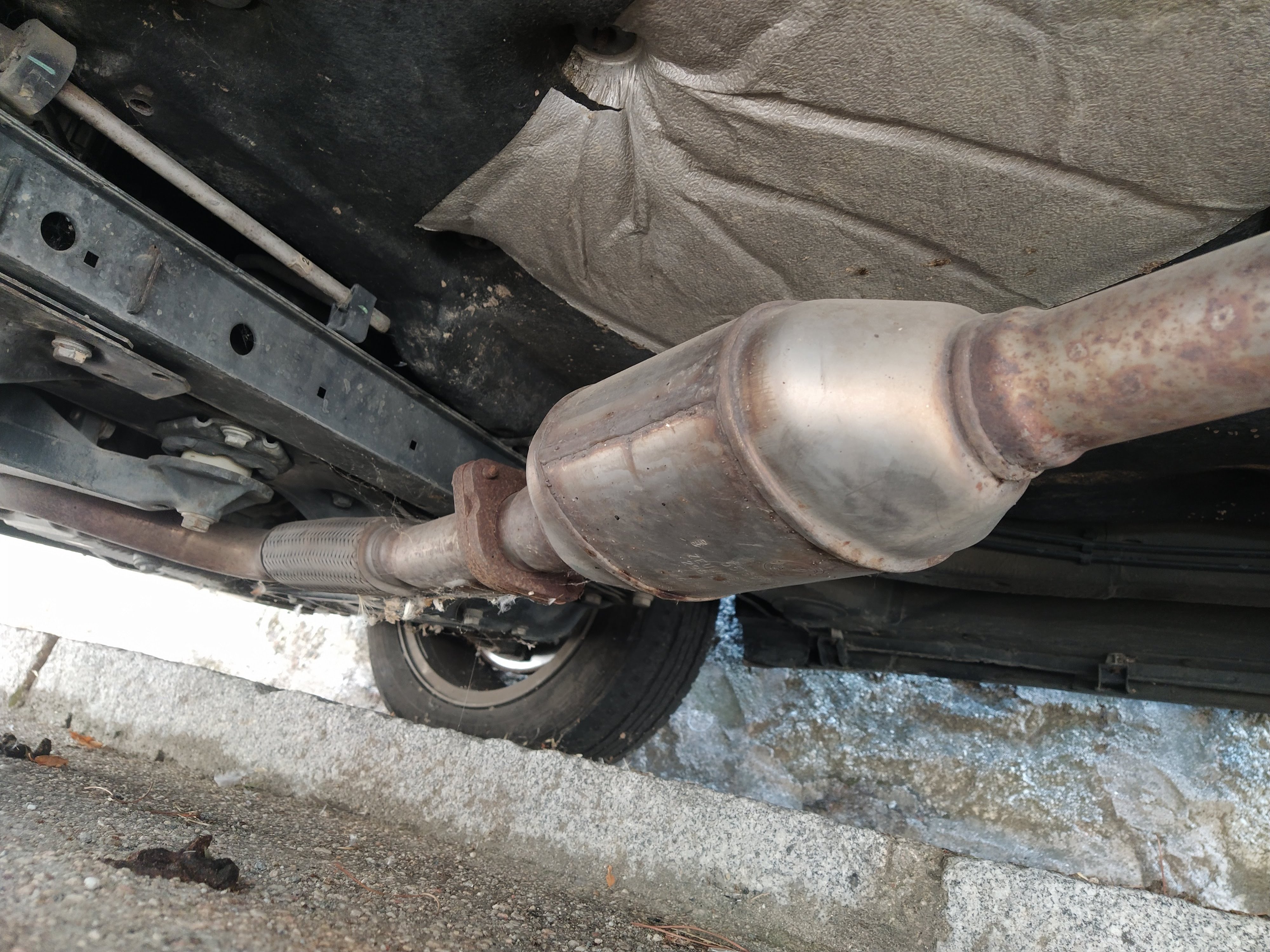

Hello, everyone. I have a Multipla 1.9 JTD 115, registered in February 2005, and I am trying to find out if it complies with Euro 4 standards.
I asked a mechanic friend who lives in another city, and he checked with FIAT using my car's license plate number. They replied that they are not sure if it complies with the Euro 4 standard; they are undecided. It could be yes or no.
My friend asked me if the car has a particulate filter.

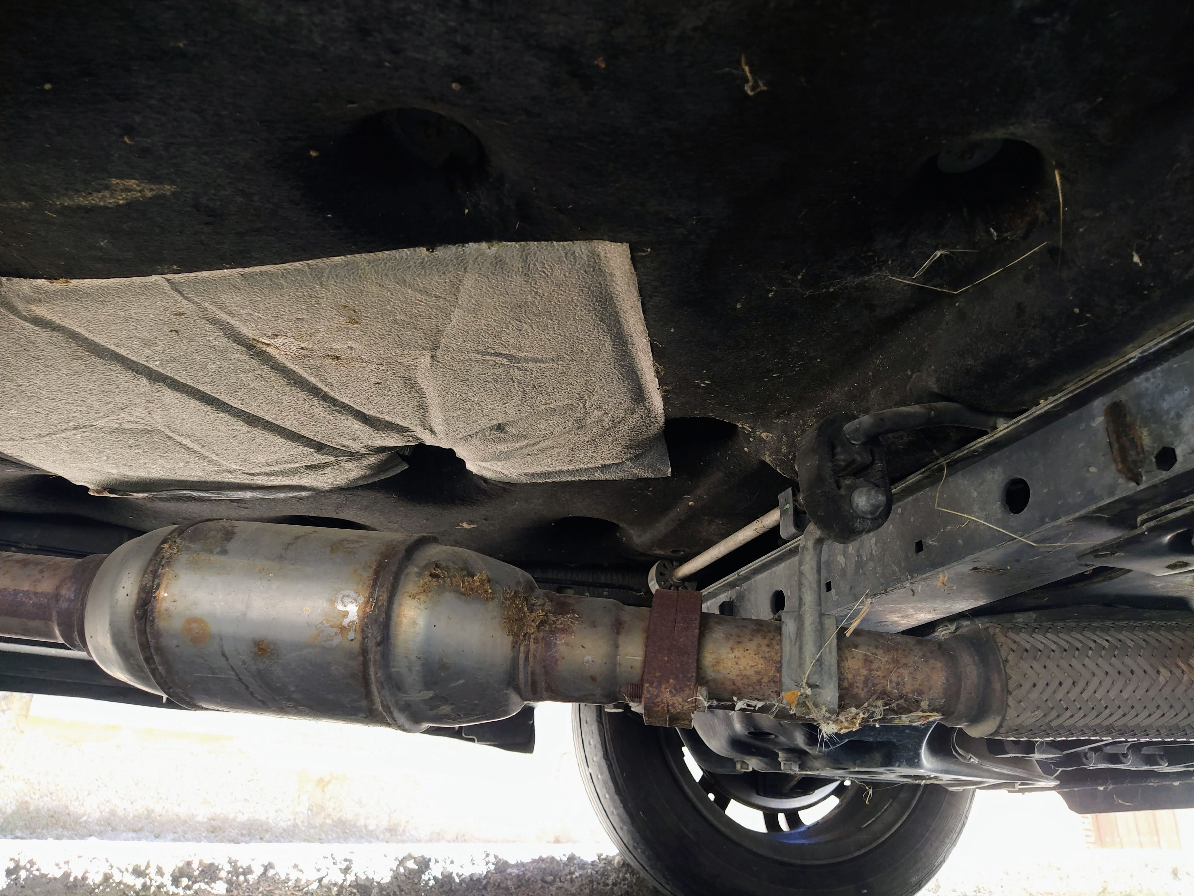

I took some photos of the exhaust pipe, from the engine to the end. I know the car has a catalytic converter, but I'm not sure if it has a particulate filter. The photo number 2 is taken from both sides (2a and 2b).
Can anyone tell from the photos if my car has a particulate filter?
Is there any other way to find out?

In your pictures there is no particulate filter fitted
Look at your registration certificate and see if the emmision data for your vehicle is listed and if it is lower than the euro4 norms.
You will find the nox and hc+nox figures are much higher than euro4 limits
I have the same vehicle and checked the official figures
