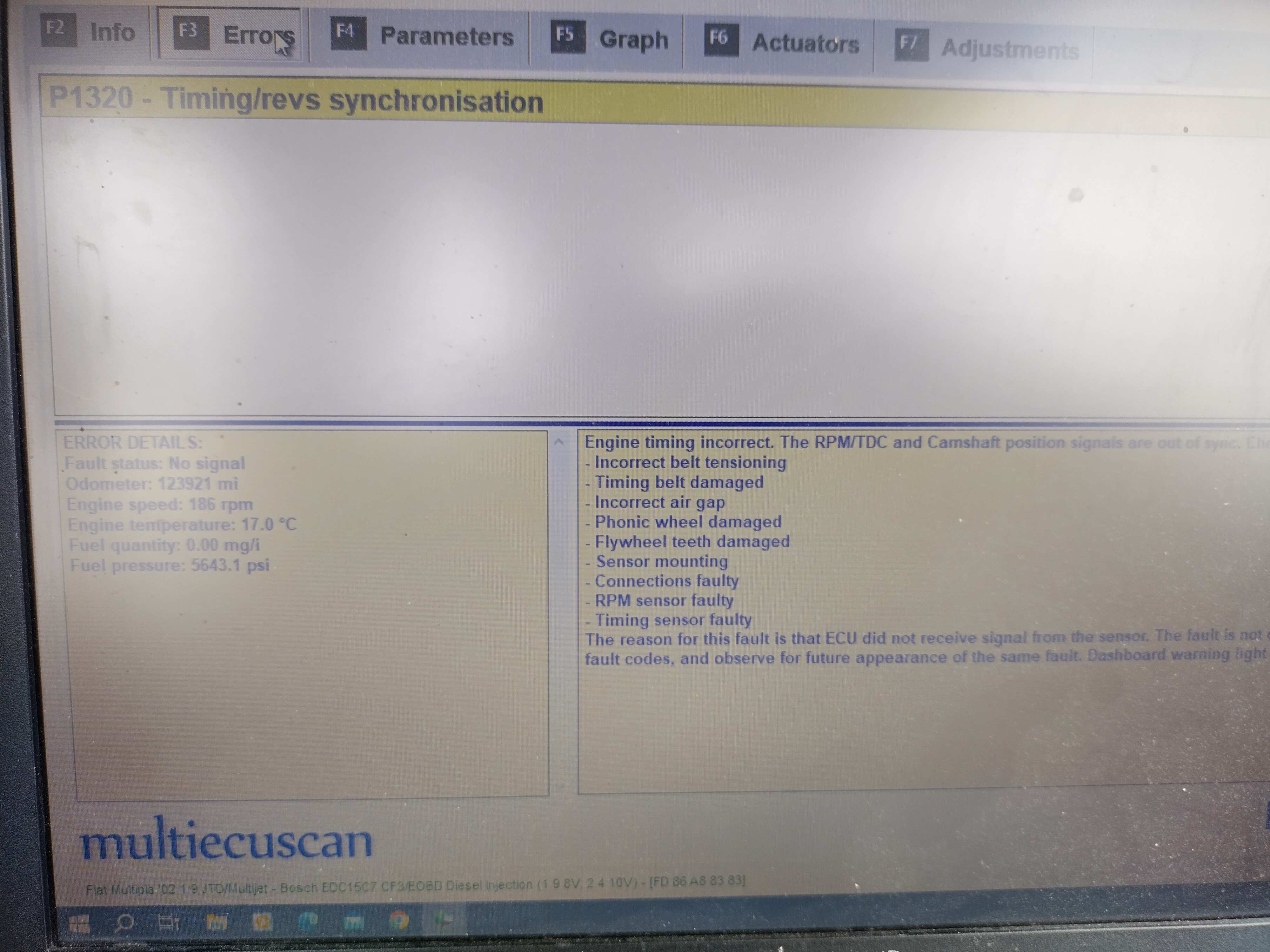

Hi Mike,
Spoken to Dan, (mechanic) and he seems to think that there's not any problem between the crank and cam sensors, and he's had a really good look and cleaned everything down in the area, (the cam pulley wasn't broken, just badly worn on the edge where I put the red circle, and was worn so thin, that it had bent slightly inwards, which Dan seemed to think was what shredded the sensor. He said he did a through check before replacing the gear and cam sensor, and found nothing. 'Strange that with a 'pattern' sensor, it wouldn't fire, yet with a Bosch one it does? Belt and tensioner are OK, having been done a while ago along with the water pump, and flywheel when clutch was done.
Have added the MES scan printout from my laptop, showing the 'possible' faults, most of which Dan thinks he has eliminated (belt, flywheel, sensor, etc). The rpm is spot on as well, so think we can eliminate that.
Not sure about the 'phonic wheel' though?
Hi Mike,

Your MES does seem to indicate worth looking in that direction plus may check for wires starting to break/corrode to the sensors.
