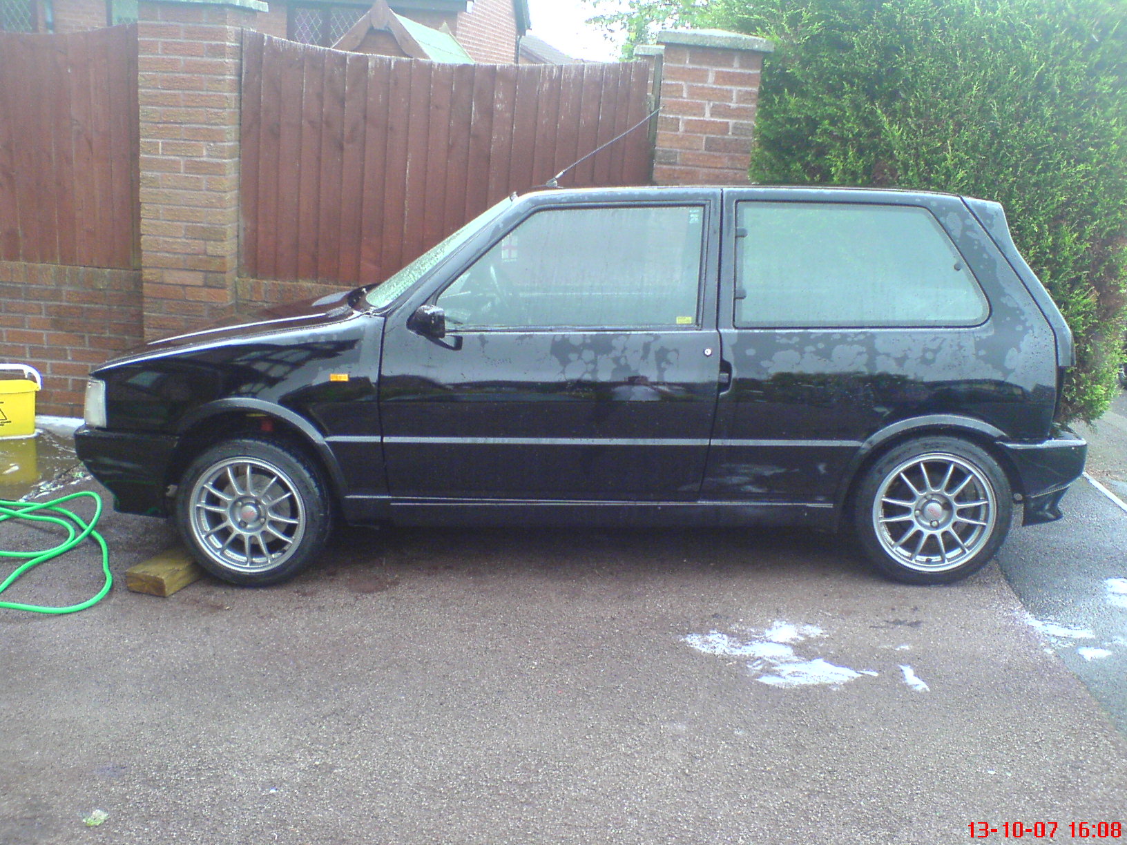

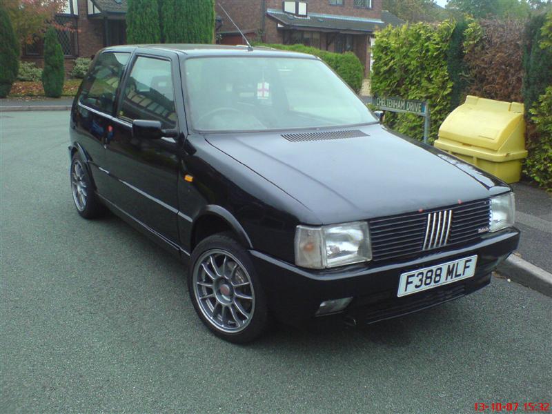

Some of you might or might not know but i've had a black mk1 UT for just over four years now in a lock-up
I'm finally going to start working on it and it should hopefully be on road sometime during 2008. Its not going to be 100percent original from factory but exactly how i want it to look and go!
IMO its the best one, MK1(obvious lol) black, tipo gearbox, no sunroof and the late spec interior.
the engine has been re-built with hybrid turbo, ported head, lightened and balanced bottom end, piper cam and some other goodies. once its in and running i'm going to run it on aftermarket engine management.
pictures are the first time its seen sunlight in about a year.
I'll update this thread as and when i can :)
Mark

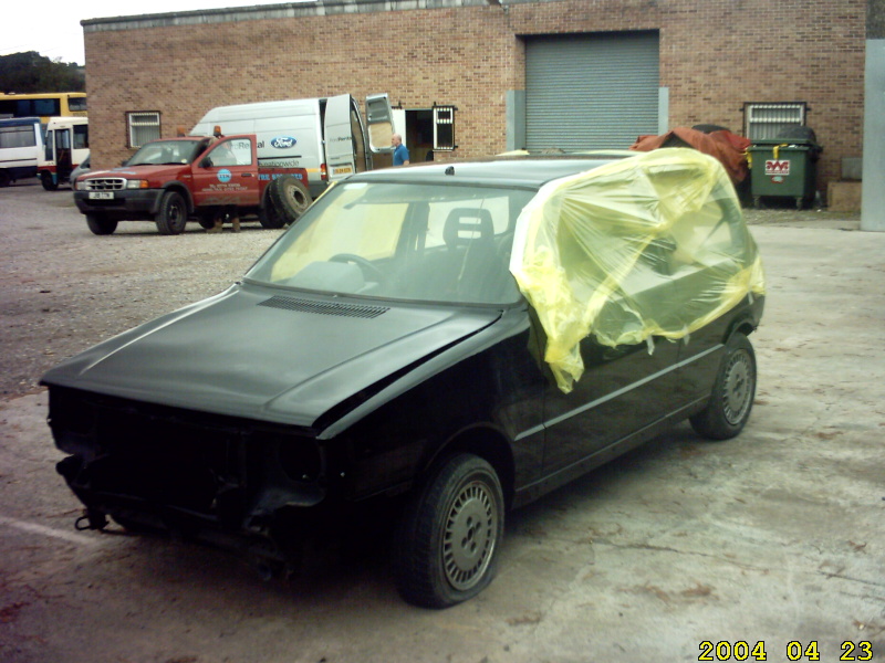

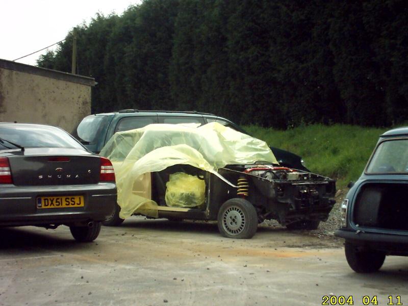

thankfully all the bodywork is mint on it and it has no rust, back in 2004 it had a full re-spray with brand new doors, wings, bonnet and sills, there is no rust anywhere,

pics are before and after the respray

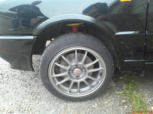

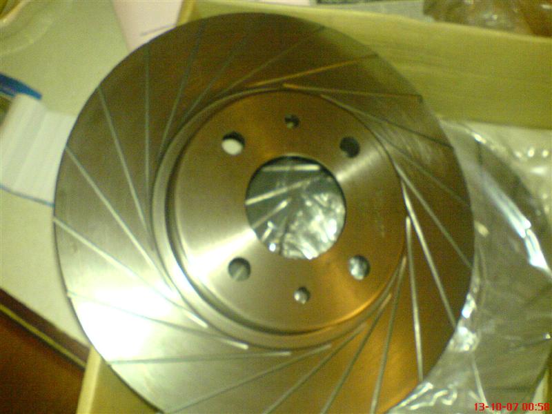

went and picked these badboys up tonight, red dot 20 grove front discs for a Punto GT, gotta get the calipers sorted and the greenstuff pads then gonna bang them on the Uno with some goodrige stainless braided hoses :)
i used to have problems with brake fade with standard brakes but hopefully not anymore!

weakest link in the ut, i never had the confidence while driving hard as the fooker wouldnt stop, constantly looking for old ladies in metro's pulling out! hated it! one of the first mods i did, the gt brakes red dot with ferodo fast road pads and they are a vast improvement, i have been given a set of lancia delta hf turbo brakes 257mm, which ive started cleaning up, just need a coat of red and rebuilding, also check your rear compensator as i had no rears due to it being seized! keep up the good work Ant!

put the new discs on to see what there like as the calipers had been removed ages ago so it took no time at all, looks much better and slightly bigger too just need to get pads and calipers sorted which i will do soon, ant if you wanna sell me your gt calipers let me know i'll have the asap.

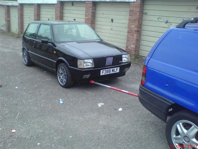

dragged the milf back to my house its been in a lockup garage for ages now. gave it a wash to clean all of the dust off and it came up really nice it amazes me how nice the paint is.
i wanna underseal all the wheel arches, sills, inside the doors basically everywhere i can!

oldschool these calipers are on any fiat over 1.6 1.8 16v brava bravo, alfa's etc inc marea + weekend just check they are 252mm vented discs and your away, easy, just pm a few of the fiats being broke on ebay and youl pick up a set cheap, or get your tape measure out and get down the scrappy even larger are the 2.0 20v that i think are 288mm all bolt on just make sure you get the carriers as well and maybe the brake flex's Ant!

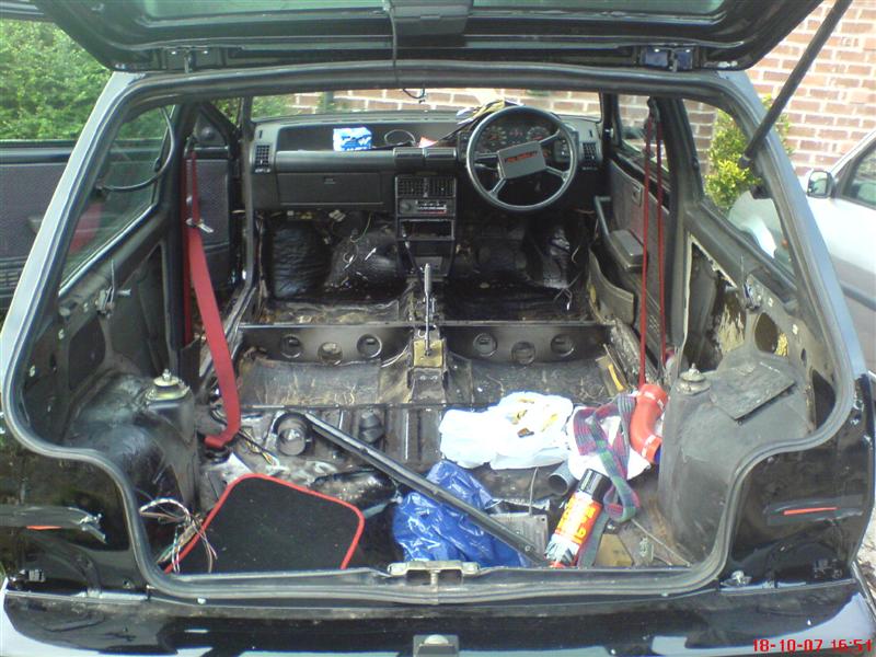

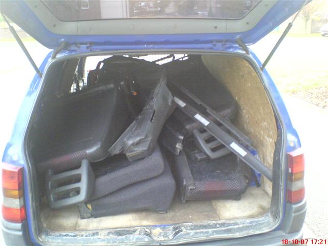

done a bit more to the uno today, stripped all of the interior and most of the plastic trim inside to be cleaned, and fitted the lock on the drivers door, need to go the scrappy to get a few more bits of the mechanism but should be sorted tomorrow,
anyone know the best way to clean the carpet, doorcards and seats? have looked into gettin a steam cleaner but is there any other ways?

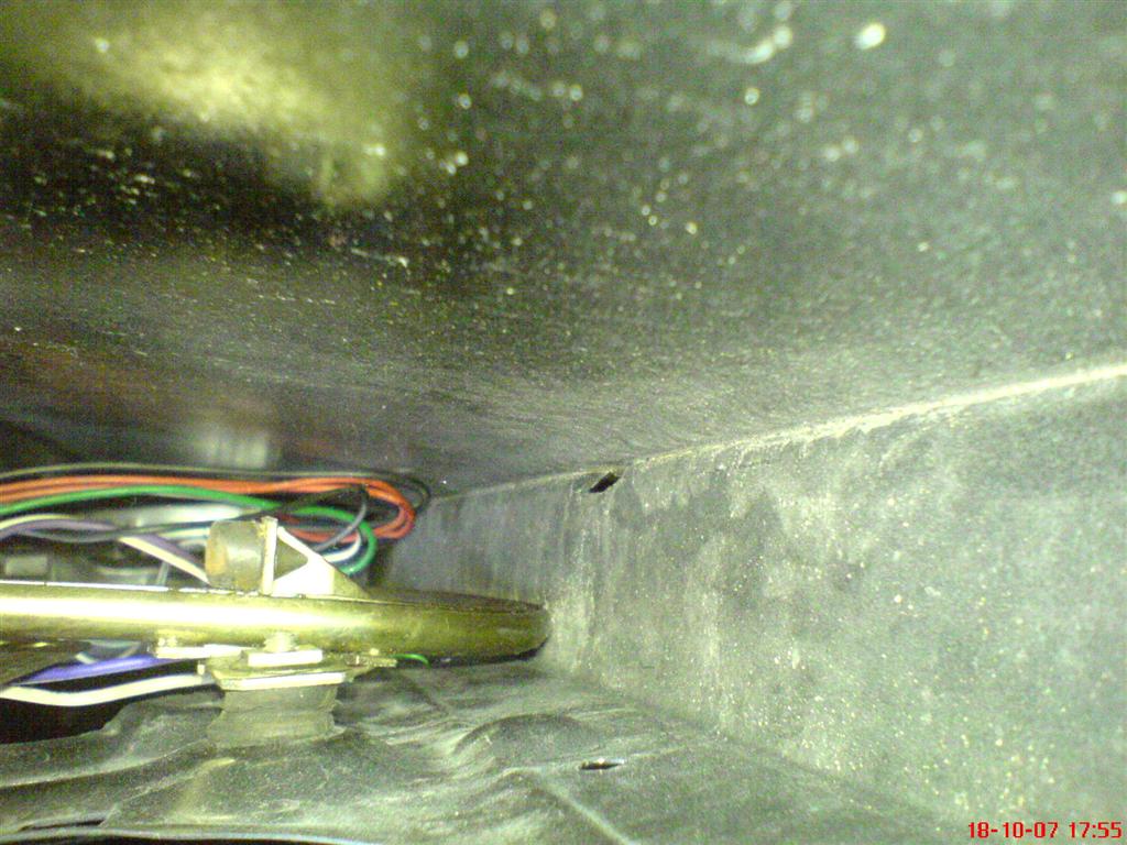

I've also added some pictures of something very rare with a uno turbo? see who can guess first lol!
Not the red seatbelts as the UT didn't come with them as standard (probably from a Cinq Sporting?)
I reckon it's the photo of the inside of the door showing the bottom of the electric window motor and a distinct lack of...
I'll leave it for someone else to confirm my suggestion ;)
