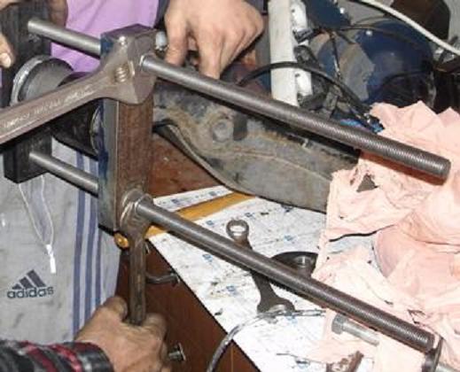

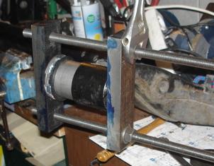

Here's a pic I found of some Stilo bushes going in. That looks a very easy to make and very strong compression tool. Looks like 1" steel bar and 2 fine thread screw rods around 3/4" dia
You'd need some kind of spacers towards the end of course to allow the bush through. Time consuming but I don't think the bushes would have any choice but to get in there

Nice pictures ,that`s the sort of set up I have been considering but rather than using the nuts to apply the pressure I would use an Enerpac Jack, these vary in force (i.e. Jack/ Piston Diameter) used them at work regularly.
heres link to enerpac site http://www.enerpac.com/en/products/...rsm-rcs-series-low-height-cylinders-0?tid=301
So you could sandwich the jack within the "strongbacks" take up the slack with the nuts on the threaded bar then use the jack to press bushes out/ in.
Rather than making a “Turned” adapter like Yellowstilos to assist pressing the bushes in I intend to drill & tap three holes M10 in some 20mm thick plate and screw three M10 capheads(12.9 grade) of sufficient length thru the plate ,the ends of the capheads would act on the outer wall of the bush to ensure no undue loading to the bush centre.
I intend to use 20mm allthread and 20mm double thickness nuts.
A spacer tube will also be required similar to bush housing dimensions I am going to try and source some Steam or Hydraulic pipe fittings to measure bore /outside diameter & length
My bushes are OK at present, but due to current mileage I am going to make a pressing attachment up just in case.
I can put it to good use anyway-The other halfs Tongue between the bars and a light nip of the nuts for a peaceful weekend :)

Well there's some nice alternatives there and it comes down to price, whether you want to try to do it in situ or on the bench and whether you want to make a one off or a career out of it:)
Hydraulic is nice and controlled. Screw threads are easy to replace
They'll all need that spacer in the end to make the bush go fully home of course.
Plates and screws made up might cost as little as £30 from an engineering shop

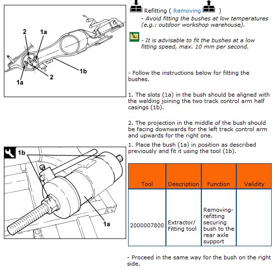

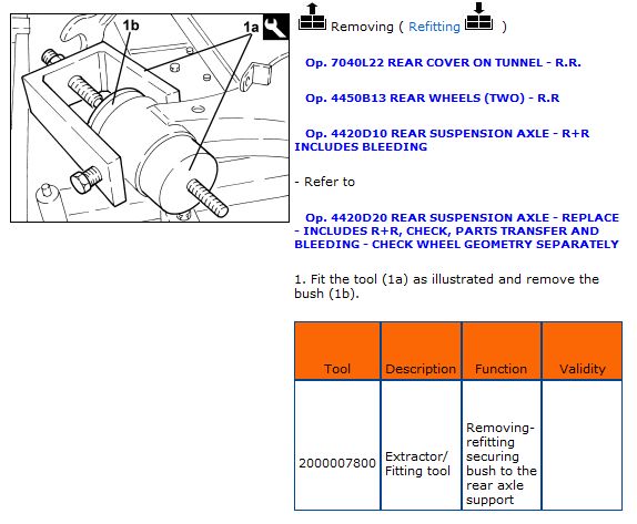

The torque isn't shown in the Stilo eLEARN but the Stilo and Grande Punto 1.2, 1.3 and 1.4 bushes are the same part number. Grande Punto eLEARN shows it as 11.7 - 14.3 daNm (86 - 105 lb/ft)
There's no instructions for replacing the bushes in the Stilo eLEARN. Probably because when it was published, the bushes were not available seperately.
Grande Punto eLEARN shows these instructions.
Price of the tool 2000007800 from Fiat was £16.20 including VAT from February 2010 ePER, but although the bushes are the same, the axle is not. Therefore, the tool may not be suitable for the Stilo.
Interesting that the bushes do need to be fitted the correct way up.

Thanks for that Davren
Looking at the tool then it would appear that either the Bravo bushes are not ridiculously oversized and have a correct and sensible minimal interference fit or the tool wouldn't stand an earthly chance of working.
So that would be the first job. Obtain bushes and get them to the correct outside diameter dimensions
Then it says don't do the job outside in the cold, in a garage or warehouse so a quick, clanking drive to somewhere in the Mediterranean would be a bonus:)

Looking at the tool then it would appear that either the Bravo bushes are not ridiculously oversized and have a correct and sensible minimal interference fit or the tool wouldn't stand an earthly chance of working.:)
The bushes are the same part number so will be the same size. My guess is that Fiat have learnt from the Stilo problem and manufactured the bush housing in the Bravo axle slightly larger.
