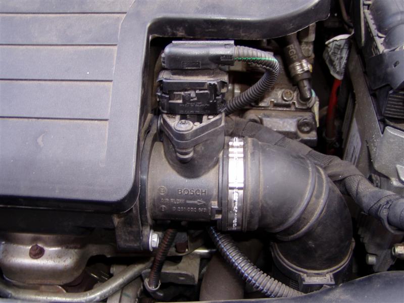

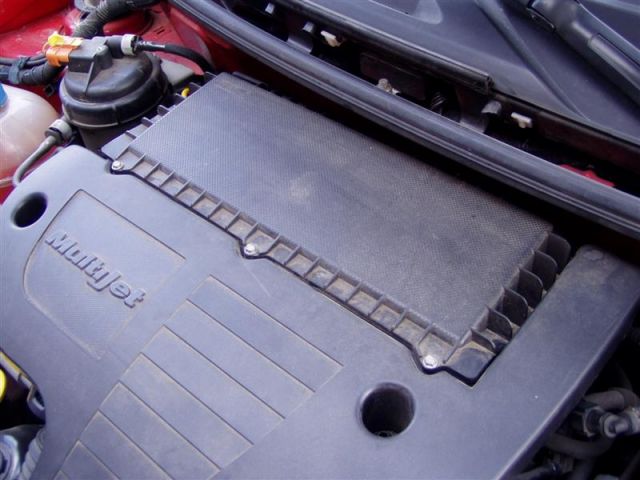

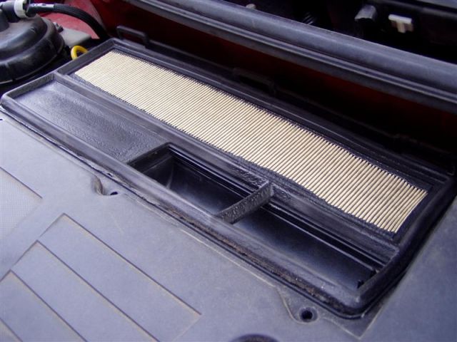

I thought I'd post a few pictures of my progress.
Pic 1:
Removed 3 screws from top of air filter housing
Pic 2:
Not a good start - thin strip of rubber at bottom of filter is wet (this is the 'out' side of the filter)
Pic 3:
Remove the 2 bolts on the MAF (pictured)
Pic 4:
More bad news - The view of the connection between the MAF and the air filter. I'm sure this bit should be dry...
Pic 5:
Remove the jubilee-type clip to disconnect the MAF
Pic 6:
Pipe on the other side of the MAF. Yes, it's wet in here too, and doesn't that bit go straight to the engine?
Pic 7:
The MAF itself - glistening nicely at the bottom where it's wet.
I think I'll have a trip to my local garage (really good, friendly small family business!) and see what he reckons as to solutions, but I'd also like to hear if any more knowledgeable people think that this would be responsible for the cutting out?

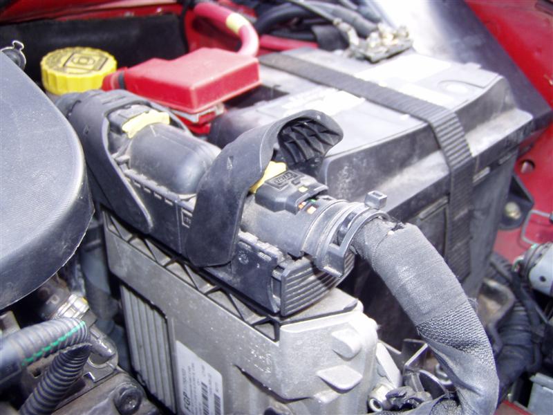

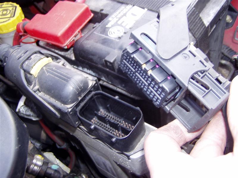

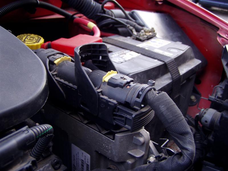

While I was busy, I had a look at the ECU connectors which some people have had bother with. When I (finally) got the connectors off, they were dry, but I thought I'd take a few step-by-step pictures to save other hopeless amateurs such as myself a few minutes.

I am trying to work out how the water is getting in, its unlikely it is sucking it in and the water would clog the filter rather than settle in the pipe.
do you think it might be condensation on the inside of the airbox as the engine heats and cools?
I wouldn't say it was condensation, due to it only being bad after rain - but I agree that it's unlikely to be sucking it in. My money's on one (or more) of the seals leaking.
I think it might be either the seal on the top of the air filter cover (it was wet on the rubber inside, but after the filter), or maybe the MAF-air filter housing connection.
Last week I had the turbo pressure sensor replaced, which involved the whole air filter housing being removed, and I wonder if one of the seals was incorrectly aligned when it was replaced, letting the water in?
Does anyone know what, if any, damage a bit of water in the engine would do? Or would it just make it a pain to start?
I'd imagine it would be the same to some extent as if you put petrol in a diesel car.
When mine was last in for the same problem they asked if I'd put petrol in the car by mistake. Which of course I hadn't. But if water is getting into the engine via the airbox, then I'm guessing that would have the same effect as petrol being put in by mistake. Although I'm about as techy as a goldfish, so I'm only guessing.
