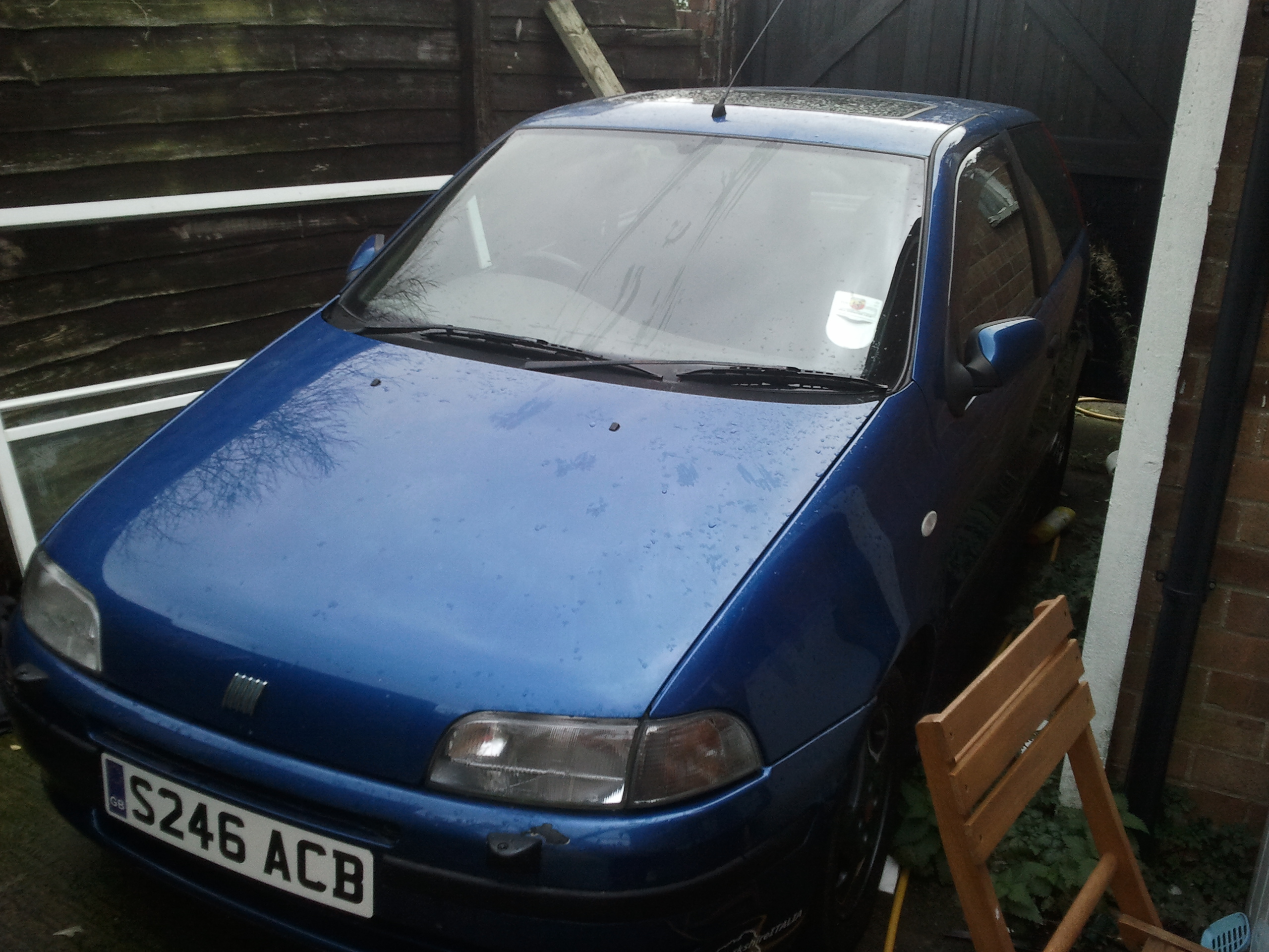

not really. Its been hiding in the back yard as been driving the sei turbo about all summer. I can't afford to run them both at the same time atm.
All i can really tell you is the rear wiper motor has stopped working, there is a squeak from one of the belts now and the cambelt tensioner has started making a noise too. (I started her up and let it run for a while the other day is how i know these things). Have new belts to go on already. Just need free time, bit of dry weather & some enthusiasm all at the same time and i'll go fit them.
I did as it happens take a photo of her this morning looking all dirty and sorry for herself in the yard. Not sure atm what the ultimate plan for her is, whether i'll keep her or not etc tbh. But she will get all the bits she needs doing sorted either way just cause she deserves it.
