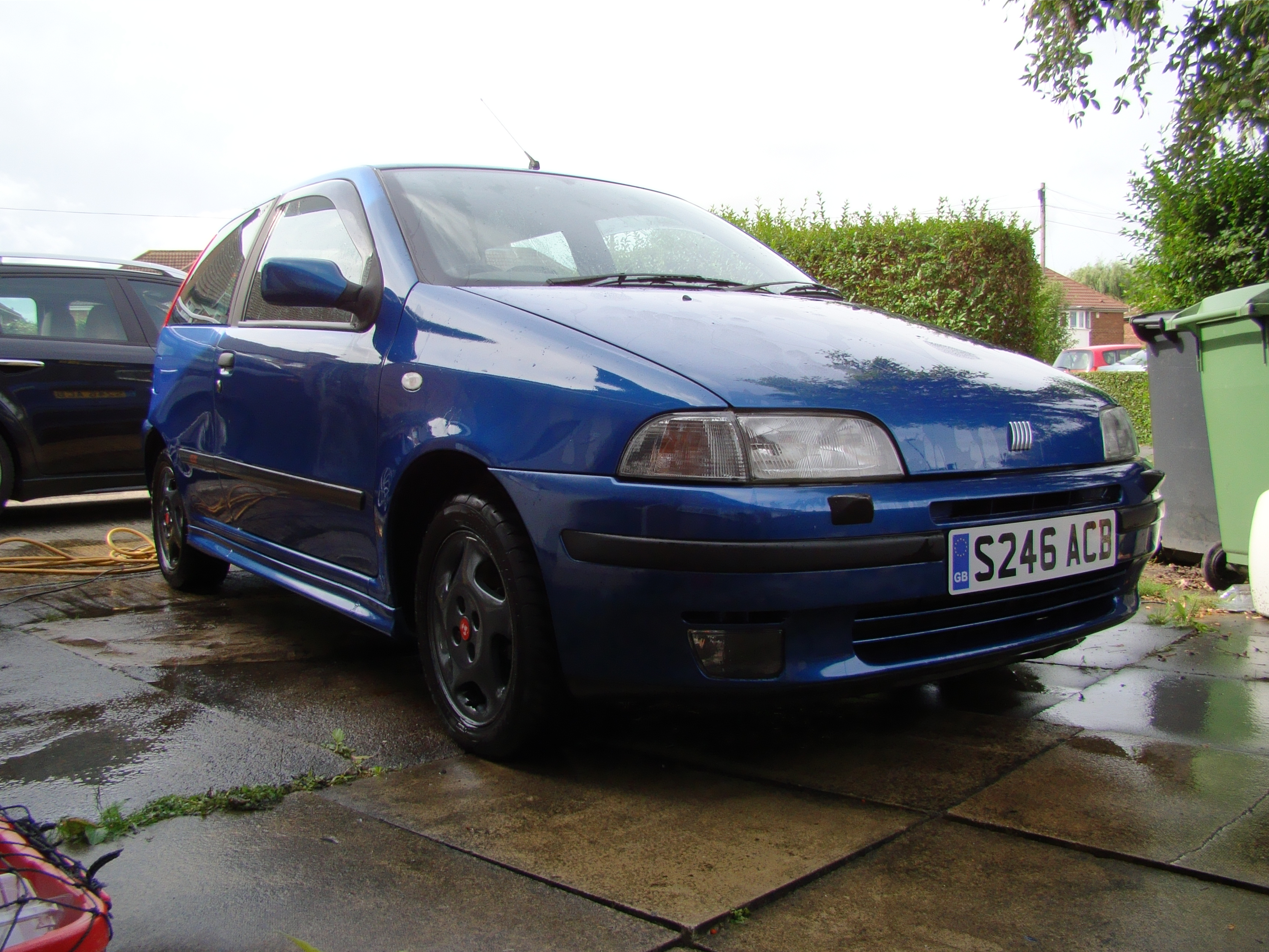

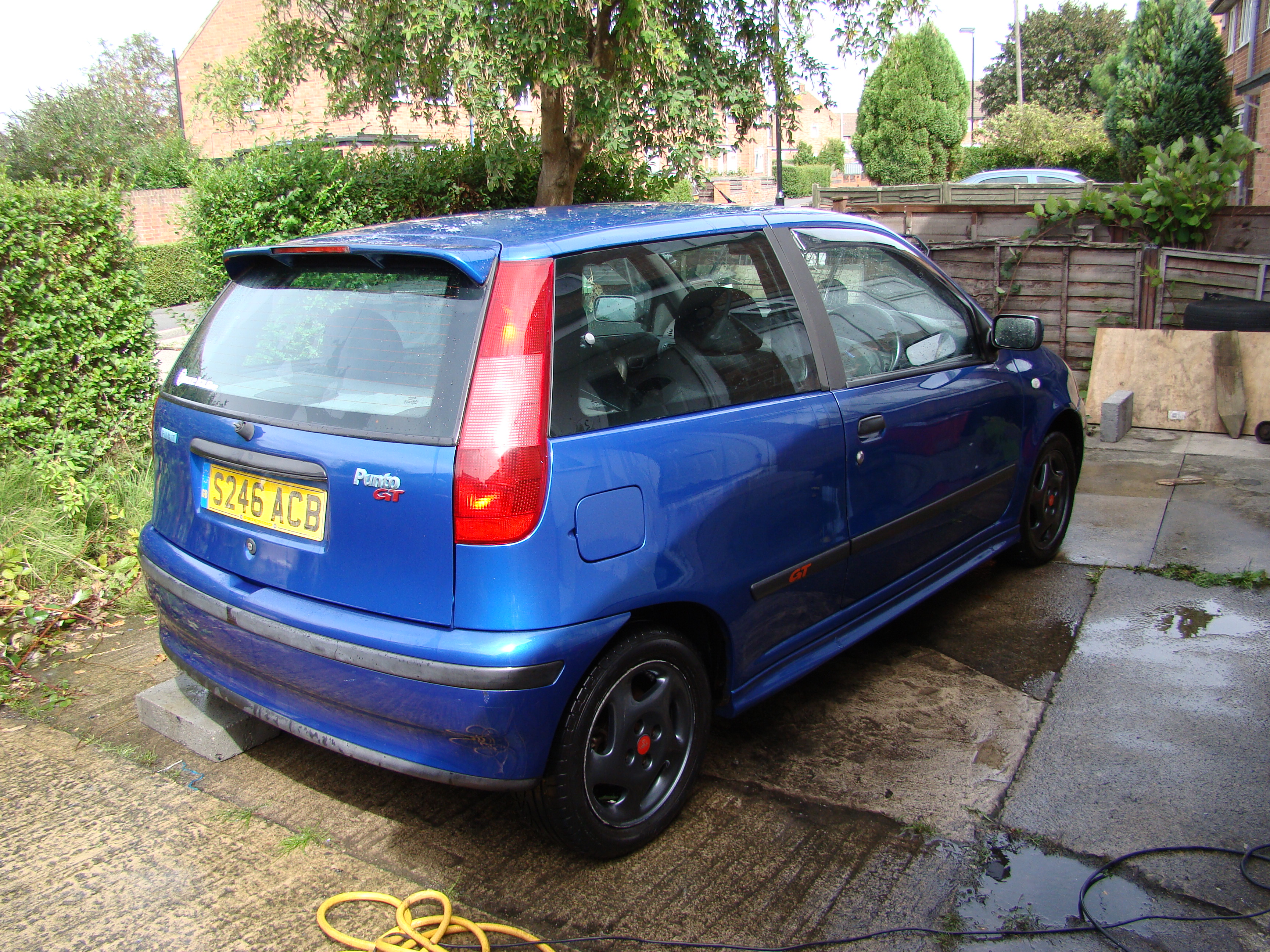

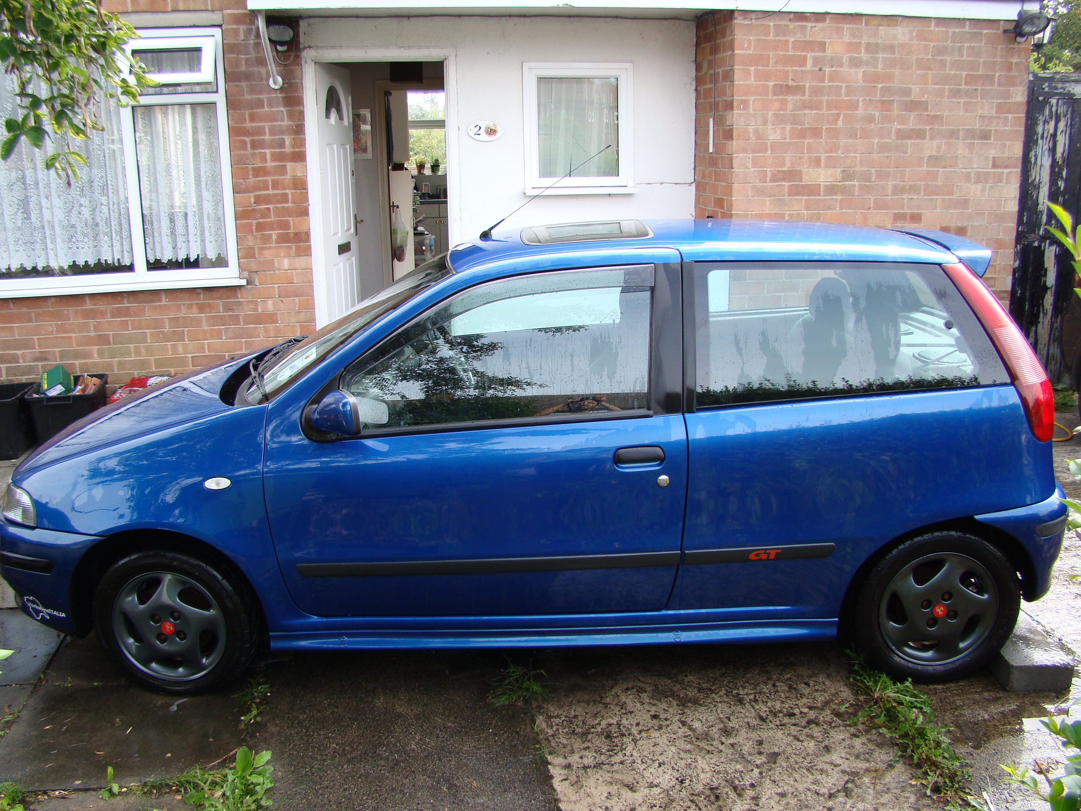

Well i might not have her much longer is the big news, verbally agreed sale but nothing more than that atm. But funny you should post though as things have happened, nothing exciting mind just general maintenance. Yesterday i pulled her out and changed the waterpump as it had become noisy. Stuck her battery back in and she fired straight up, let it idle for a while and warm up to bleed etc - everything ok, she running fine.
She has just had a wash this morning but not had time to stick any polish or wax or anything on it yet.

Looking nice and clean, bit of back to black on those plastic trims and she'll look lovely. Gave mine a blitz yesterday, I really should start a thread.
Its only been snow foamed and then washed and rinsed down in them pics, still need to to polish, wax, clean windows and do all the trim yet ;) Not even started on cleaning the inside either (naughty, should do that first really), not that she is hugely dirty inside.
