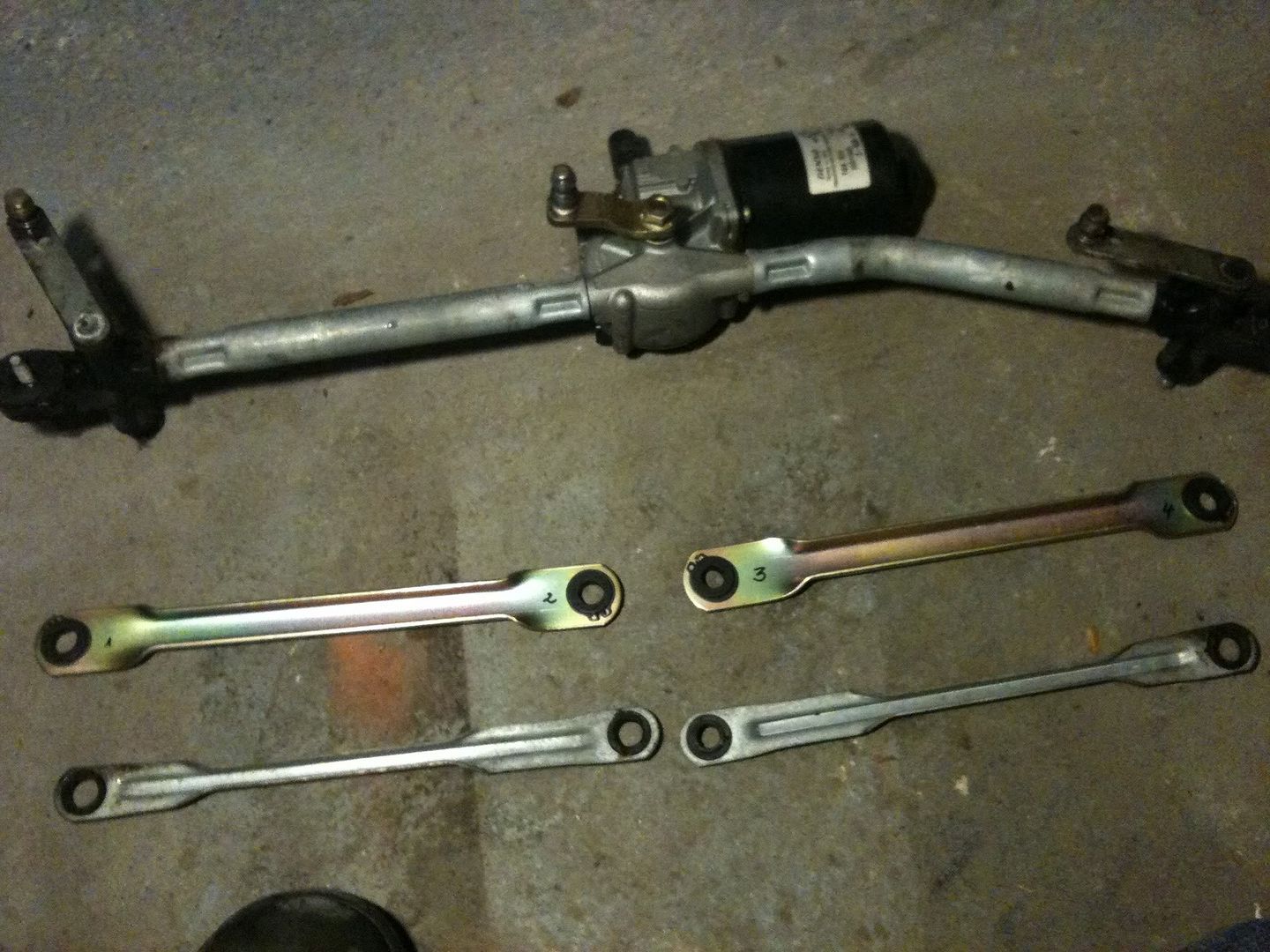

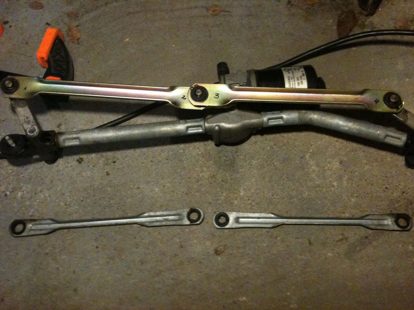

My wife's 1.2 Mk2 Punto suffered with the linkage dropping off the drivers side wiper, so after reading through these excellent posts, I temporarily held it together with 3 cable ties, placed an order from Wipex for the news ones which then arrived very quickly. After studying what to do it didn't take much time at all to take the motor out, knock off the old ones, clean and grease the connections and put the new ones on. For somebody that doesn't know anything about motors, I felt quite proud of myself!

My kit arrived today (very quick delivery) having ordered it on ebay on thursday evening where it's cheaper than on their site.
The tricky part is getting the wiper arms off the spindles as they were pretty stuck after six years in place. Other than that it's all very straightforward with 2 x 13mm bolts , 3 philips screws and 2 x 10mm bolts to remove.
I did wonder if it would be possible to attach the new arms with the assembly still on the car but the new push rods fit so tightly that wasn't going to happen.
The new push rods are obviously much better engineered than the factory fit ones and should easily last out the life of the car.
Yes, there are a few bodges that will do the job for less money but I'm happy to pay to do it properly.
