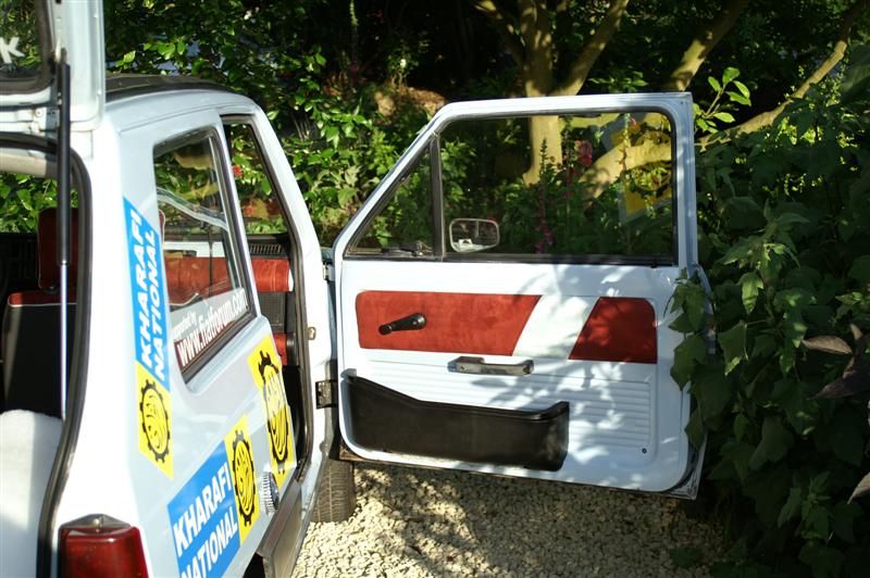

5) A new re-trim. Door cards where there were none and some nice new seat covers. (Sarah has been busy)

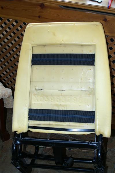

Sarah cracked on and finished the last front seat. Just the back seat to do now.

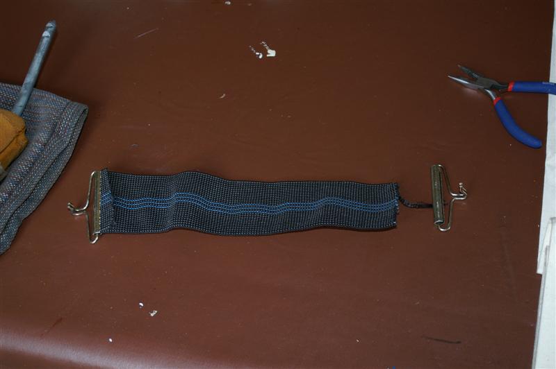

The centre back support was broken as it had pulled away from its clip. Easy fix. Just open the clip up, wrap the elastic back around and then lockup in the vice.

The seats look great, what kind of material is that? It looks like alcantara, but I'm guessing it's not as the material would have cost more than the car...
