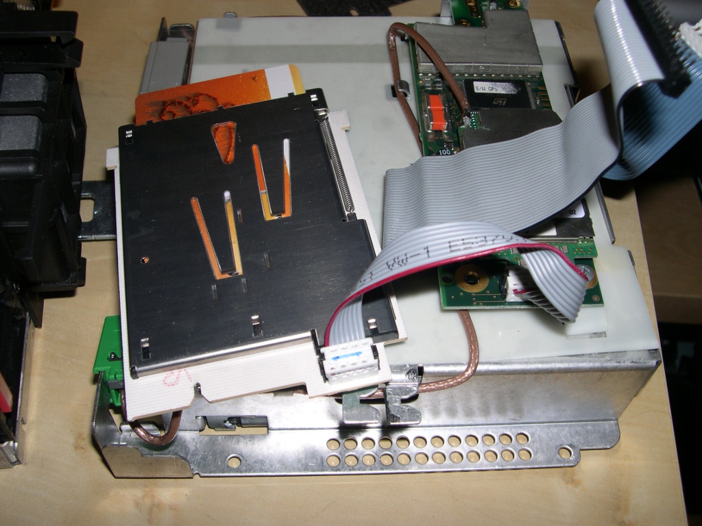

Could be a problem with the SIM card holder, or its ribbon cable or connectors inside the CN+. You can get the holder out by removing the front panel, but to get to the inner cable connector, you need to dismantle more of the CN+.
