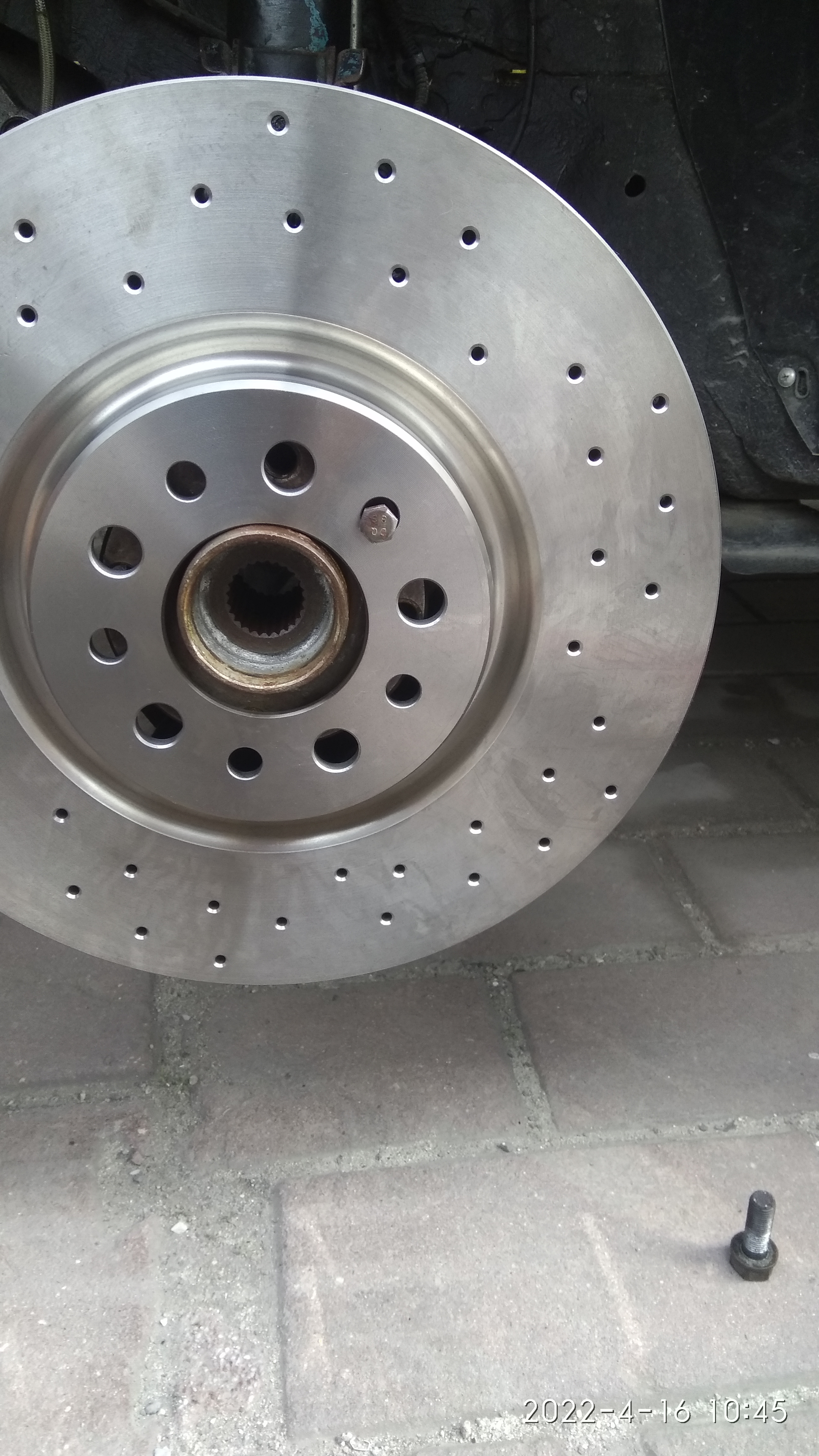

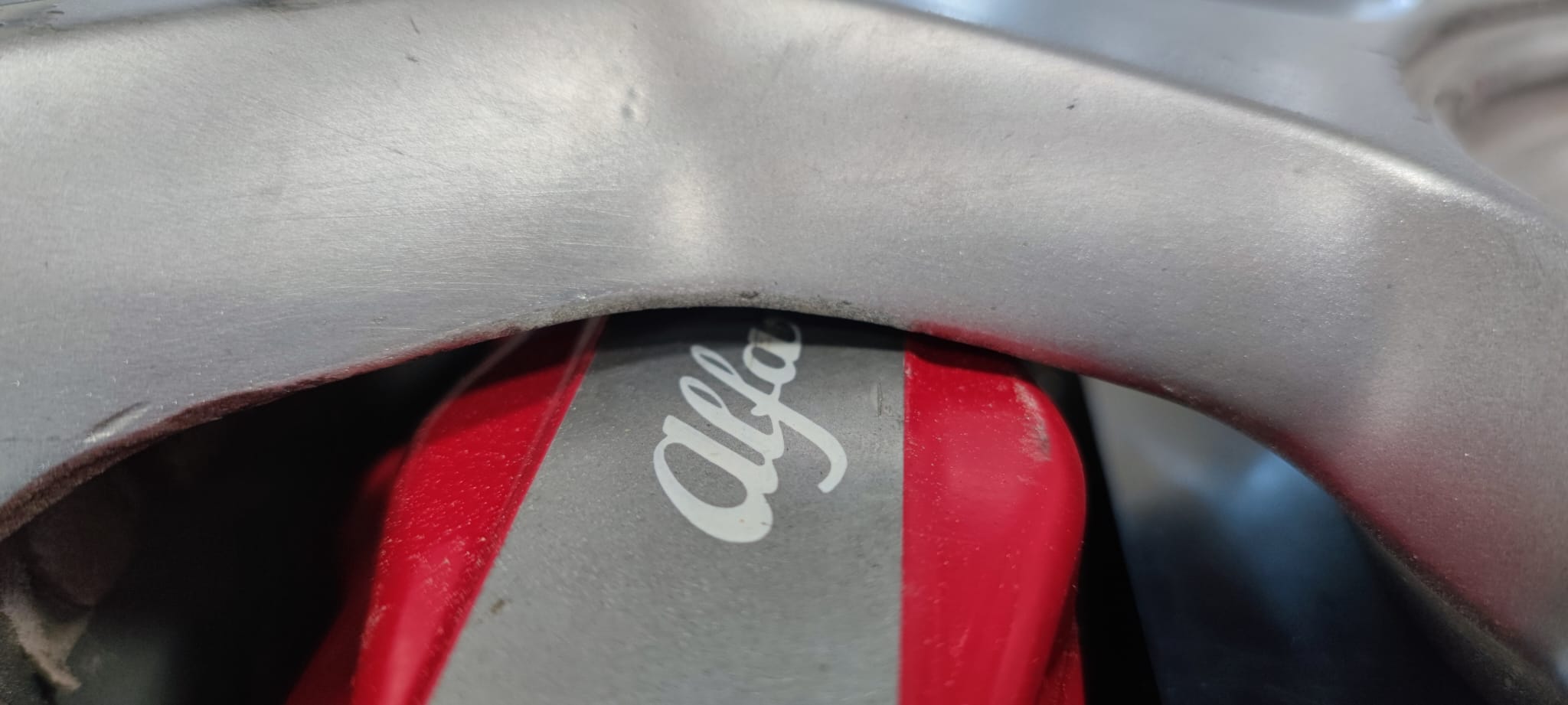

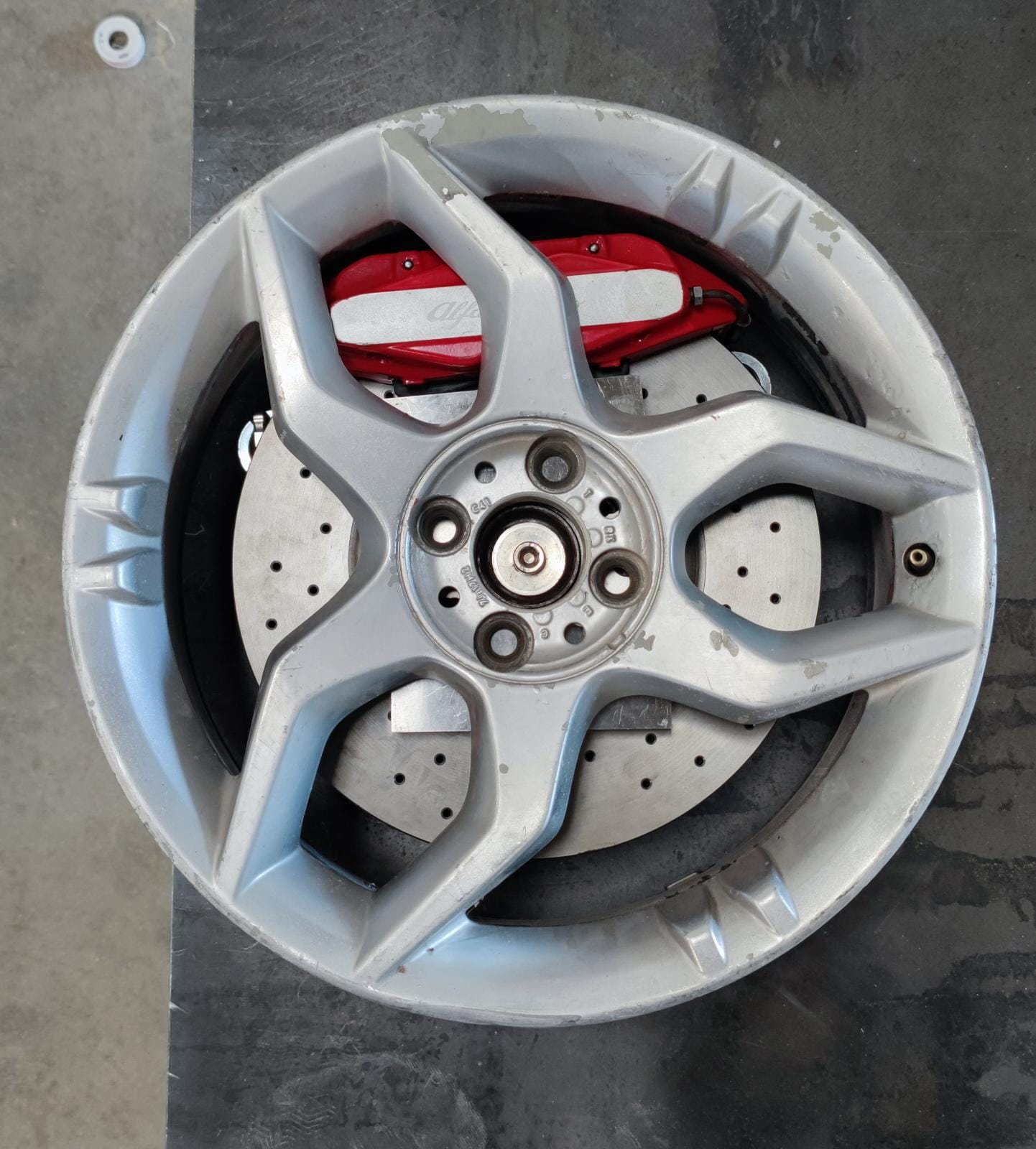

i converted my front 281mm brake discs to the 330mm brembo calipers and big discs.here is the details.i used alfa romeo brera 3.2 front calipers and discs.my friend made a custom brucket and used 18mm spacers from FG Spacer...this is the largest and biggest disc brakes and calipers can fit in to the 17' wheels... IMG_20220412_132222.jpg
