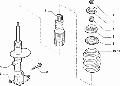

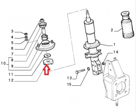

It seems you are suspicious of the top mount attachment and the symptoms seem to support that? It's feasible that the new shocks included the spacers and washers that go into the top mount (7&8) below (by the way I don't know if this is the correct diagram for your model but it is 4x4 however the principle will be the same) and these were incorrect;
Also if there is a Nylock nut (part 6 here) then it is possible that it was not fully tightened due to rotation of the shock, there is a flat (or hex - allen type) on the top of the shock shaft that should be held while tightening the nut; this precludes the use of a socket for the final tightening - but the fitter (if he had any experience should be across this). If you can jack the car up to get front wheel off the ground and then lever up wheel while watching the top mount (tricky without an assistant) then you should be able to check this visually. Use an axle stand as a precaution to anything falling off the jack!
The fact that it is both sides means either an improper installation or just not the right shocks...
The pic above is for the earlier, classic Panda, model 141. The original post is for teh 2003-2012 model, 169, where the top of the shocks are not fixed, relying on the weight of the car to keep them in place.
With the 'floating' top mount, the large washer, item 9, prevents the strut from falling out, but should usually only hit the car body if the wheels comeoff the ground, such as going slightly airborne over a fast bump.
If it is hitting on normal bumps, either they are being taken way too fast, or the shocks are too short, or perhaps the damping is too stiff on rebound, not allowing the shock to extend as the wheel drops.
To check if this is the cause of the noise, put a little blu-tack between the washer and body, with the car sitting normally. Not a big blob, just a thin amount. First bump should be a little quieter, and the blu-tack will be squashed.
Another possibility is that the top mounts (item 5) are collapsed, but I would have expected them to have been renewed when the struts were changed, but possibly not. When in the car, the struts should be towards the rear of their mounting hole in the body, not the front. They sometimes get fitted the wrong way around.
Item 8, the top spring mount has a tab, that should be positioned in only one place. Perhaps the springs are not seated correctly.
The struts need to come off, and be inspected by someone who has seen these before, and knows how they look.
