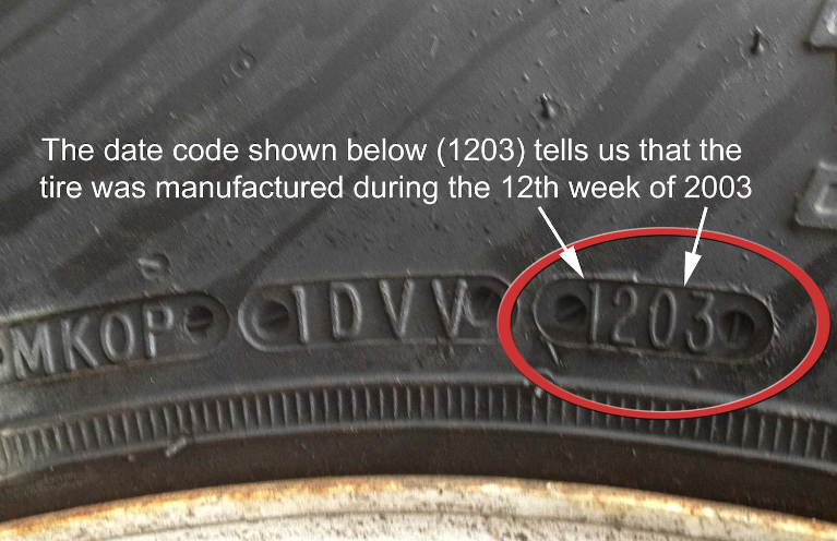

Yep; I'd be saving the money too. Mine's a 63 plate on 84k miles. Just treat it to proper oil and filters (especially if TA). Agree re tyres too, if still originals they could perhaps use a refresh regardless of tread depth there's likely cracks developing at the bottom of the tread pattern. Tyres have year (and month or week?) of manufacture moulded into tyre wall;
Ref internet search(!)
