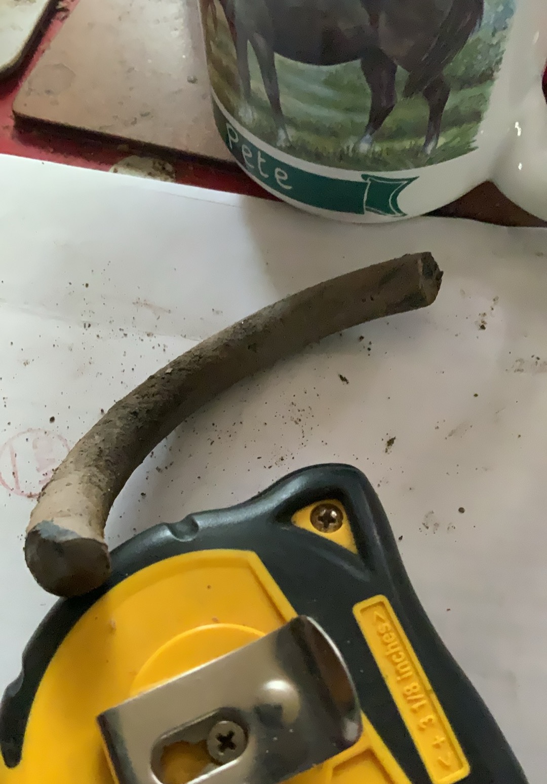

So had knocking from the front running gear. Nothing obvious, but on further investigation found that LHS front spring missing exactly a complete turn. I.e. since end aligned it did not look obvious.
Previous replace both back in autumn 2021. 4x4 diesel does just over 50 miles a day, over rough rural roads on Herefordshire Worcestershire border so guess maybe expected life?

Unfortunately no front coils listed on KYB, but will save it for potential other parts. I live in “ spring” country, so will revisit my previous contacts. Autodoc not good at filtering so suspicious of some of the selections. Looking for 403-410 long 143 dia, 12mm wire, 5.4 turns and weight a little over 2kg? And a lot of listings don’t give data or do not match despite entering vehicle data. Found potential on eBay , but again waiting for vendor to confirm actual geometry data. Thank for the steer to look wider.

The other S4P27389, went yesterday! Job for the weekend. Have to order a couple more again and hope the lock nut comes off ?
