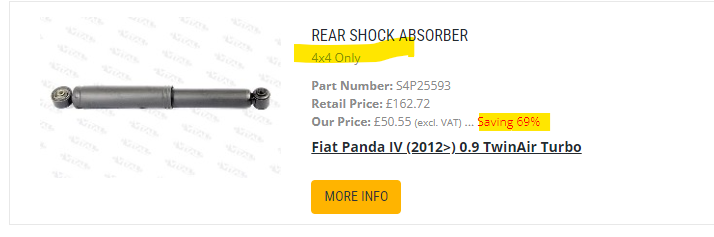

Thanks for the replies. I am not that knowledgeable about mechanics, but I did look for spare parts on shop4parts.co.uk, and (if my search was correct) I can see the parts are nowhere near the prices I am being offered. Front suspension arm is going for about 50 pounds and a rear shock is about 30 pounds.

Double check S4P that you choose 4x4 (I yours is??) They are still a bargain - I just ordered a pair!
I missed the other question - S4P always been good to me. They will also answer the phone! And any questions which is priceless these days!
