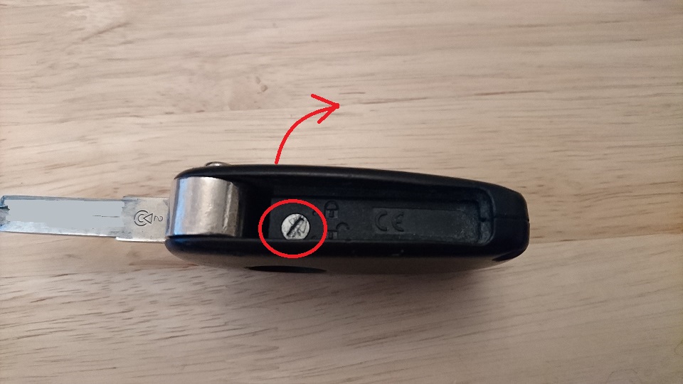

To start, first remove the battery from the keyfob. This has a screw lock that will release the slide-out battery tray.
Step 2
Use the thin flathead screwdriver or fine edge of your blade to slip in between the badge and the casing. Lever the badge out of the recess (it is stuck down with an adhesive pad).
Step 3
Remove the screw that has been revealed.

Step 1
Step 2
Step 3
