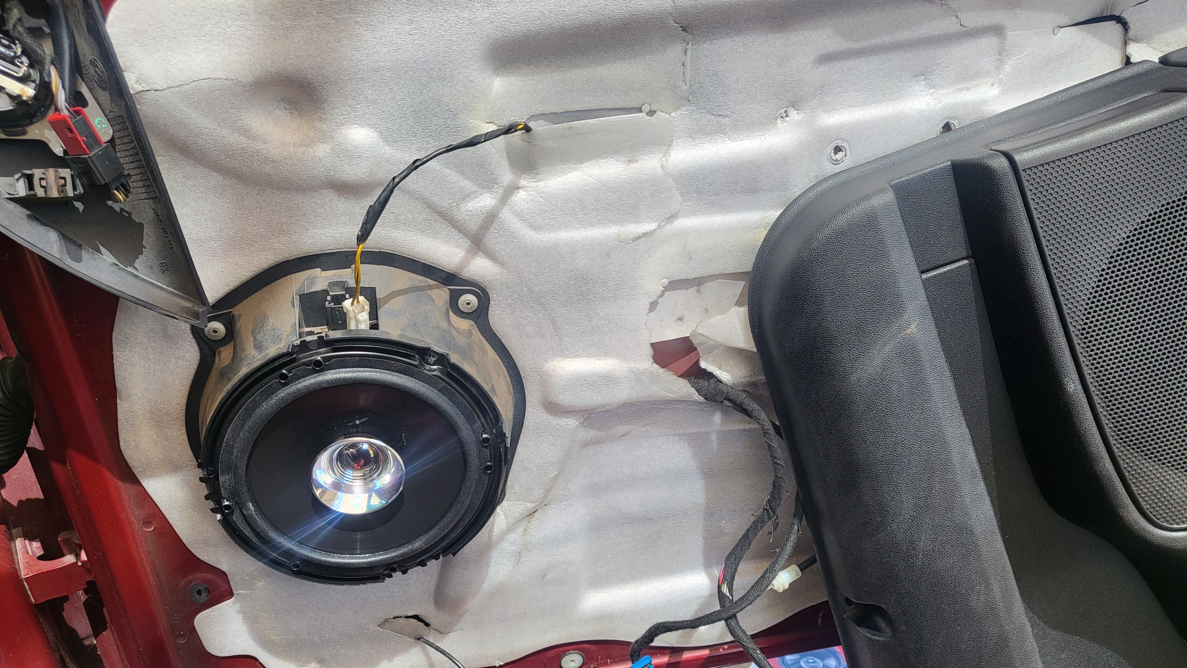

  1. Take the door panel off
  2. Disconnect the speaker by pulling the cable out by the plug

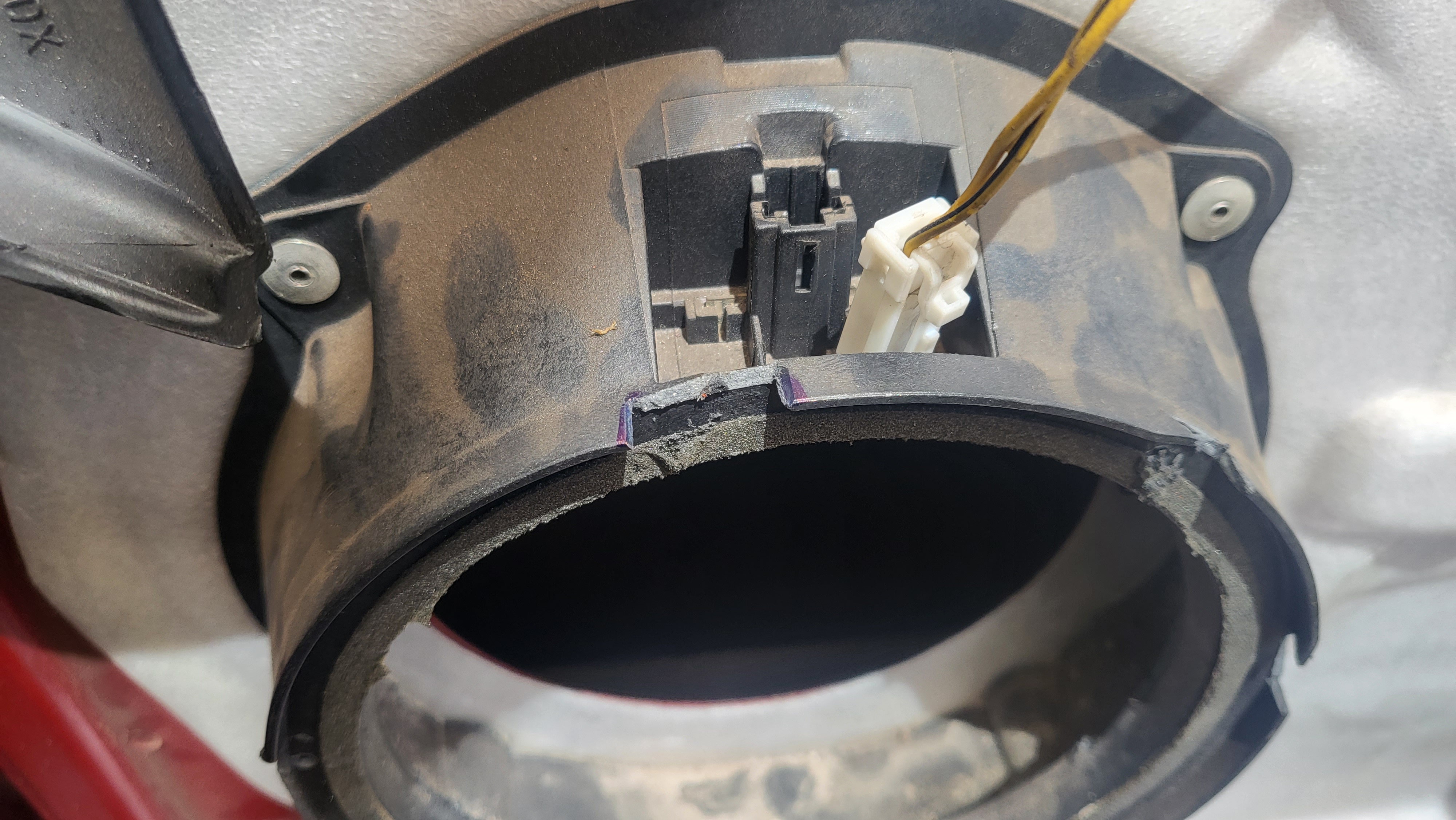

  3. Remove the speaker cone by tearing through it.
  4. Nip the core out by breaking the support

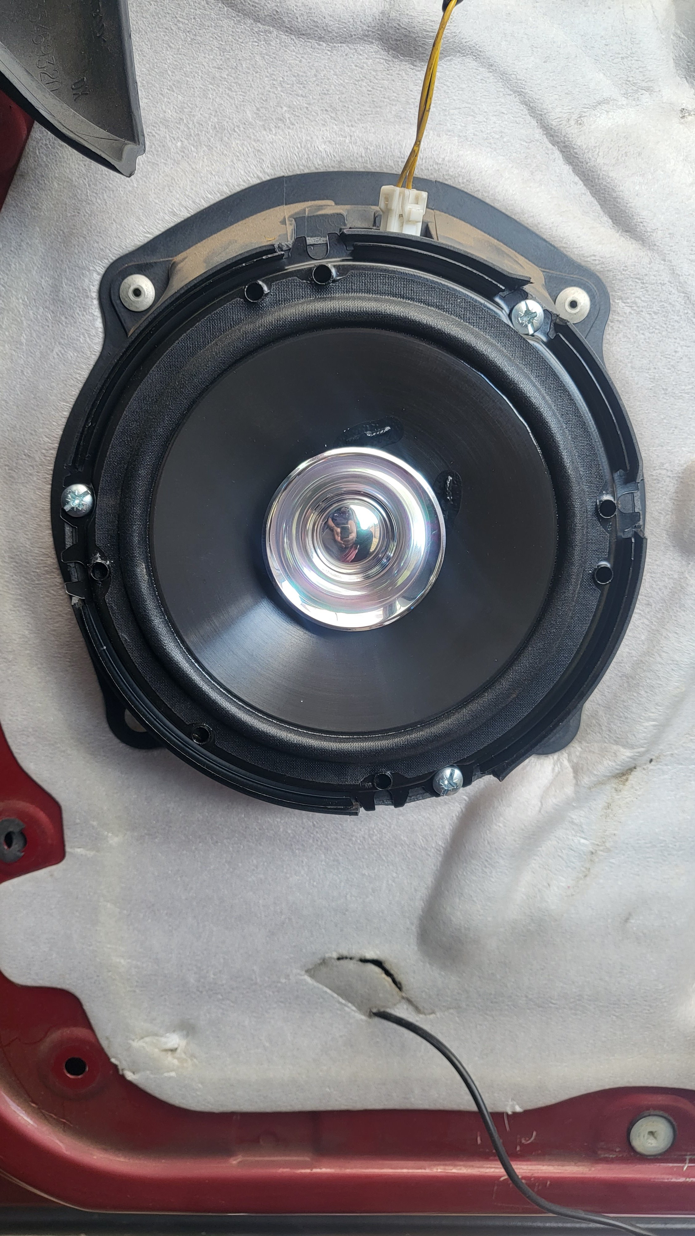

  5. mark the holes of the replacement speaker and use the self-tapping screws to attach it
  6. Take note that the speaker size is 6,5 inch
