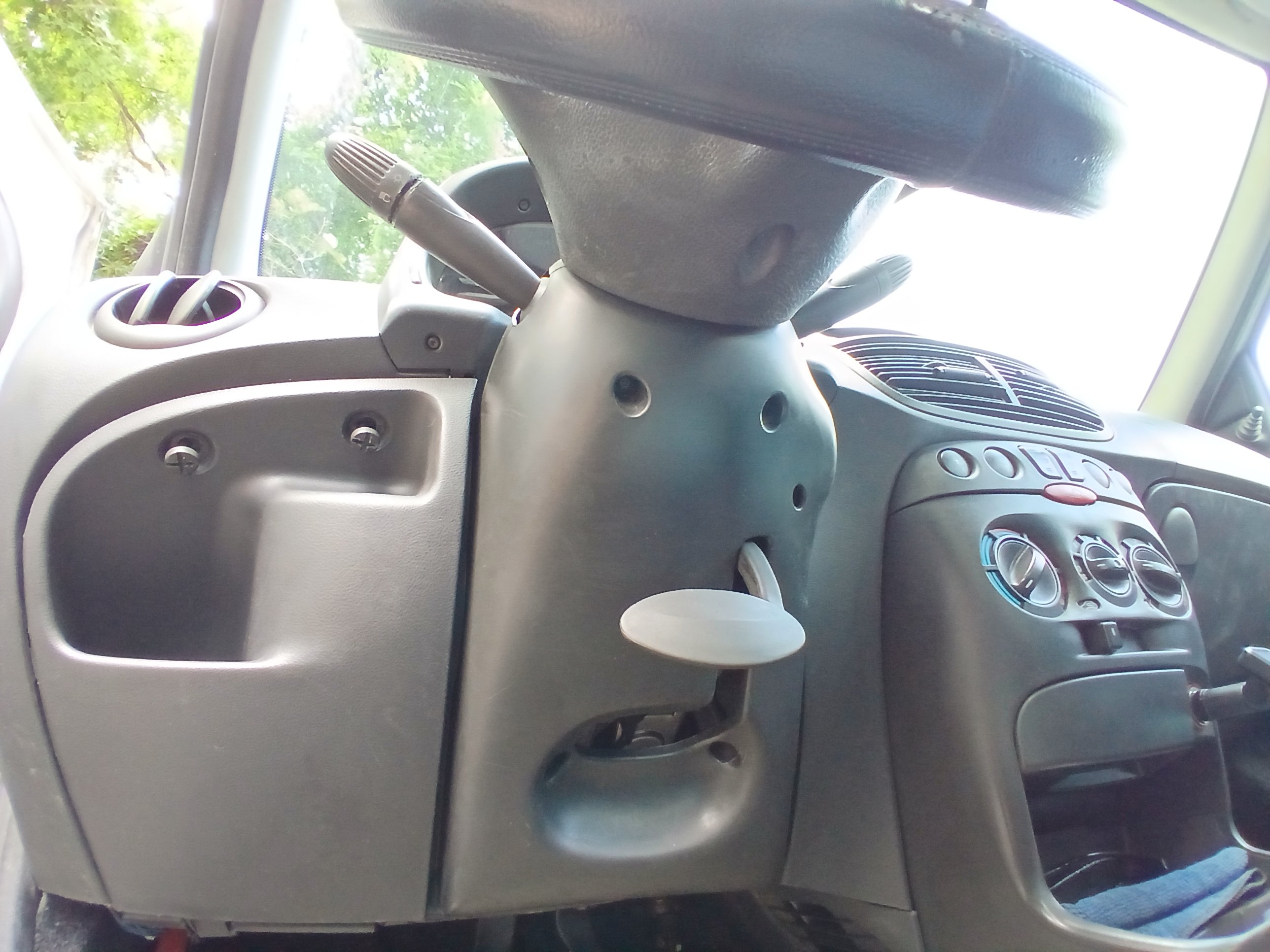

Take off cabin fusebox cover
Take off steering column cover
Take off the two flat screwdriver head screws holding the ignition switch in position
Disconnect the electrical plugs and the antenna ring little plug and the clip holding its cable
Press in the 2 clips holding the commutator in place
Commutator will come out probably with locker plate too. Take off the locker plate and place it back inside ignition switch in correct position
Have the new commutator on paying attention to the white plate. It needs to match position to fit in over the locker plate. Rotate the white plate in correct position and press the commutator in until it clicks. If it doesn't go in easy, don't force it, it's because plates are not aligned in correct position. Reposition the white plate and fit the commutator in until it goes in easy and clicks.
There it is. Ignition switch is fix. Test it by putting in the key and switch the key on. Test if it is working by connecting the plugs, antenna plug too and start the engine.
Put everything back in reverse order.
