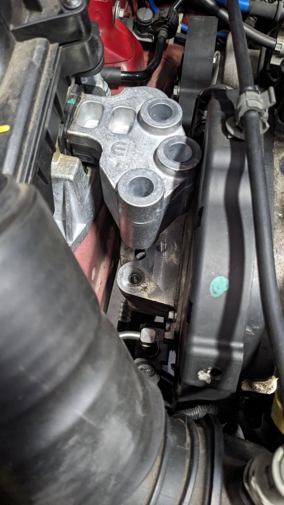

I used a trolley jack but also stack of wood under the engine as a secondary support - didn't take a photo of this set up
7. undo 3 engine mount bolts
full DIY is here, but unless you are replacing the mount (which I did recently), there is no need to take out the air box etc - only the 3 bolts
