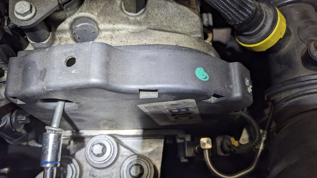

1. undo 10mm bolt

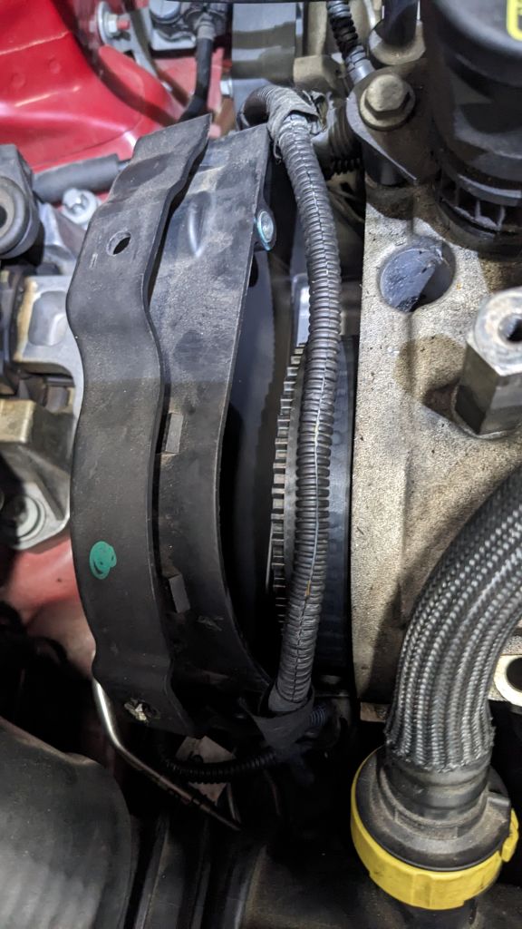

2. pull out wire harness, it is tightly jammed in so you have to work itover the humps

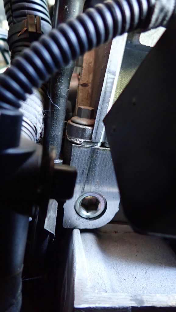

3. 10mm hex bit to undo the strainer; it is held in place by a rubbr washer so you need to use pliers to get leverage to pull it out

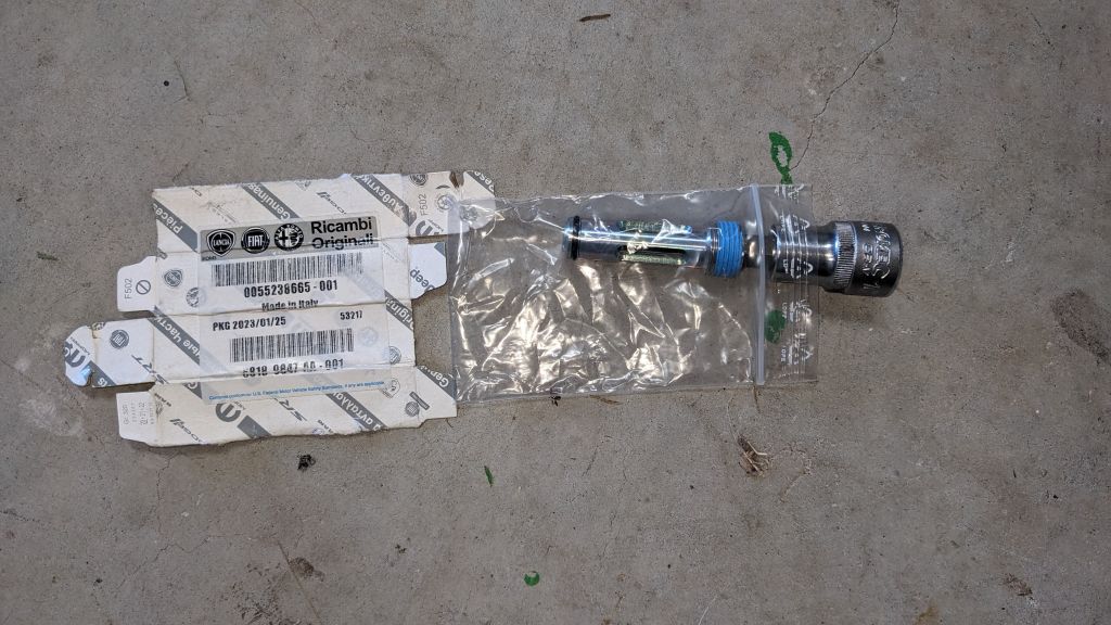

4. push in new strainer
5. tighten to 27Nm
6. put the plastic cover back and squeeze the wire harness back in
