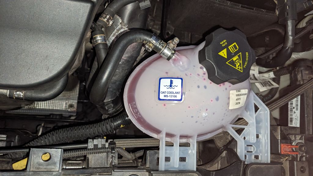

I needed to replace the coolant reservoir as it was starting to leak at the seam and every few months I would need to add more coolant.
Was concerned it would just blow up one day.

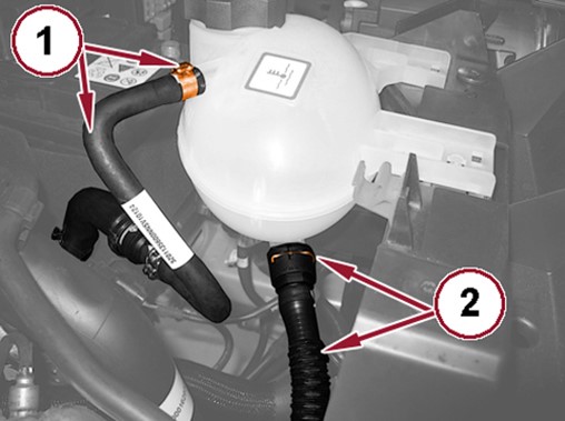

1. Loosen the clamp and remove the degas hose (1) from the pressurized coolant bottle.
2. Duct tape the spout to minimize spillage.
3. Release the clip marked 2 and remove the coolant hose from the coolant bottle.

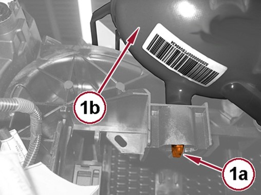

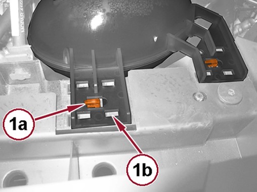

4. Lift TWO clips marked orange 1a and slide the pressurized coolant bottle to your LEFT and disengage the bottle from tabs marked 1b.
5. Squeeze the orange clips marked 1a and remove coolant bottle.

8. Pour the coolant from the old reservoir into the new one. Glad you put the duct tape on, hey!
9. Turn on the engine. Wait till coolant is at operating temperature to test the connections.
Remember, when hot the level will be above MAX. Obviously don’t undo the cap when hot.
