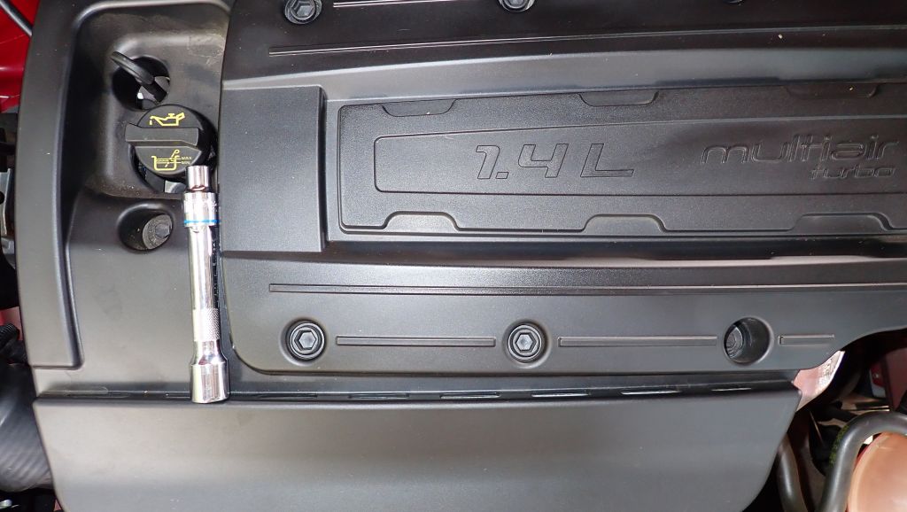

1. undo 10mm bolts holding beauty cover

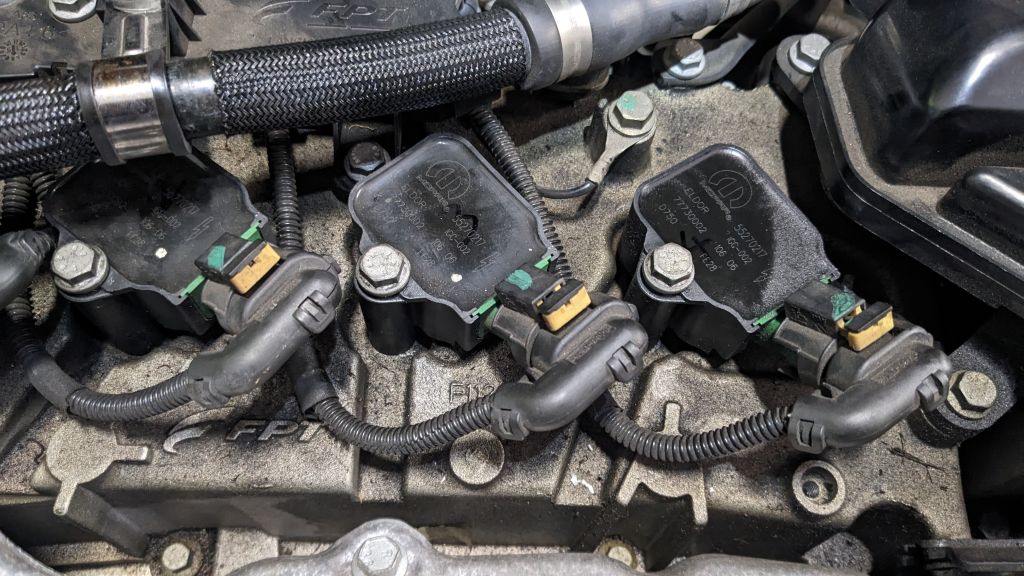

2. label coil packs (1 -> 4 left to right)
3. undo 4 x 10mm bolts holding coil packs

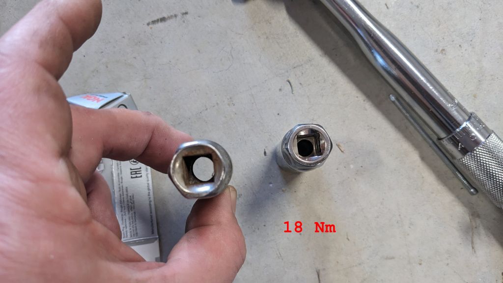

4. undo spark plugs with a spark plug socket which has a rubber insert to allow easy removal (otherwise you need a telescopic magnet)
5. partially insert new spark plug into the spark plug socket and loosely screw in all 4
If you insert spark plug all the way in, sometimes the socket sticks to the spark plug and comes away from the extension bar
6. screw in each spark plug using a spark plug socket without the rubber stopper (18 Nm)
