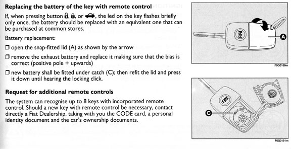

Silly question but how do you get to the battery in the fob, does it slide or snap open?
I'd be surprised if the battery has failed already -- mine, a March 2005 car which is used pretty well every day, and locked and unlocked several times a day, is still using the original battery.
But, the answer is that the lower part of the fob pops open - with the key blade 'open' you can pull the case apart by pulling quite hard at the join under the Fiat logo. Here's what the manual shows:

Nice one, cheers. I've gone through my manual and cannot find this info anywhere.
Mine has a black key fob with three buttons and folding blade. You have to pry off the Fiat logo badge (use a small sharp screwdriver) to find a screw underneath. Remove the screw and the case comes apart.
