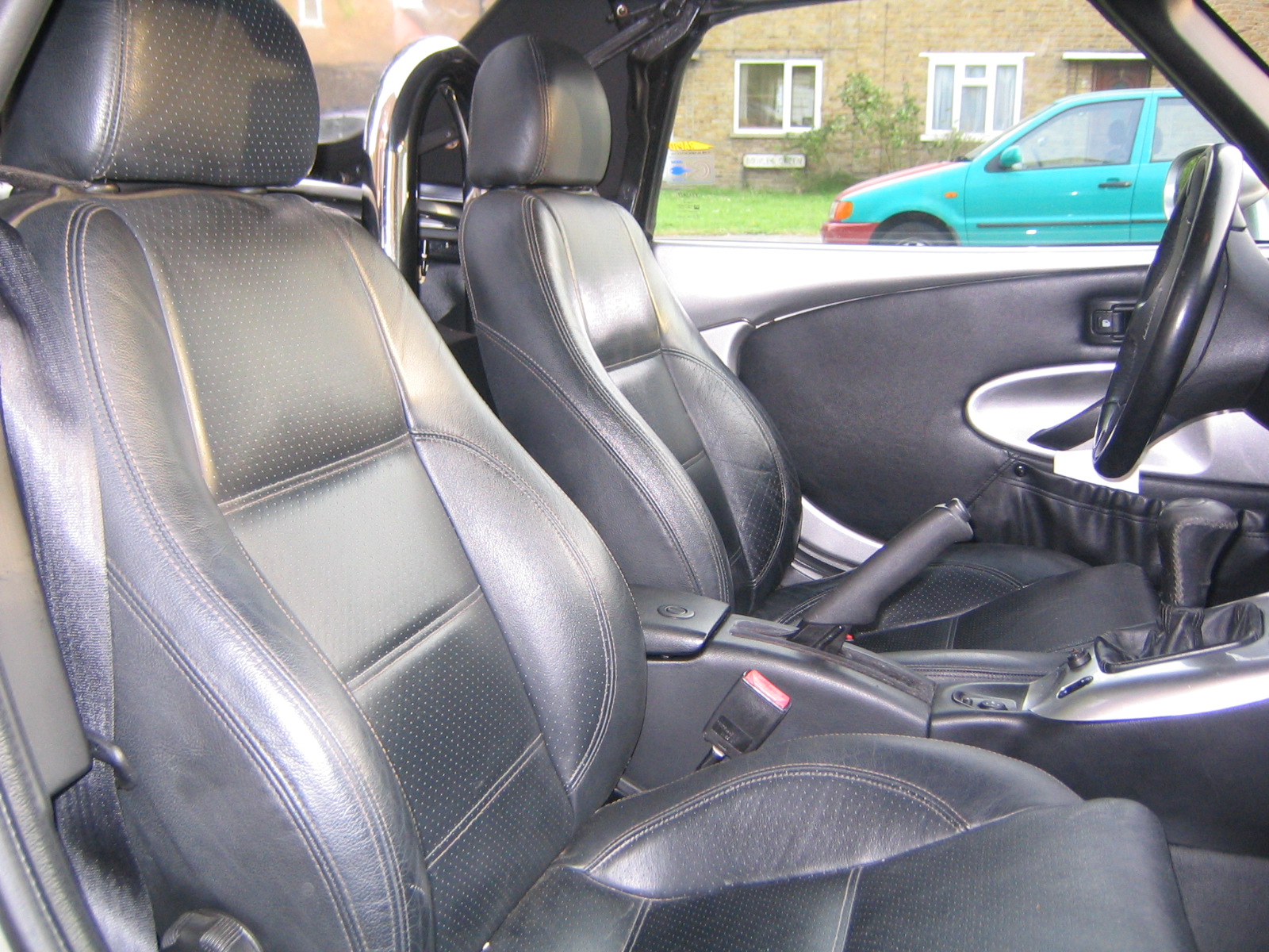

Some pics of the new interior, Really like it inside now, :) only thing i,m not so happy to drive her as she feels slow compared with the other wild thing -(Barchetta Turbo) :cry:
Need to get the turbo on her and i,ll be :D:D:D:D:D:D:D:D:D:D:D
Sorry! forgot the pics.
