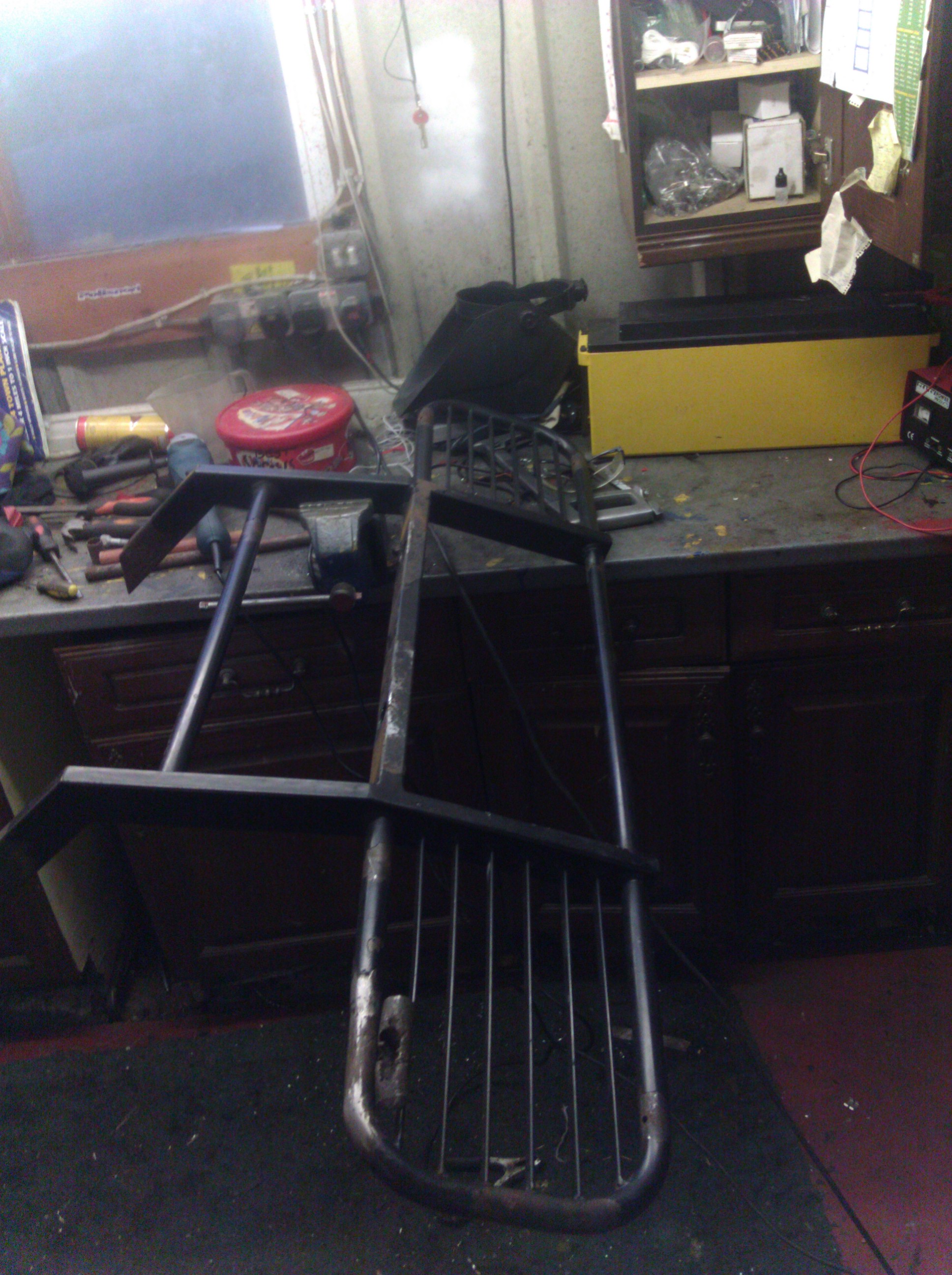

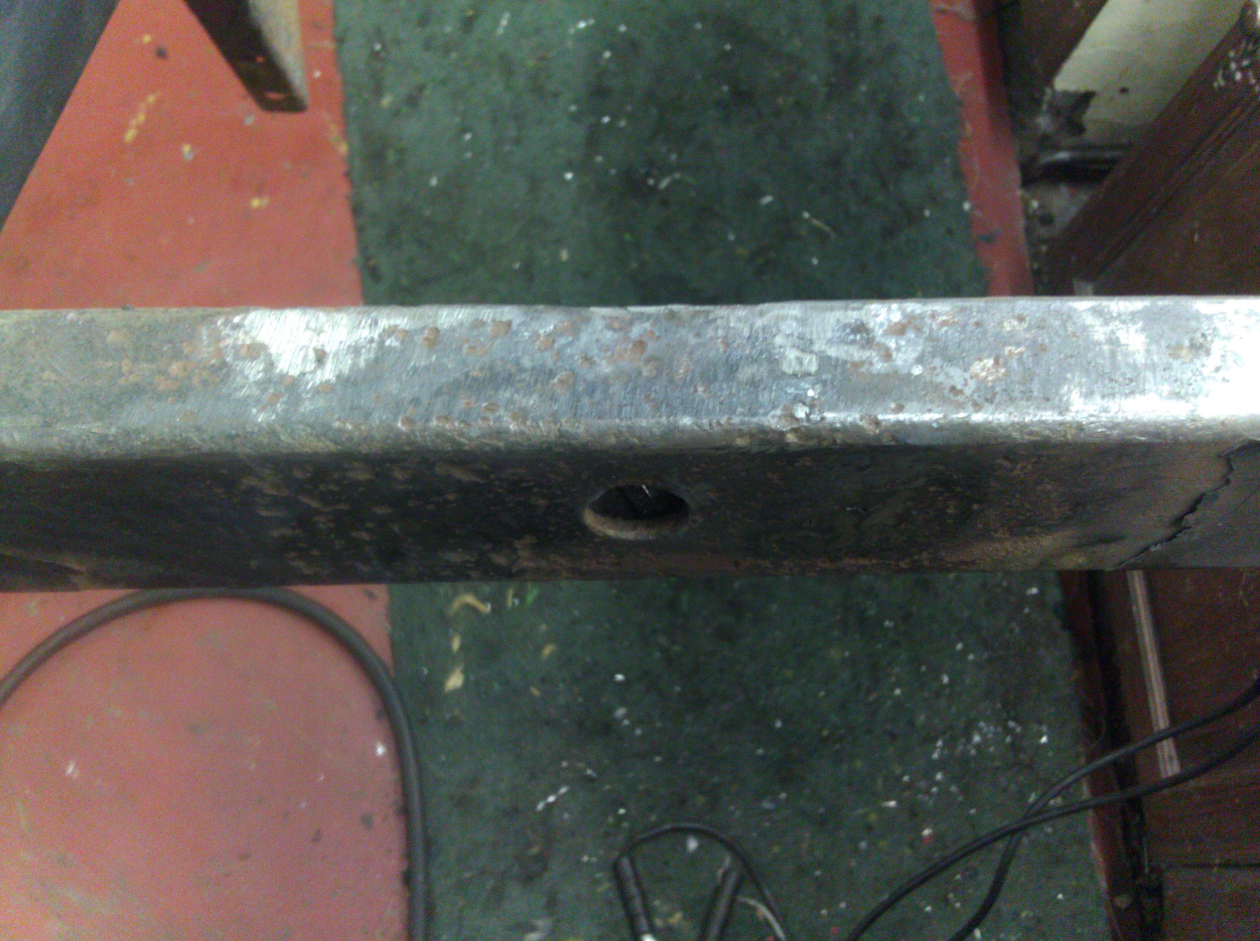

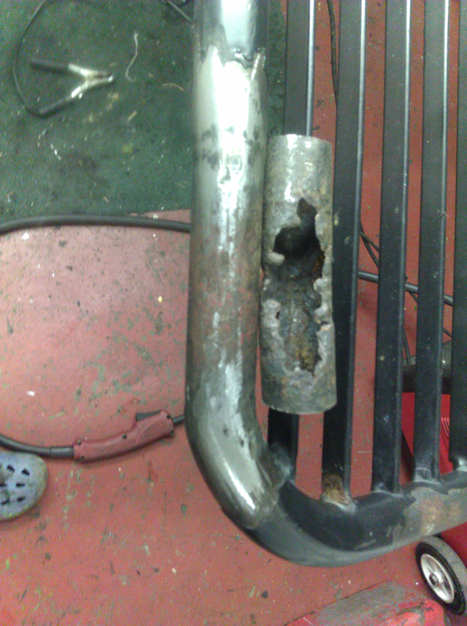

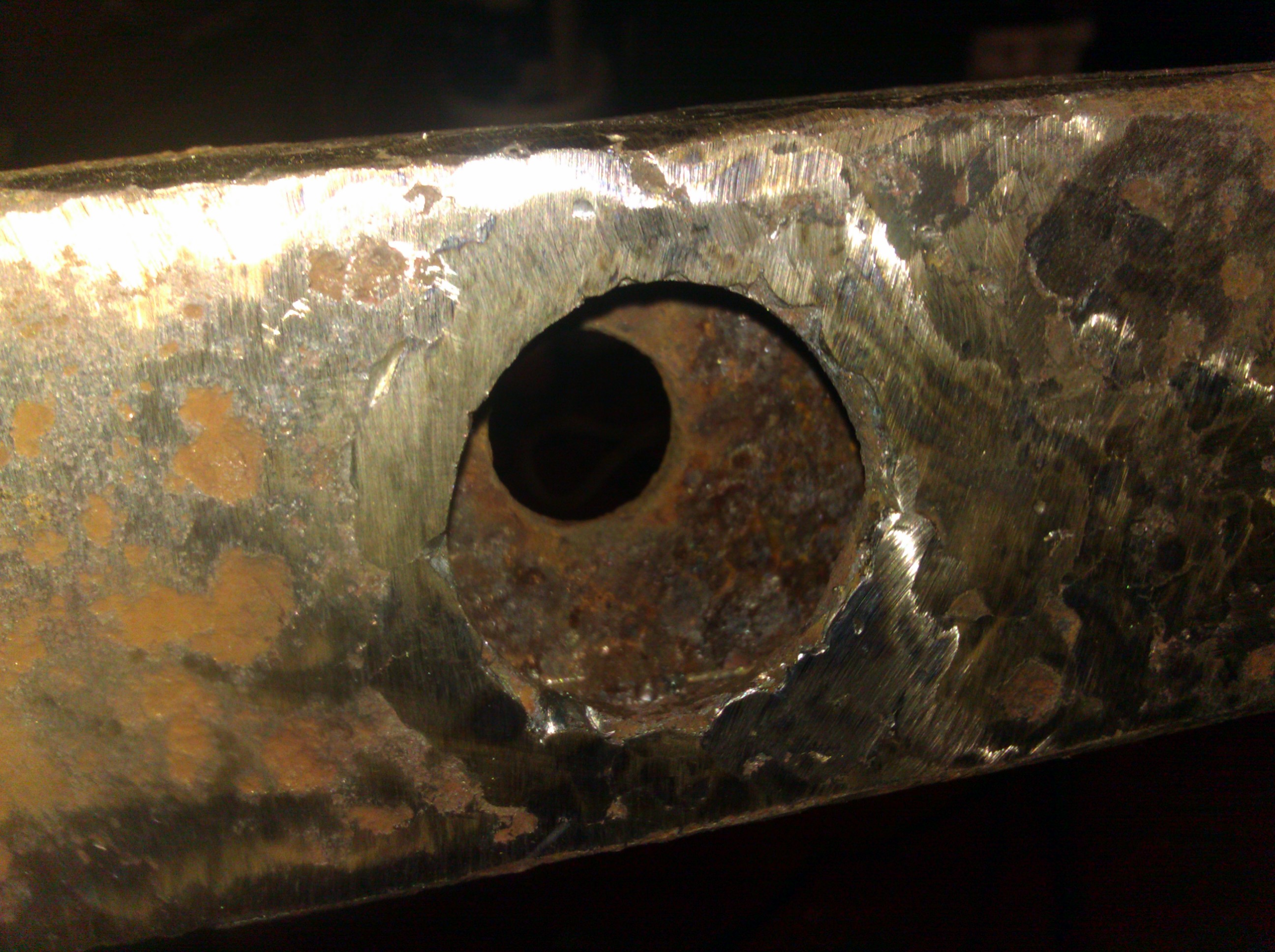

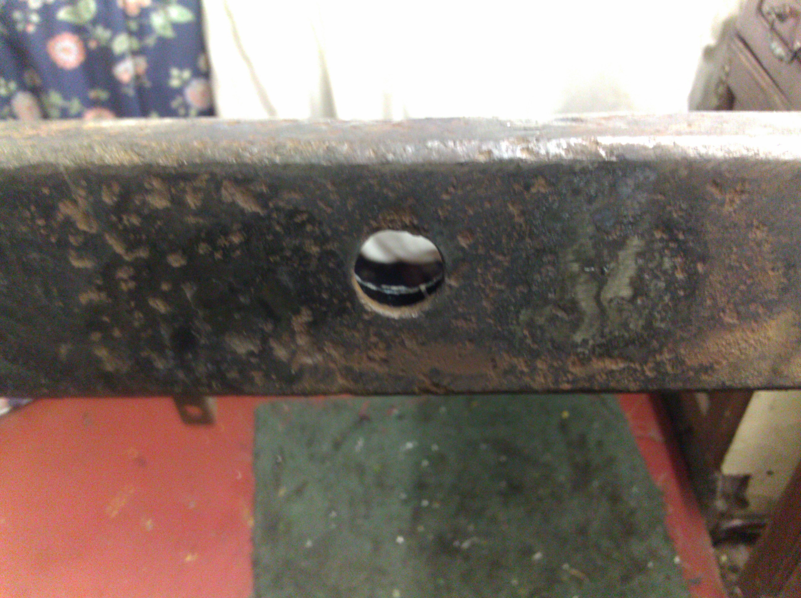

and this is what i have been busy fixing: (with thanks to @purple haze)
attachment.php
attachment.php
attachment.php
attachment.php
attachment.php
attachment.php
attachment.php
attachment.php

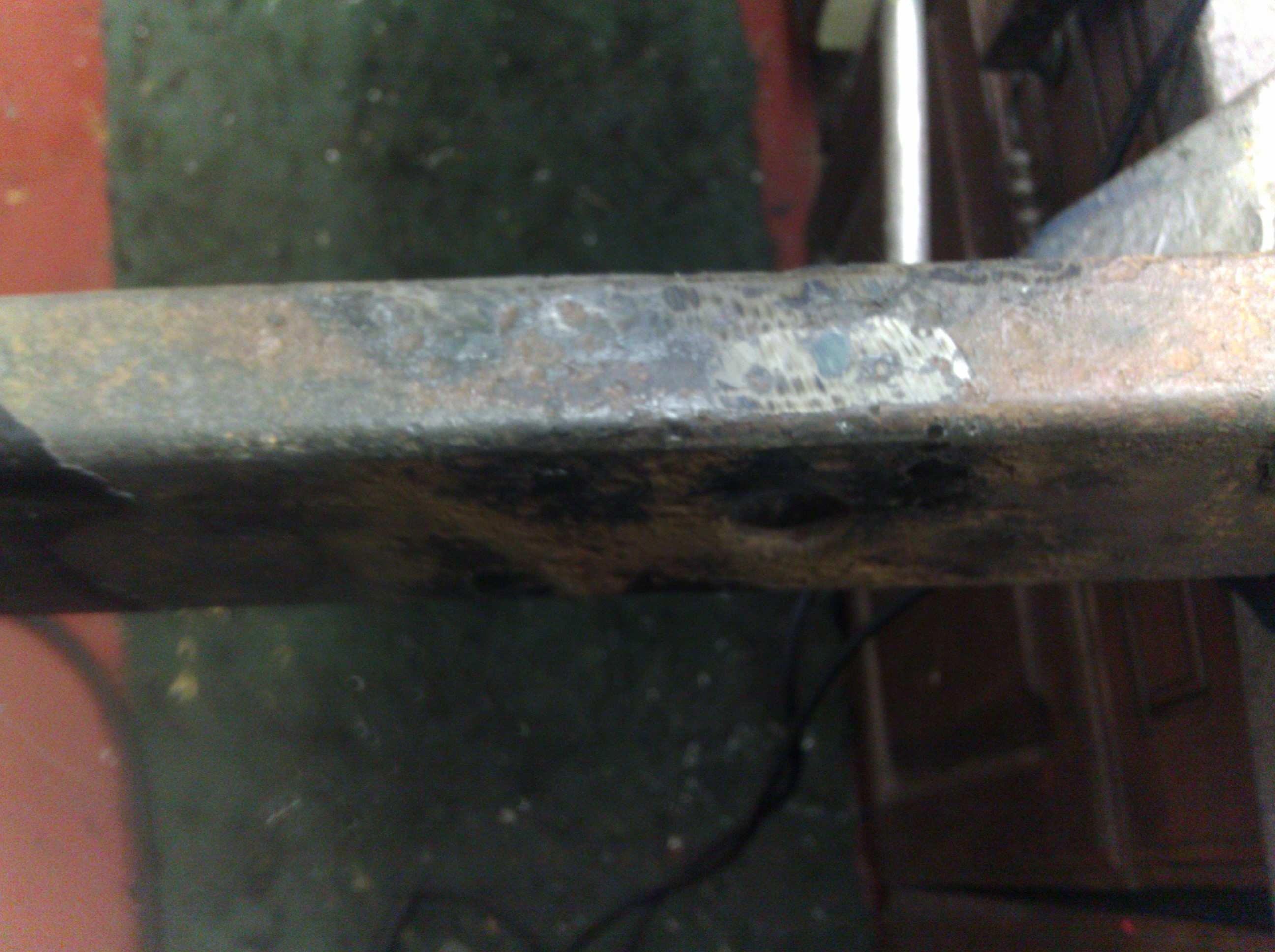

i am not too sure, i would like to paint them in a way where if they get scratched, the water wont get under the paint and lift it... quickly. (as i know it cant be helped)
what would you guys suggest? i was thinking of getting them powder coated... given i need the wheels and light grills powder coated too.
I think I would use epoxy mastic, the same stuff I used on the front suspension of my Mk1. The problem with powder coating is it is easily chipped in my experience and once it has happened you can't properly touch it up so you end up with water behind it and you are back to sqaure one.
The epoxy mastic is a two pack paint so it is very tough once hardened, much better than Hammerite or anything like that. Looks best sprayed but you could brush it on, and if you do chip or scratch it you can easily touch it up. I would still get the bullbar blasted beforehand as the cleaner the surface the better it will be though.
http://www.rust.co.uk/products/category/28117/epoxy-mastic-rust-proofing-chassis-paint/
