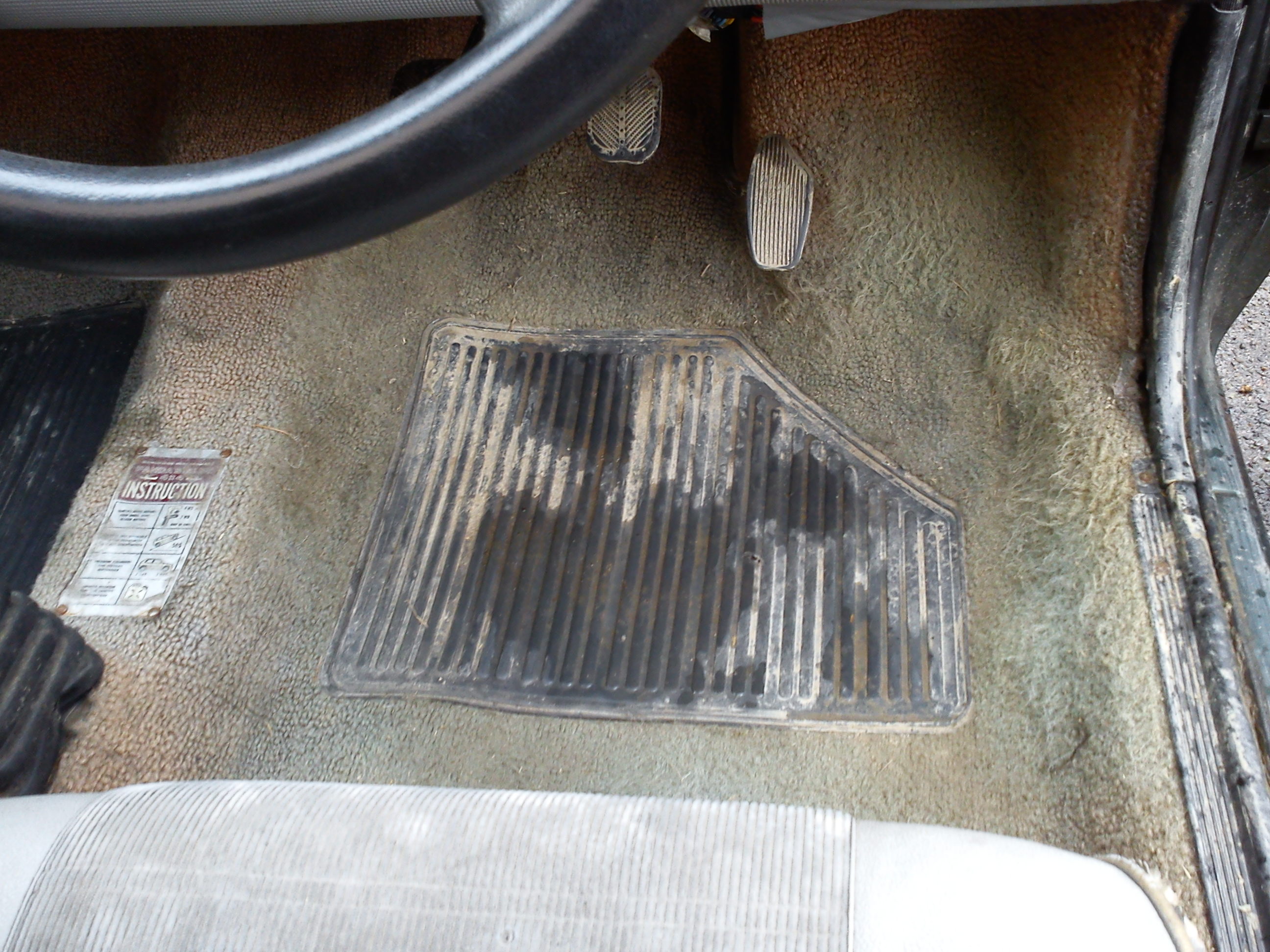

ahh yes, the interior.. heres some pictures:
attachment.php
attachment.php
attachment.php
attachment.php
attachment.php
attachment.php
attachment.php
attachment.php
attachment.php
Ive already given it a hoover out, but i have yet to attack it with the Vax. i reckon with some soapy water and a soft brush ill be able to lift the dirt from the seats and they will come up a treat!

yeah this is my intention, i will attack it with the invisible thread then stick some pod speakers in it.
you dont happen to know if any other filler cap from other fiats fit the panda do you?
