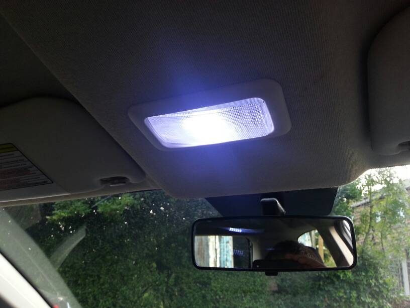

Thanks mate i have sorted it and managed to also daisy chain 2 24smb led lights into the interior light and its SUPER BRIGHT ! so well happy with the finished product
Here is how bright the light is in broad daylight !
Will get one in the dark later :)

And this is the view in the dark !
Only one problem !
The lights will not come on when I open the door ?? Any ideas anyone ?

Jealous of that! What LEDs are they please?
Edit - I've found them, I'm going to order some SMD ones as they seem to distribute the light a lot better
Have you tried putting the old bulb back in for 2 minutes to test if it works again, it could just be the bulb doesn't function in the way the old ones does. Not sure if thats how bulbs can react, but worth finding out, atleast you'll know if you broke something or not...
Ill give that a go tonight ! Its annoying me thats all
