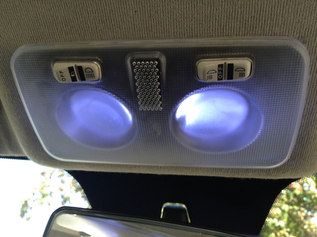

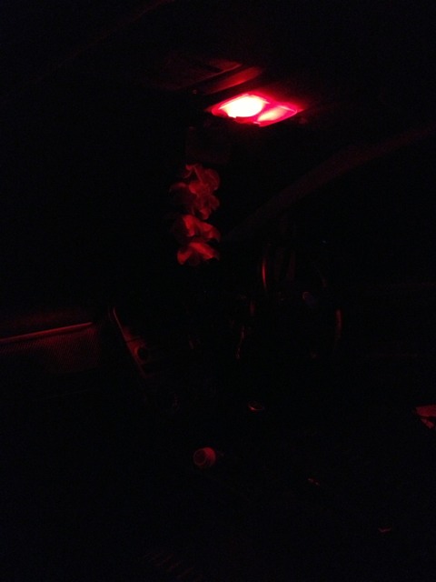

Looks sick at night!! Can't really tell from the photos tho :/ ahh well here they are:
Open my door and it lights up the path red :)
Mine should arrive tommorow i have orderd some 16smd 38mm festoons and the deal was for 2 just in case i break one.
Blue 16 LED, will post pictures as soon as they are fitted should be tommorrow night and by looking at your interior light Wisey it looks like a different shape to the one i have in my interior.
WillGP you'll be getting two because there's two in the actual light, unless as you've said it's a different fitting? :s post up a pic when it's done m8 :)

I think the lights are slightly different across the different years of GP. Mine is a 60 plate, but was a clearance one as the Evo was the then model. I'm assuming the 2013+ GP is somewhat different still.
I got two in the package i bought for a fiver. My GP still only has one bulb in though...

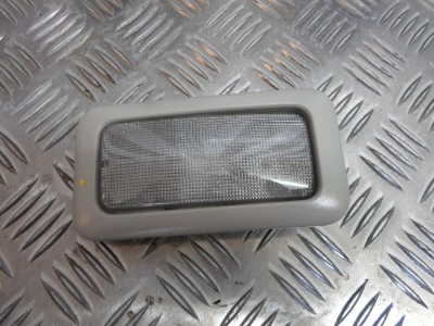

I have the light that is shown on the following link, there is only 1 hole on the rear of the light.
This is the light i have and i only have on festoon within the light.
Yeah, pretty sure thats same as one i have fitted in my car, only has spot for one bulb :) I know some of the later Punto's have two separate facing lights up on the centre console above.
