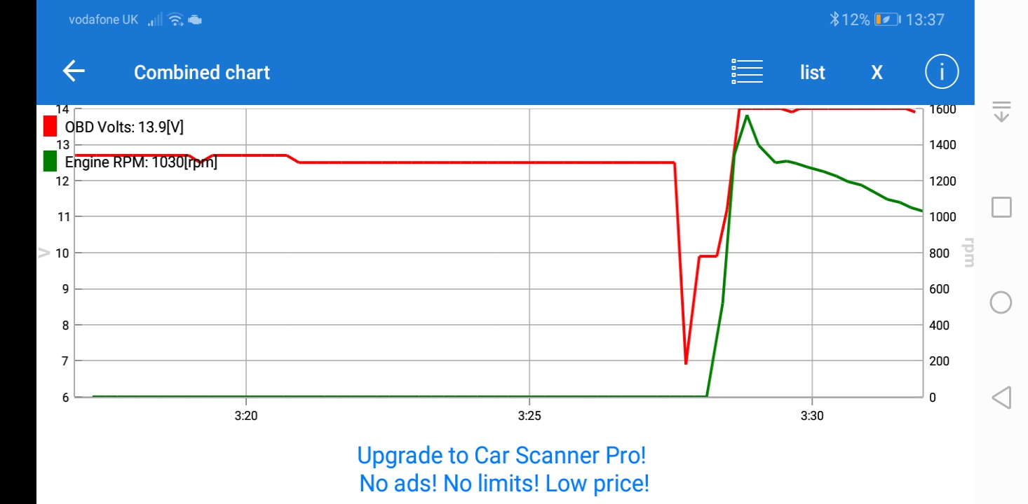

MultiECUscan let's you log the ECU battery voltage, what's it saying at ignition on and while running
Here's mine logged
Here's mine logged
