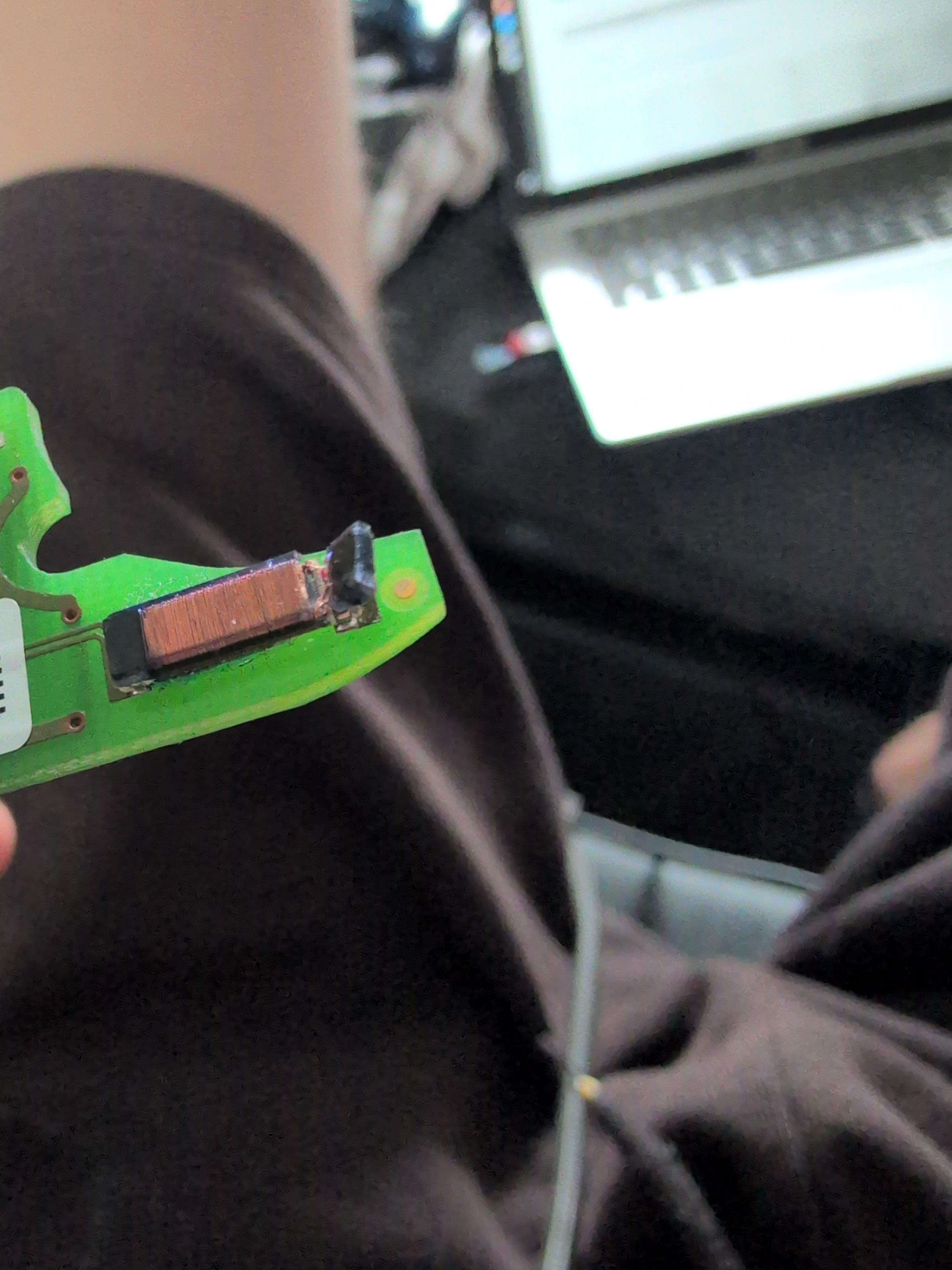

I currently have an issue with immobilizer light staying on

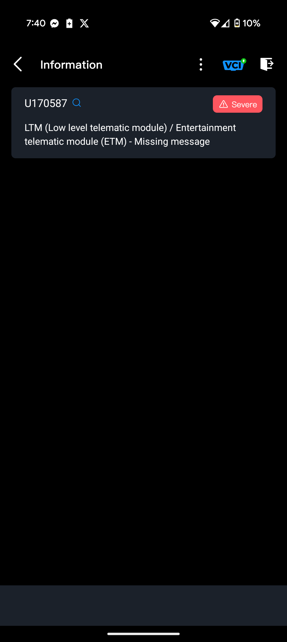

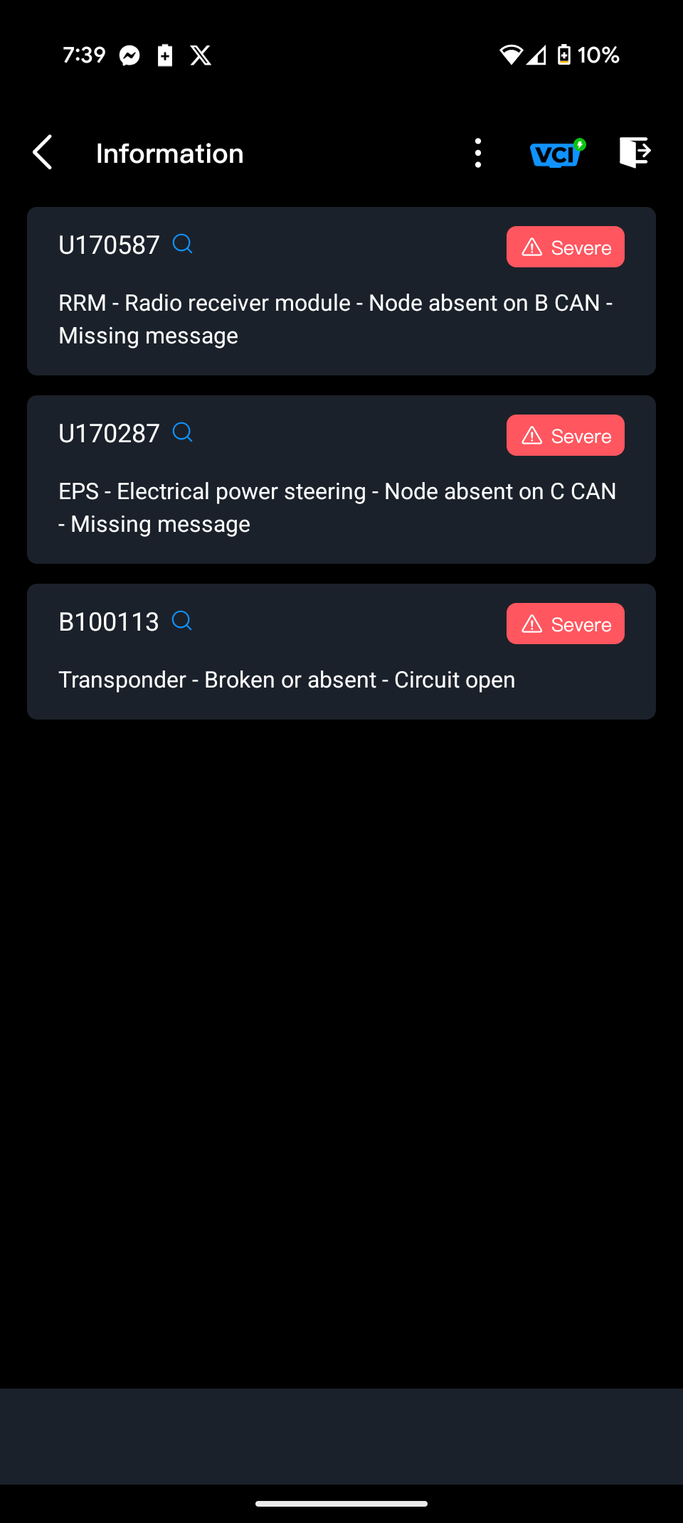

I have a 200i Fiat punto and immobilizer light stays on I have ran diagnostics and found some codes in the attachments
Any help / suggestions welcome
Thank you
The B code means the chip in your key isn't being recognised
Worth trying a few things like removing other keys,
and ensuring car battery is fully charged
(potentially Low due to Blue and Me issue)
Would recoding the same key to the car be worth a shot? I've not tried charging it but if I turn the car over just before the immobilizer light comes on it cranks well
