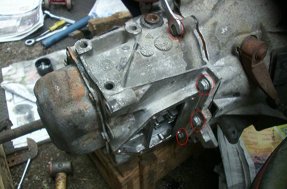

You can do this job by only removing the small bolt on gearbox while leaving the part with the clutch on the car. The clutch can be inspected thru the opening in the bell housing. I suppose as a trainee mechanic you want to take the car apart but its a mission to get the struts off the hubs and everything else compared to just taking the box off
