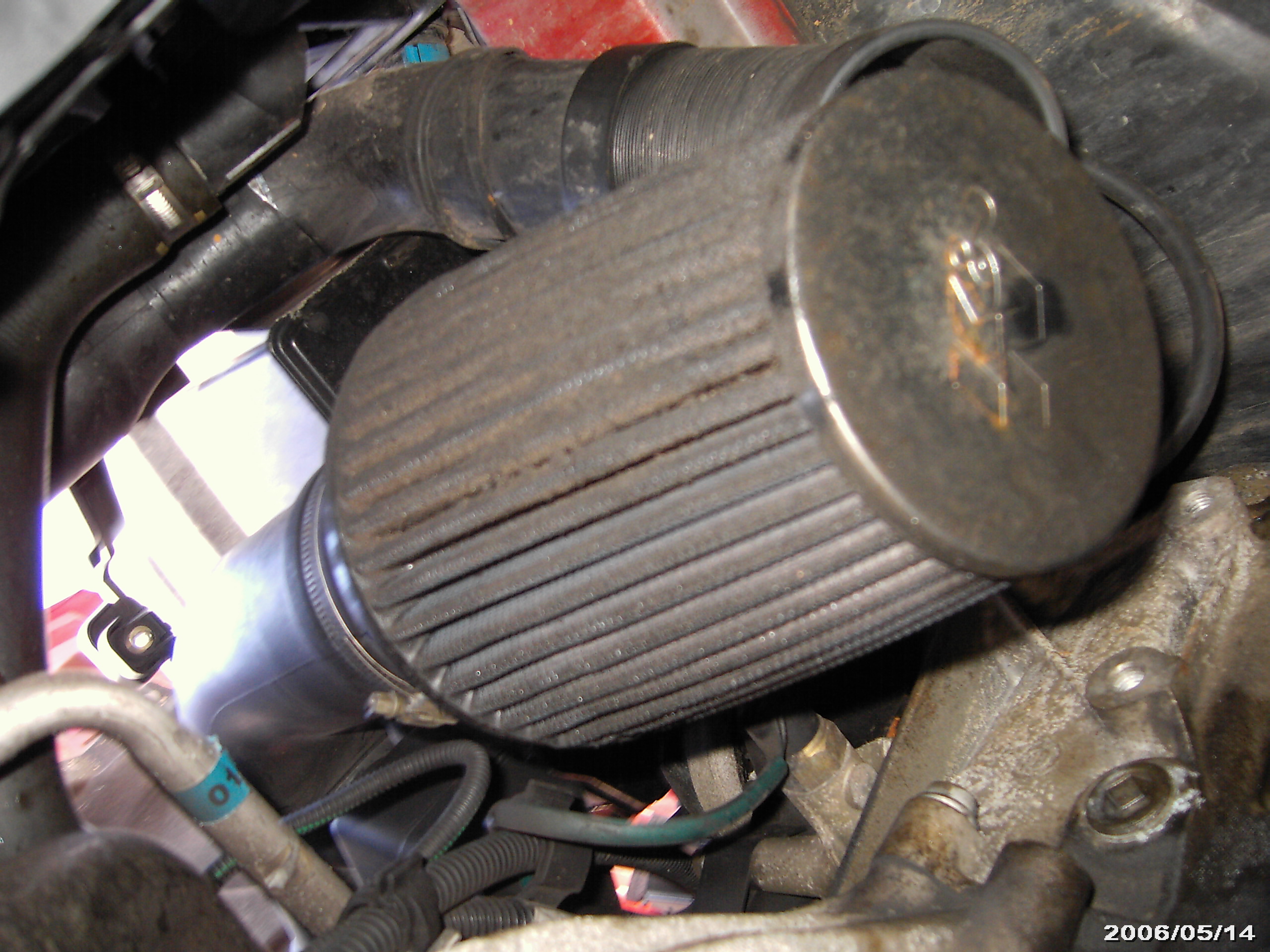

Well, it's still missing after disconnecting and reconnecting the battery. Not been able to get in about it yet so see what type of kit it is but felt about the air filter and it's pretty dirty. Would I need to find out what induction kit it is and match the air filter to replace it, or would a standard Fiat one do?
It is a cone one yeah, I'll get a pic of it up today. Got to get a couple of things done first but be up asap.
With this type of filter IE- cone and twin cone you should be able to clean and replace it and some of them need re-oiling now if its the sponge type then dump it and replace it with a cotton or stainless mesh type I'm going to stick my neck out here a guess its the K&N one and if it is you can clean it and refit it (y)
Right, just crawled out from underneath- It is a K&N kit, there's a couple of pictures attached to this. (ignore the date stamp on the pics, the camera isn't set up right)
Just take it off, clean the li' bugger out and refit it?
Looks like its the Typhoon kit for what it is its quite expensive I believe did you have an engine under cover to take off and put back on cos all according how low down it is in your engine bay you will want to make sure you dont suck up any water of the road I have actually sealed around mine just to make sure (y)
It is quite low, the camera taking those pics was about 2 1/2 inches off the ground (or 6 if you ask my missus :p ).
How would I seal around it?
Sorry if I'm asking daft questions here.
If you have an under tray then get some heavy duty waterproof tape and just tape over any holes and seams between the under tray and any panels that are fixed to it mine is all sealed up now and although is not 100% water tight its a lot better that it was but of course if you havnt got an under tray then I would certainly get one not only does it help with keeping your engine/gearbox clean but protects you sump and under side of the car from those dreaded speed bumps and dead bodies that are every where.:)
You need to fit your filter with the precharger: the blue cover here:
