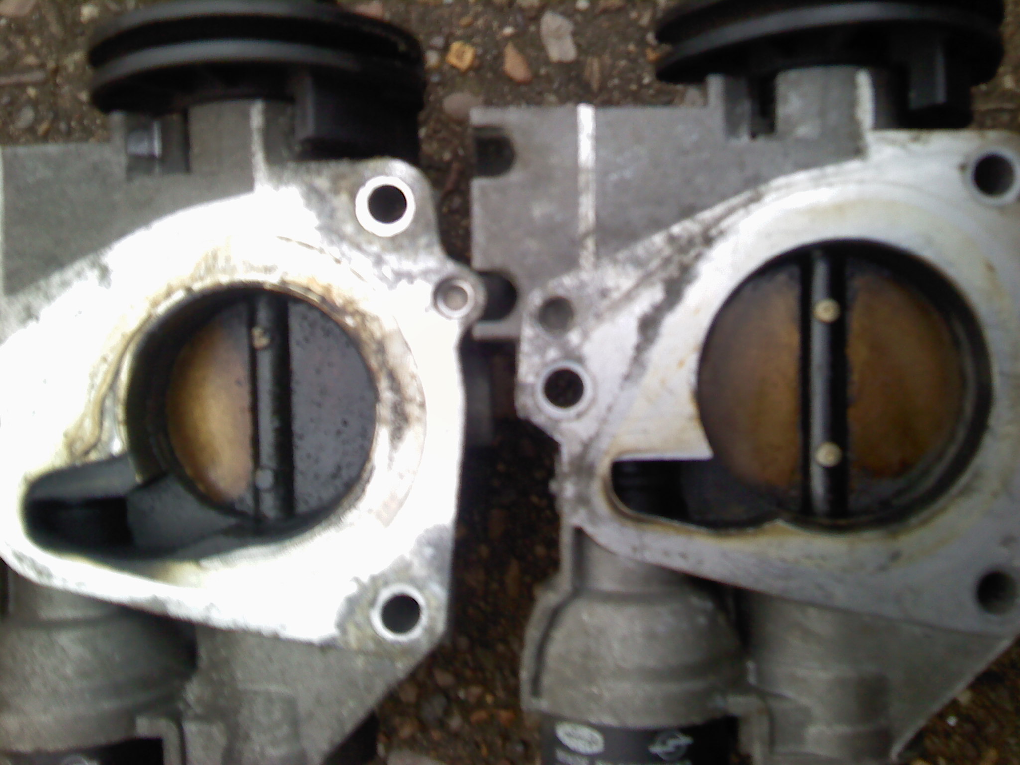

on the TB no the hgt wont fit, if you want to fit a bigger TB to the 1.2 16v you need to use the mk1 punto sporting 16v inlt as its slightly different in the way it bolt to the inlet, bravo one has a 4 bolt pattern and the mk1 punto and the 1.6 16v use a 3 bolt pattern, or vice versa. but when you do fit it you need to port match the inlet to the 1.6 TB as there is a massive difference in size between the 2 and it causes problems if you dont, i learnt this the hard way. i will try to dig out the pics now and post in abit.
on the left is the stock 1.2 16v mk1 punto sporting TB
on the right is the stock 1.6 16v marea TB
and the other pic shows the style of inlet you need

this is a better pic that shows the stud pattern better
what i would say is if you intend on using this TB i would try to find a set of injectors that are slightly biger as this TB from what i read puts the injectors to max capabilities iirc its saxo vts injectors you will need as they are 40cc up on the stock 1242 16v injectors
