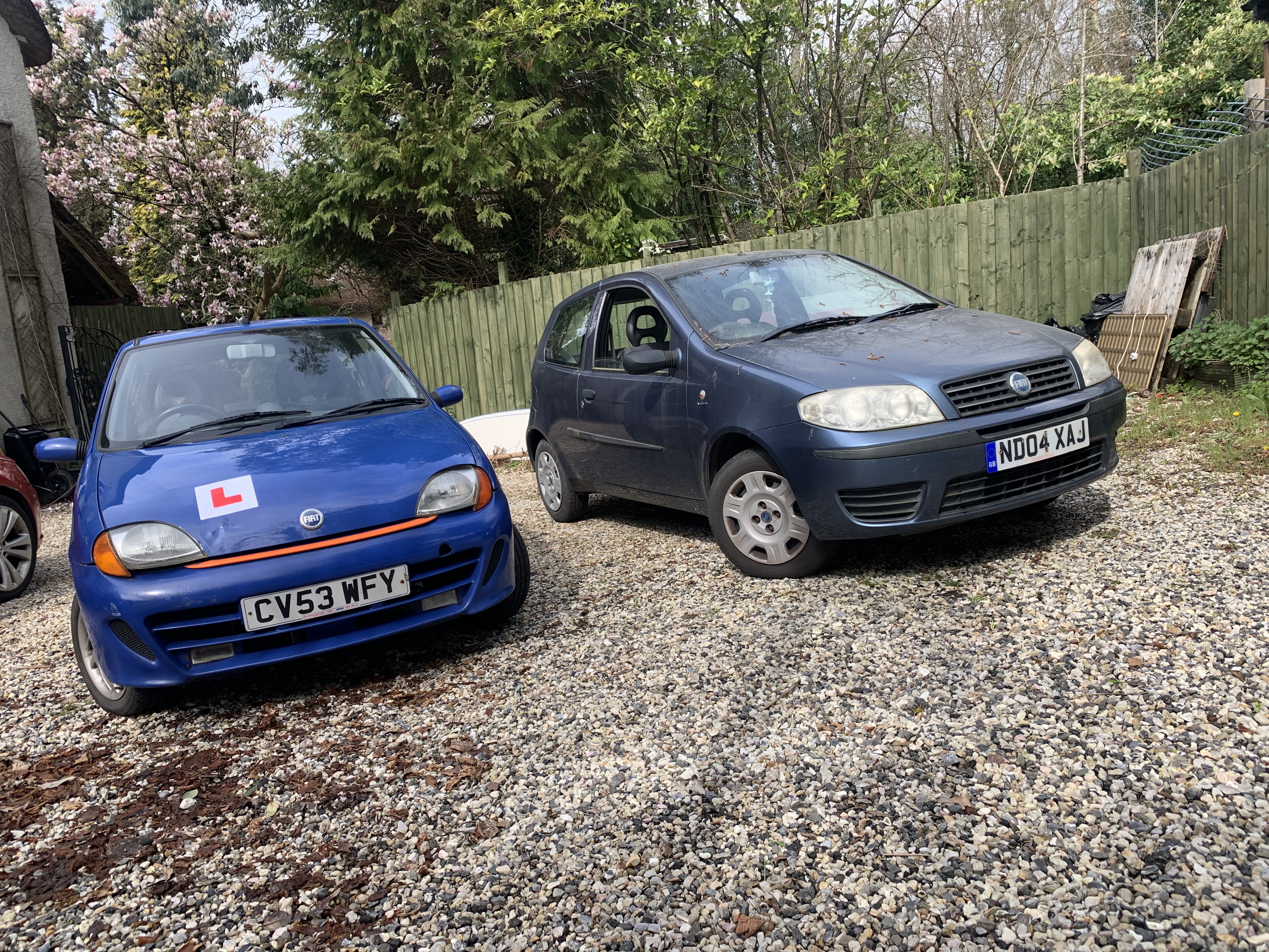

So on my cousins mk2b punto (in the photo) it’s been parked up since august last year we put a battery in it. It started up however with the engine not running and with the ignition on. The horn is constantly on unless the negative battery terminal is disconnected. It also has an intermittent power steering issue, it cuts out and the steering light comes on the dashboard.
The antenna base is damaged and most likely has let water in.
The antenna base is damaged and most likely has let water in.View attachment 420952
