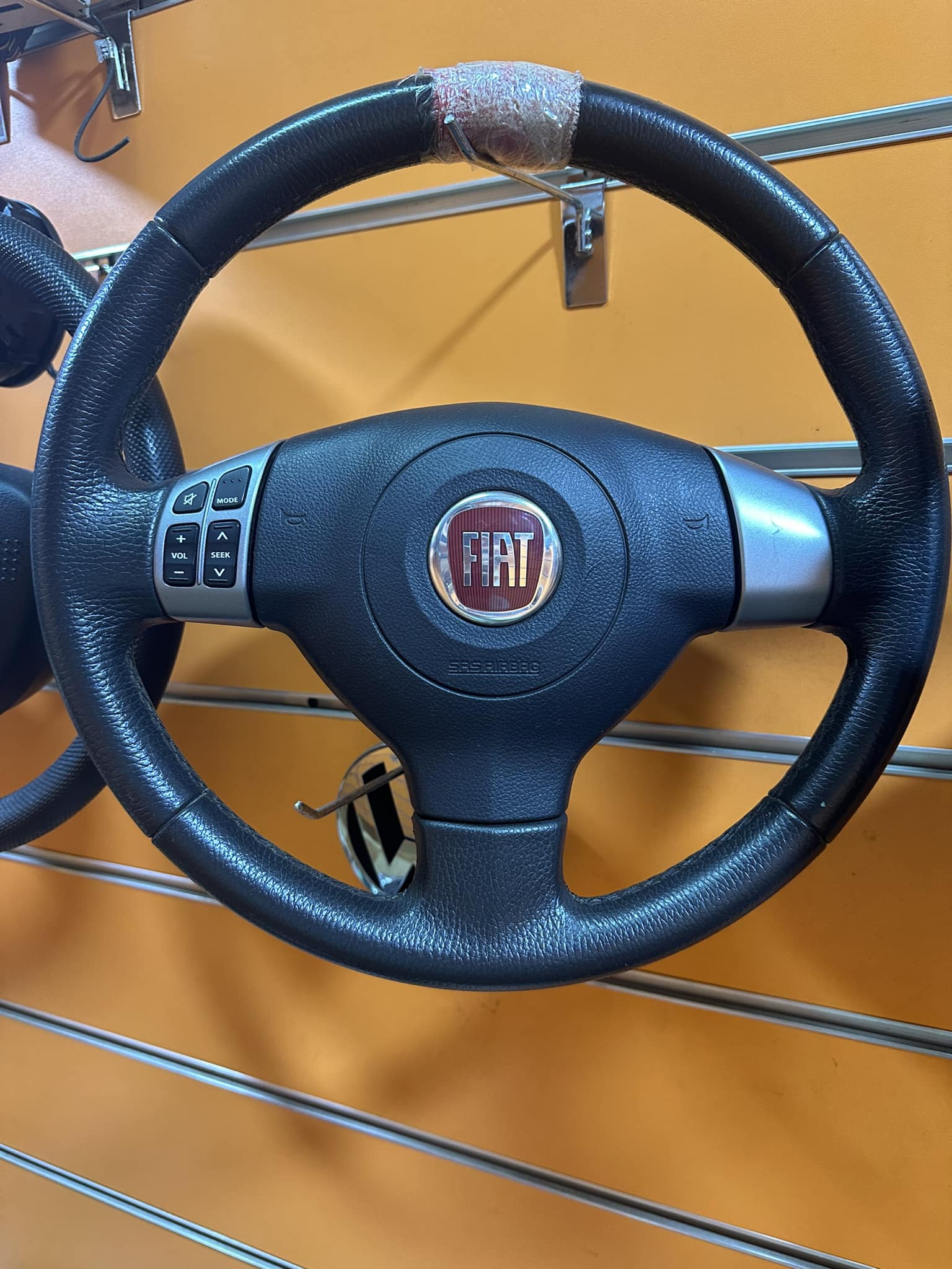

i bought a Fiat Sedici Steering Wheel for my punto - the only problem is the multimedia keys not working no wiring for them in the car - so i don't know what to do from here :unsure:

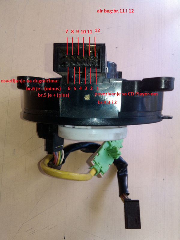

I had to get a clock spring—in my case, for an Alfa 147—but it must be from a car that originally had commands. You will also need a connector that goes to the clock spring. In my case, I had to add three wires for the steering wheel commands, one positive wire for lighting up buttons, a negative wire (the same one as the negative for the horn), a positive wire for the horn, and two wires for the airbag. If your connector looks like this, I can help with the pinout. If not, you should get a wiring diagram.

Hi Stfakdj, if you have the pinout diagram or the 147 wiring diagram for the steering wheel controls id appreciate having a look. I got my 147 controls working but it was by trial and error and educated guess work as had to move a couple of pin positions on the clockspring plug. I still needed an adapter box to make it work with my Sony radio though. Would be interesting to see what changes I actually made.

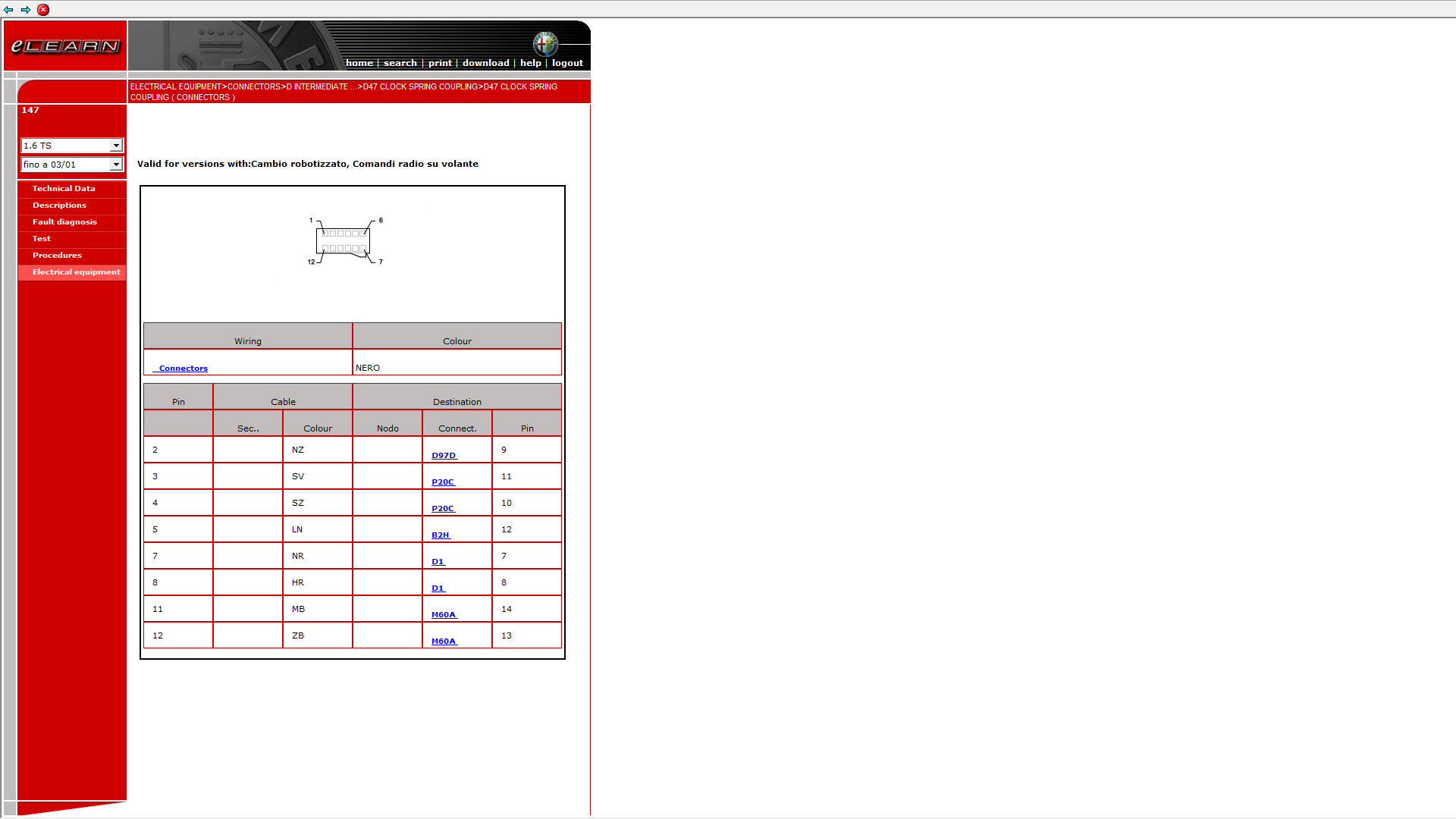

This is from eLearn and not that useful, but I can help. Airbag wires are 11 and 12. For button lighting, 6 is negative and 5 is positive. The horn uses 6 as negative as well and 1 for positive. The wires that go to the radio are 2, 3, and 4. These numbers are from the picture above(not the eLearn). Also, I would suggest getting an Android multimedia system—you don't need any specific adapters.

I tried a different stalk, and the trip button doesn’t work, but the steering wheel and multimedia work great. Here are some pics:
P.S. I still need to replace the buttons and logo on the steering wheel.
