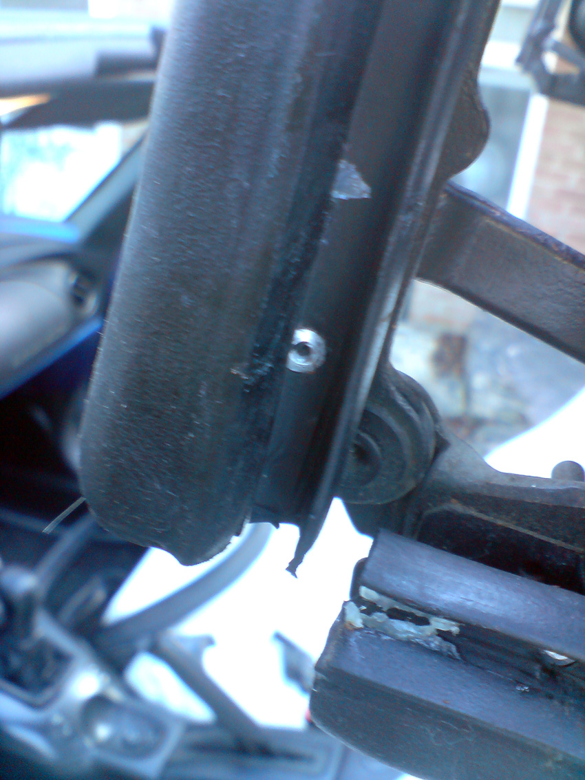

It has been a while since I removed hood rubbers but I thought it would be easy enough. Just remove the little screws and gently slide them off. I had a day off work yesterday and time before my trip to Babies R Us, so I went out to the B to get started. Unless I am being stupid (and this could be the case), it looks as if the man who fitted my hood has riveted the rubbers on instead of using the screws. I have shown a picture of what I mean.
Can anyone give me an idea of where I have gone wrong or what I can do next? If he really riveted the rubbers on I will be really mad.

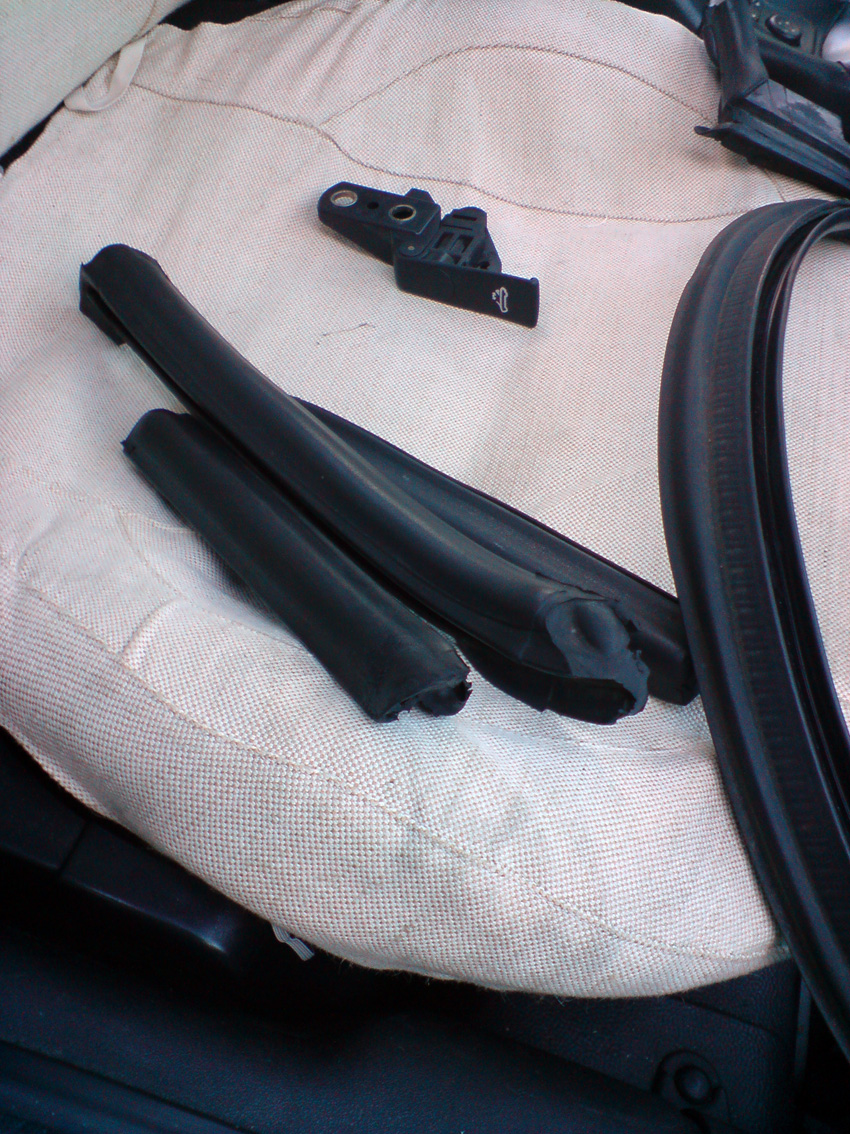

My new goodies have arrived! Rubbers for the drivers side and a rubber for the tonneau compartment.

Is that a rivet I can see? I am sure small screws used to be there. Could anyone really be that stupid or is it me?

It's a rivet, you'll have fun drilling them out and then finding a fat enough screw to refit the new rubbers. I envy you though, I keep on asking Father Christmas for new rubbers but so far no luck, not even the Durex kind.
who put rivets there? or anywhere else... i hate them. those little pain makers devils.
