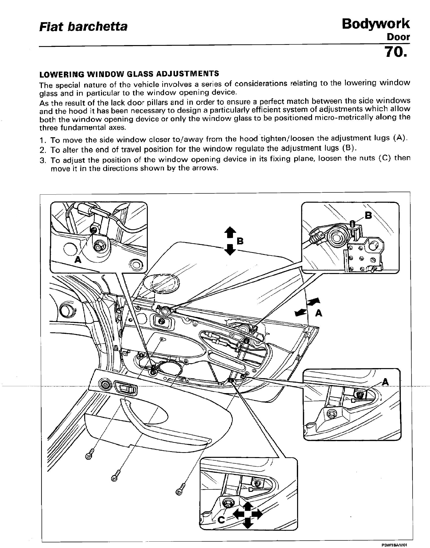

As I said here is the pic you need. You will have to take the inner panel off and the top metal bar that is screwed in by 2 screws that is next to the window to have access to some of the ajustment screws.
You will need to move the window up down to access ajustmet screw as well. Take your time as some of the screws may be tight and need some oil. Hope it helps if you need help pm me.

Hey all, I got into my B after a downpour the other day and there was enough water in it to drown me! So I descided to regulate the windows, well the driver's side window. It was not too difficult thing to do, I followed the guide on how to remove the door trim that is in the forum, and then the graph above to see figure out how to do it. The whole thing took me no more than half hour at best! I drove the B down to Athens today and she was excellent!!! it rained heavily on the way and no water on me! One thing that needs fixing though is the windows moving outwards a tiny bit above 170 Kmh and as every smoker knows closing it at high speed after a smoke and the window not fitting properly.
I order one of the window gizmos from Henk, as soon as i fit it I will let you know how it works. Speaking of which anyone had any luck translating the Dutch instructions?
