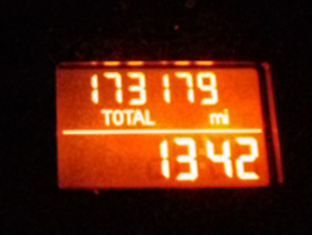

173179. 53 reg yellow Panda Dynamic 1.2. Failed MOT corrosion. Going to scrapyard tomorrow.
I bought the car 10 years ago for £1650 with 71k on the clock. Apart from service items it has had a sump, clutch and 2 window regulators.
