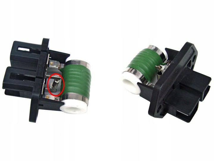

And that can happen if the thermic fuse on the fan is burned. Then the fan won't operate on 1st speed, only on 2nd speed, but fan kicks in on second speed when the temperature and pressure are higher than normal inside cooling system. I don't know if that can cause the engine to cut out but it is possible. And that is definitely the correlation between the two systems.
So check the thermic fuse. It is located on the radiator fan, has the 2 wires connected to it.

The thermic fuse I'm talking about is on the resistor @koalar mentioned, part number 71740060. Inside of it, on the 1st speed circuit there is this safety thing, thermic fuse, it blows if temperature on it goes above 125⁰C. It's this one in the picture.
When that fuse is ok it has continuity through it, so is easy to test.
The fan's 2nd speed circuit has no fuse on it and it kicks in when the coolant temperature is on the higher side. Not overheated, because that's the role of the fan, to prevent overheating, but on the high side. ECU doesn't know if the thermic fuse is blown, it feeds voltage to 1st speed circuit and then, considering rising temperature feeds the 2nd speed.
I thought this is worth mentioning and Tony should check that circuit, to be on the safe side. If you have MultiEcuScan is easy to check, you can start the fan by it, with engine off, speed 1 or 2 and see if it runs. There is another detail that I've noticed, if you are aware of it you'll know if the thermic fuse is blown or working. On hot summer days when you run the car with AC on, after you stop the engine you will hear the fan is still running, it runs on 1st speed for about 20~30 seconds. If when turning the engine off fan is not running, total silence, means the thermic fuse is blown.
