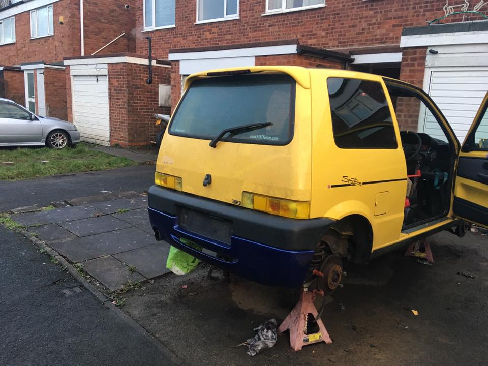

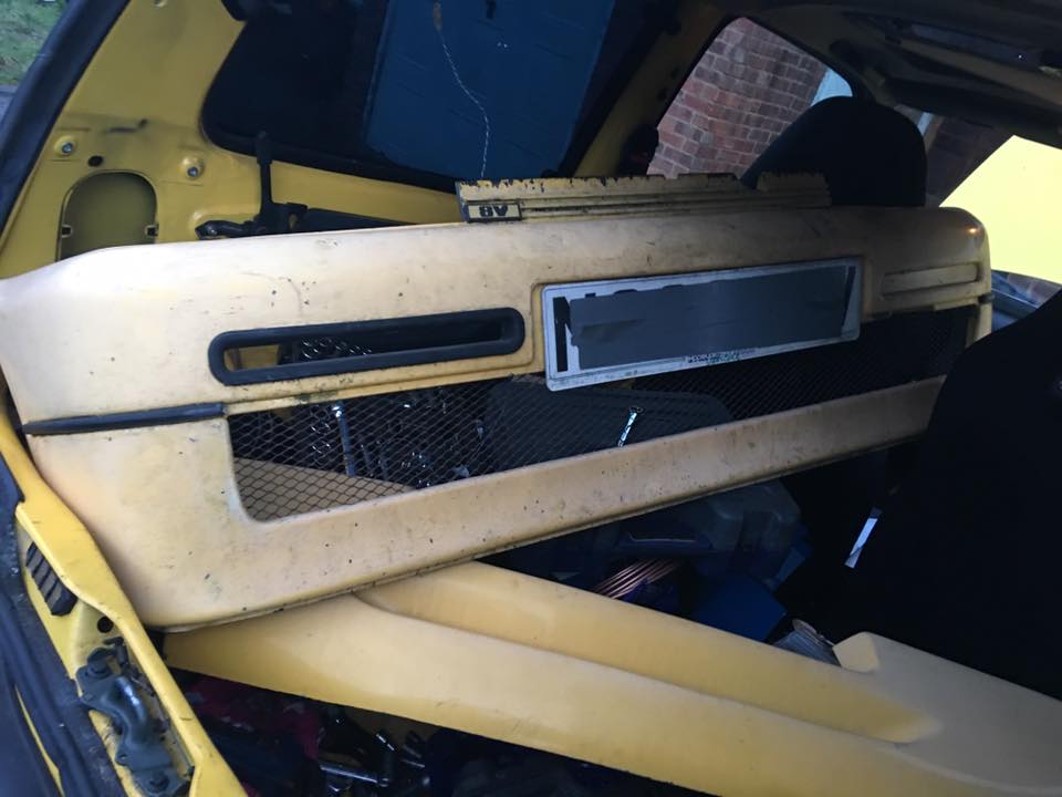

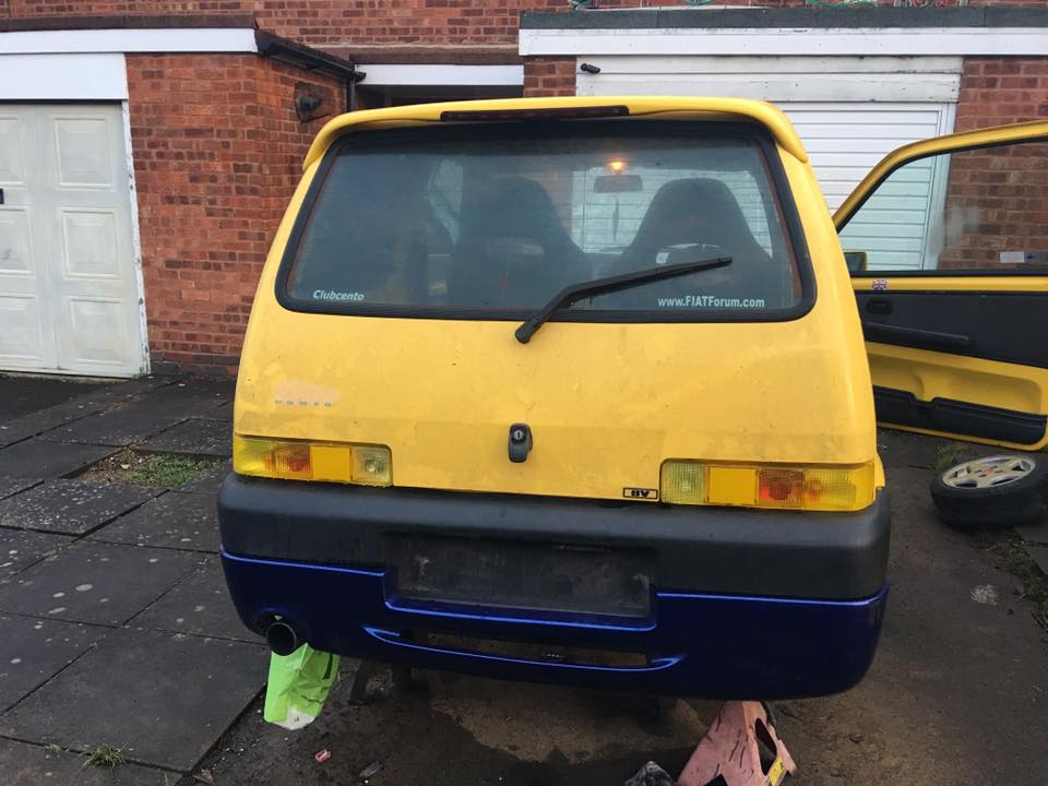

picked up my spoiler and a few other parts for both cinqs you'll see what im doing with the parts on the future so cheers steaderz for the parts off chii
so got the boot and spoiler on
chii's front bumper will be going on with my apron seemed like having a yellow bumper would be easier to paint then having to plastic prime the unpainted one ect
:eek:
Good to see bits of Chii living on. Guessing the shell has gone now :(
Re: Hensey's 1242 8v turbo build
:eek:
Yeah I think the shells gone :(
Your old speedlines and rear abarth apron made there way to my other cento I had at the time
Unfortunately the boots gone rotten at the bottom so it’s coming back off but the rear glass and spoiler will be staying
