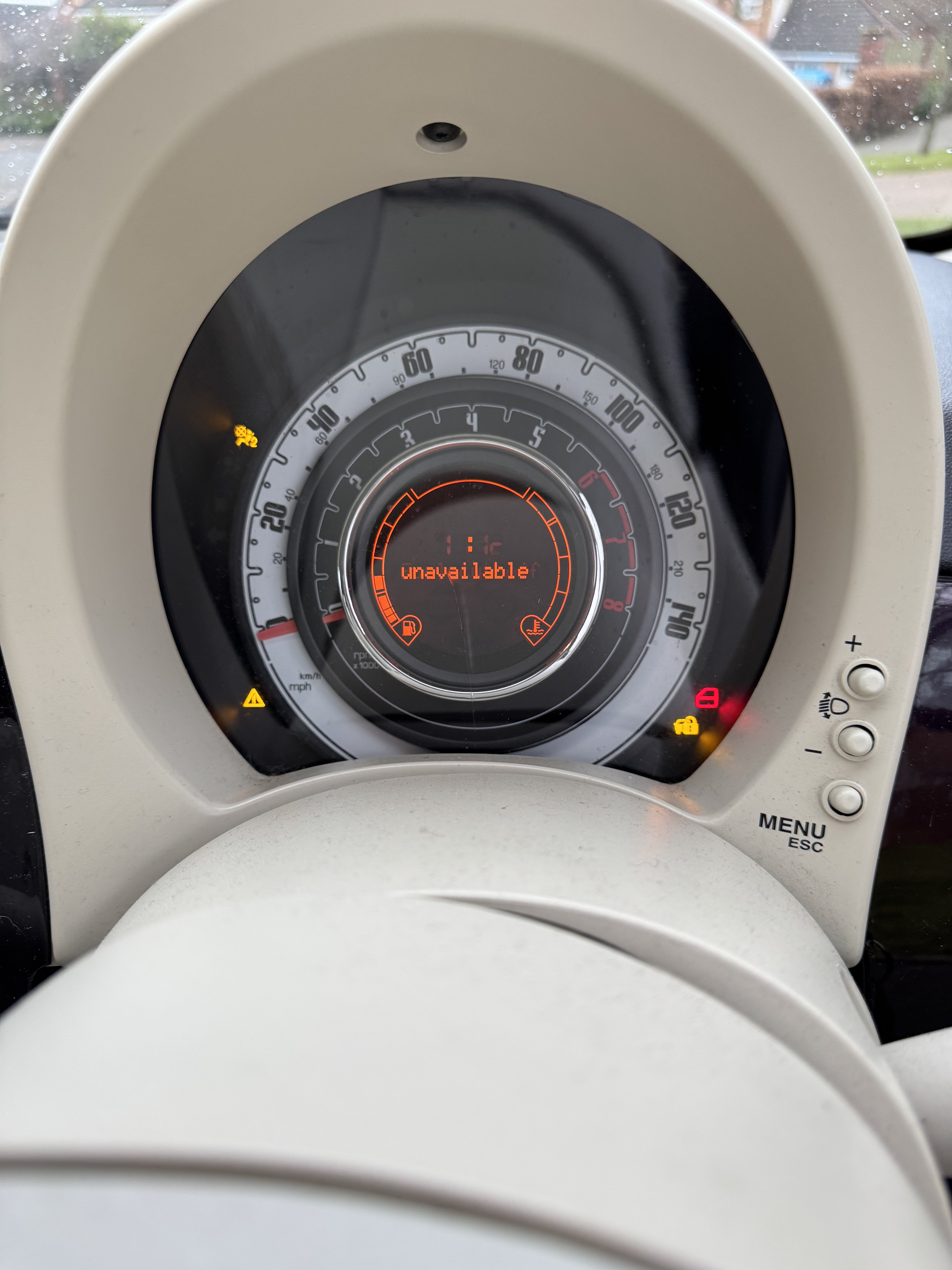

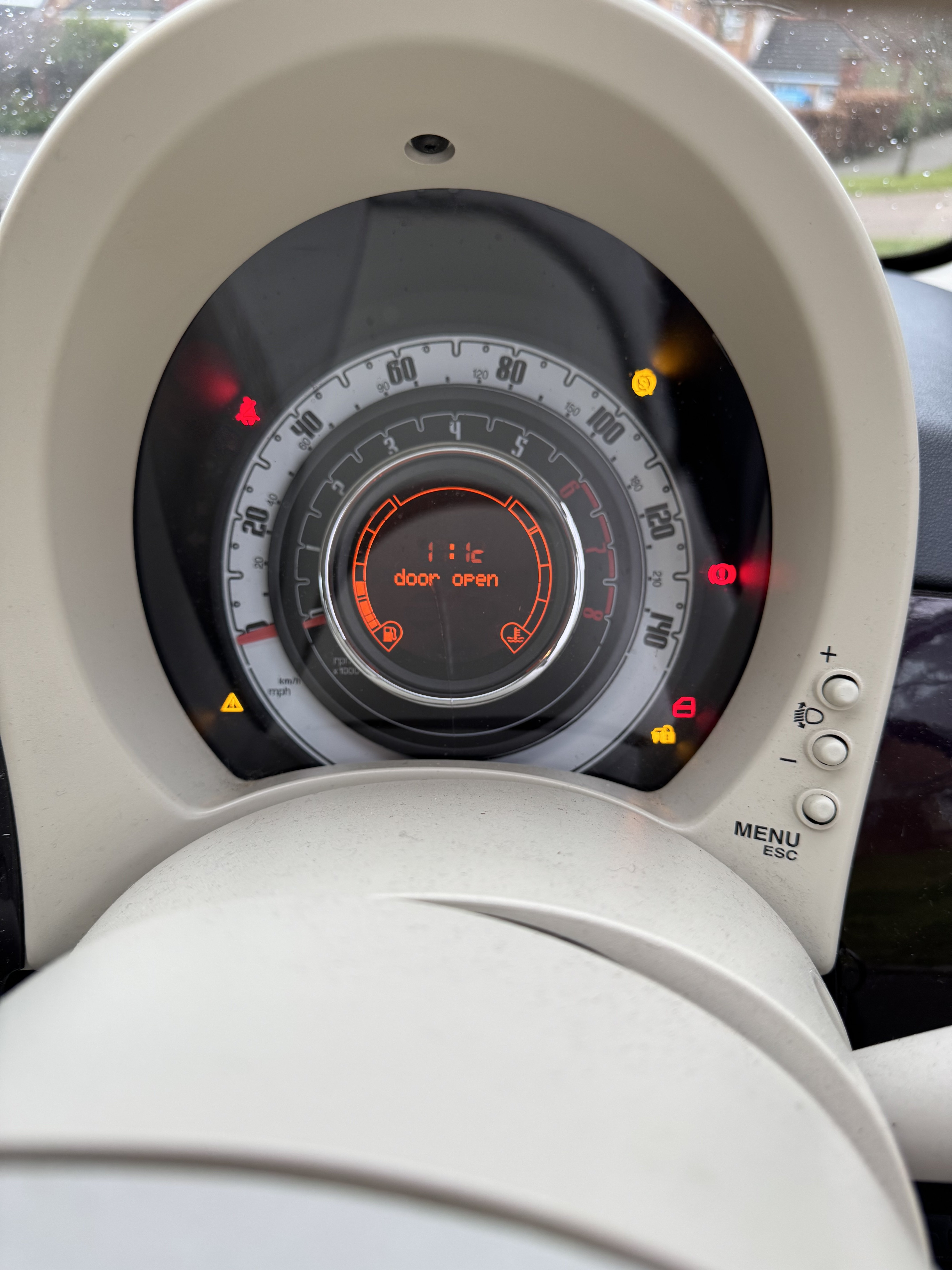

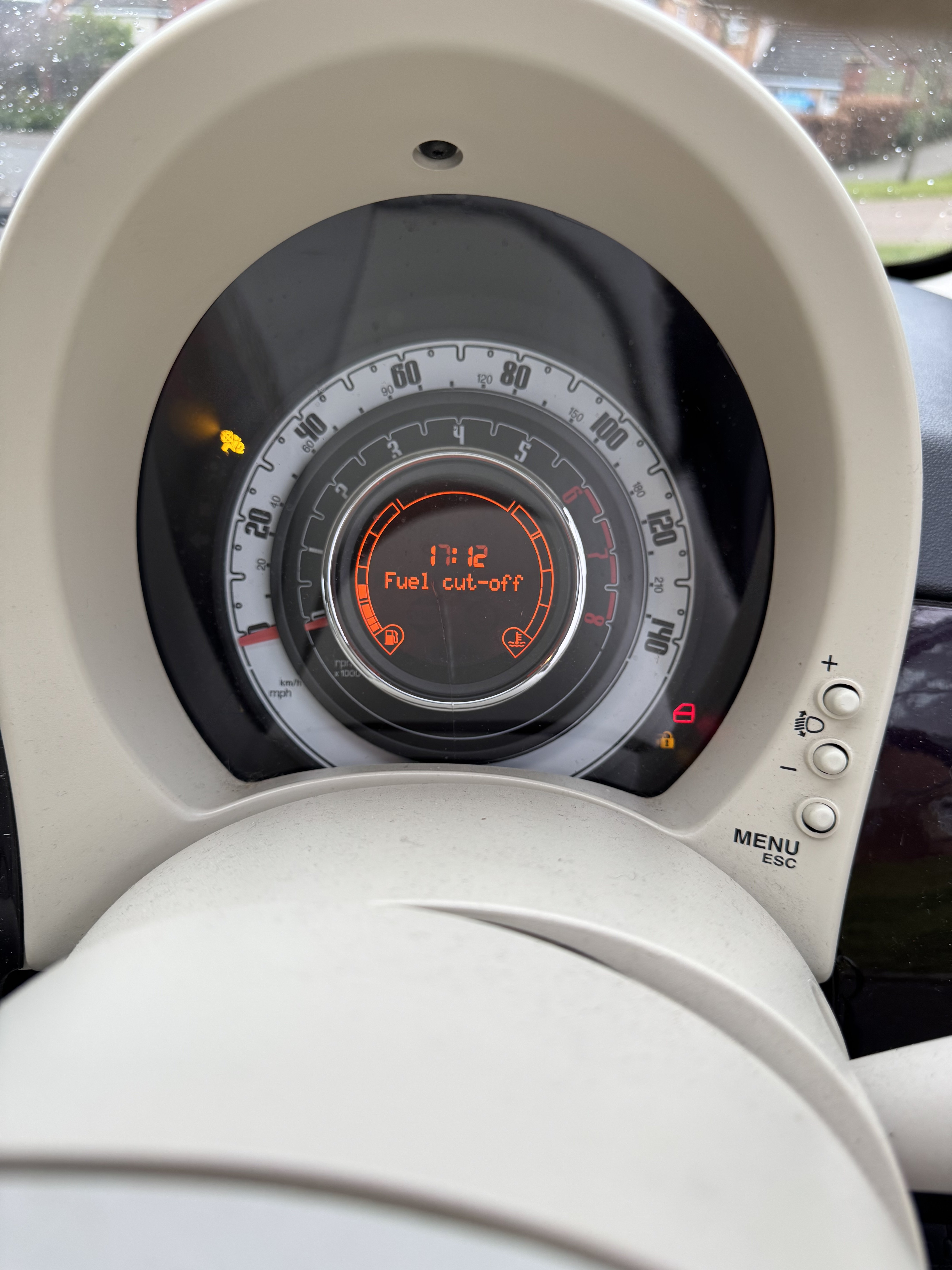

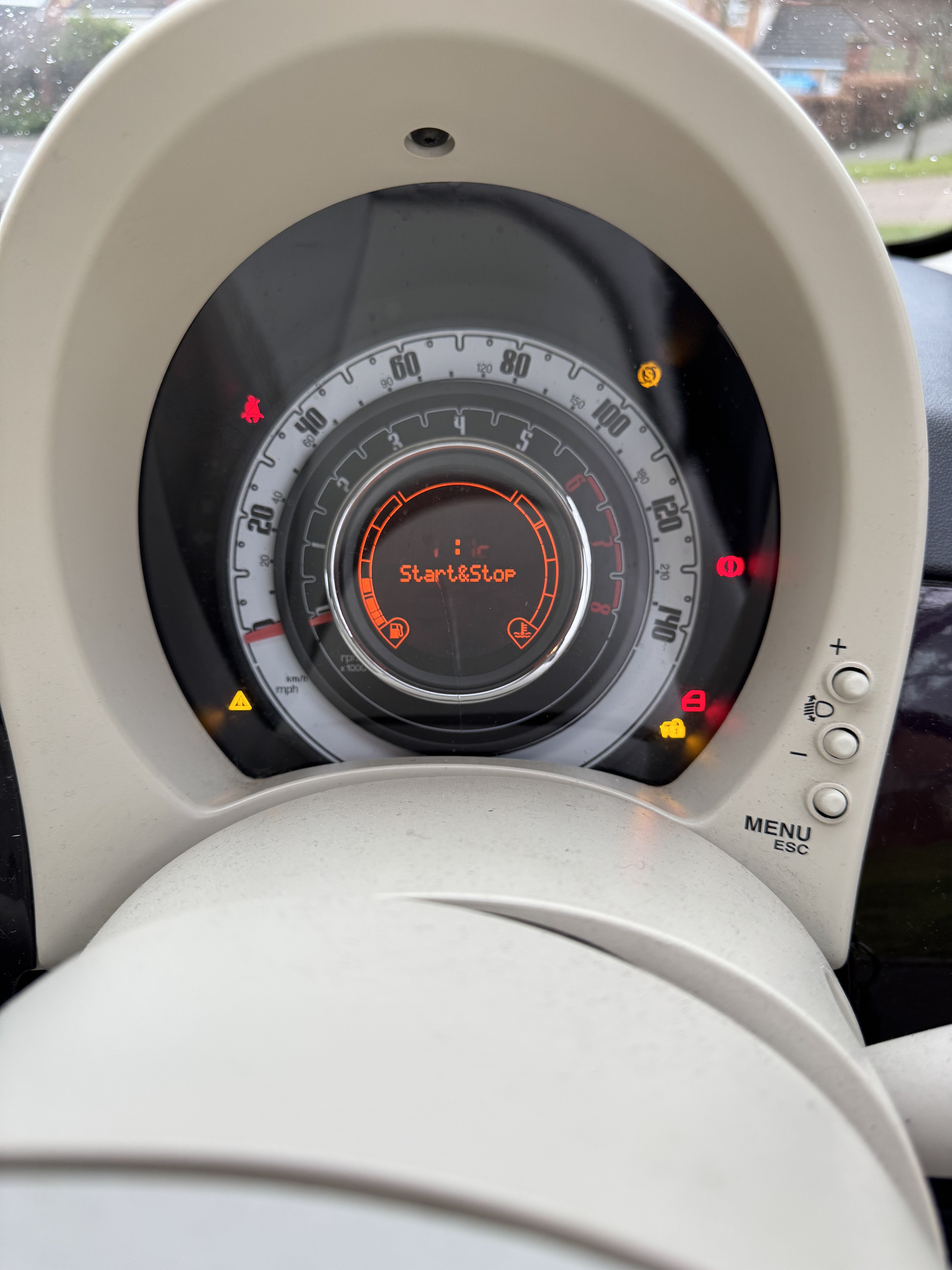

Hi all, this is doing my head in.
I've tried everything listed above and the indicator dance thing didn't seem to do anything. I'm in Glasgow to answer one of the questions.
When i turn the key to MAR (or ACC as i know it on other cars) the wee immobilisor light is on (the padlock with the car) - i've attached photos of the sequence.. Also a video,
Seems there has been another post this year as well however this one seems to have the car running, which is bizarre if it's stating the fuel is cut off?
I've swapped relays around, changed the battery, checked the cabled in the tailgate but still lost. Thought i'd update this to get the hive mind thinking before i have it recovered to a garage.

Please can you list exactly what you have done?
as that will be easier than us responding with guess work.
also have you always had to dip the clutch to start yours?
As i like simple things, i wonder if in its simplest form the key is not communicating. Presumably the door opens with the remote fob? It could be the key needs to be 'resynched' to the car (it may not be the original key). It could be the reading ring as problems reading the key....or next step it could be that there is an electrical fault/issue or the ECU is not working properly...
For me - if you can list exactly what steps you have tried so we can discount issues, that would be very helpful.
Hold the phone ladies and gents. I'll apologise for this.
Someone mentioned the earth strap but i was clearly looking at the wrong thing. I brushed past it with my arm and it just disintegrated. I used a jump lead tto connect the battery to the block and bosh! ut's up and running.
Apologies for missing this at the start, guys - thanks for everyone who replied and didn't judge! I can build you a data centre but apparently basic car mechanical / electrical functions are beyond me!
