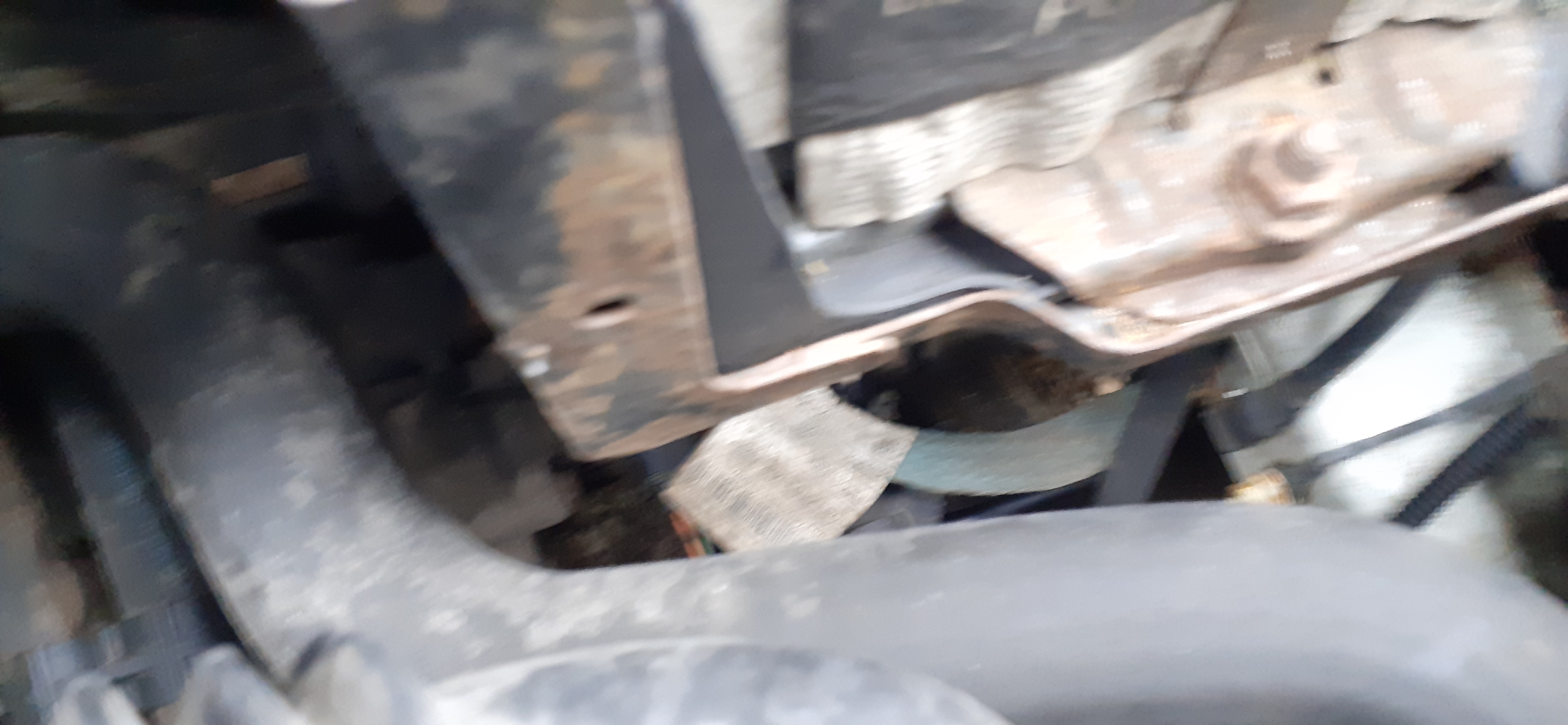

I'm also having a similar problem, not starting and flashing fuel cut off and abs unavailable on screen. I'm the worst with cars but have checked what I think is the earth strap and it seems to be all in one piece and secure though it is a thick green strap with a label on it not a thinner plastic wrapped one that it seems others have (bad photo attatched)
I've only had all my breaks done last week and it cost more than I could afford so I'm dreading it being a big fix or the end of my little 500
If it's green it means it's oxidized. Might cause too high resistance.

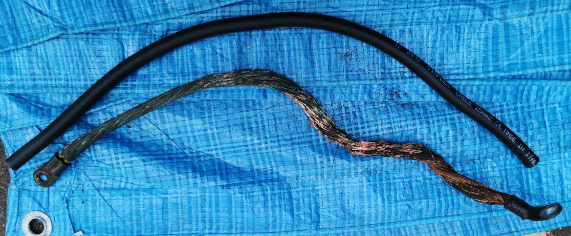

I personally am replacing those braided straps with a good quality 100% copper welding wire adding copper connectors and heatshrink on the connection. It costs like 6 - 8 EUR in total. You only need a solid crimping tool, as the cable should be 25 sq mm. Probably there are some finished products available on eBay or amazon.
However that might not be the only problem, but definitely is a place to start. What you see is only the middle part of the strap, you can't see its endings and how bad it look on the body and engine / gearbox ends.
Top photo is how it looked on the 'better' of the two non-FIAT cars, the worse one had so much corrosion that it had swallen like 50 - 60% in diameter :(
I've only had all my breaks done last week and it cost more than I could afford so I'm dreading it being a big fix or the end of my little 500View attachment 461113

I'll put money on it being the earth strap. Mine was a tenner for the cable and i fitted it myself. I did however snap 2 bolts. One on the battery ratchet strap and another on the bold securing the battery tray to the chassis. Tomorrows job is to drill them out and replace and put it all back together.
It is a / can be a DIY job with nothing more than a 10mm ring spanner, a 10mm socket and a 13mm socket but you need to remove the battery, the tray and temporarily move the clutch slave cylinder out of the way. Fidgety job but will save you maybe an hour or 2 in labour and call out charges.
